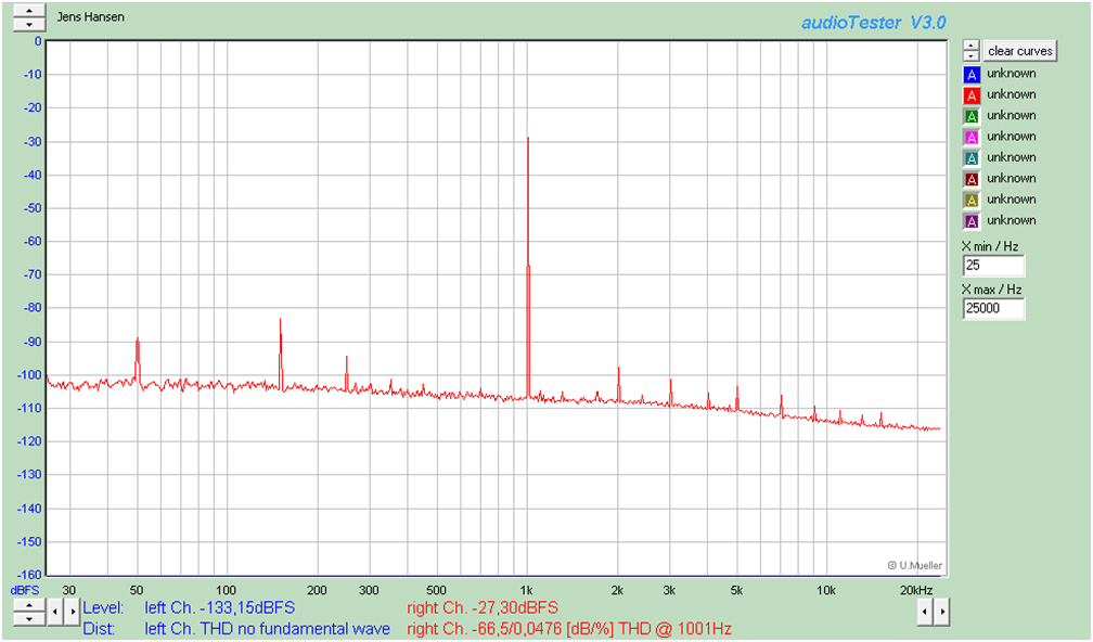

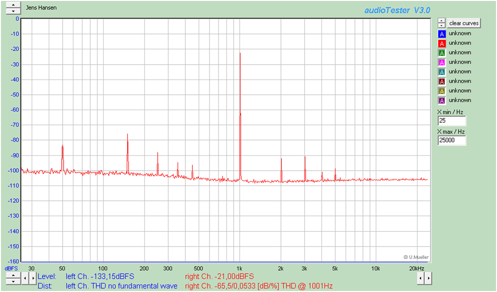

A couple of weeks ago staccatiss asked if it would be possible to get a balanced output with same low THD for both phases.
http://www.diyaudio.com/forums/equi...n-audio-range-oscillator-259.html#post3479608
I have now measured the outputs from both op-amp outputs, one at a time. IC1 is the one where the gain adjustment is done and IC2 is the one normally providing the output.
Using the output of IC1 gives a higher noise level and a higher distortion level. The distortion on the normal output is just below -150 dB. On the other output it is around 6 dB worse.
This is not surprising, since IC2 gives a low pass filter function, reducing the noise as well as the distortion.
For some reason there is much more 50 Hz hum in these measurements than in the previous one. But I still haven't built it into a proper metal box.
So it does not seem to be possible to get the same performance for a balanced output in this simple way. But it is still a decent performance. Perhaps lower distortion and noise would be possible with an additional buffer, e.g. with an AD797 or an LME49990? Or perhaps a stage like the output stage, thereby getting a band-pass filter for the inverted output as well?

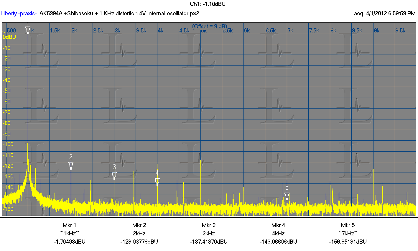

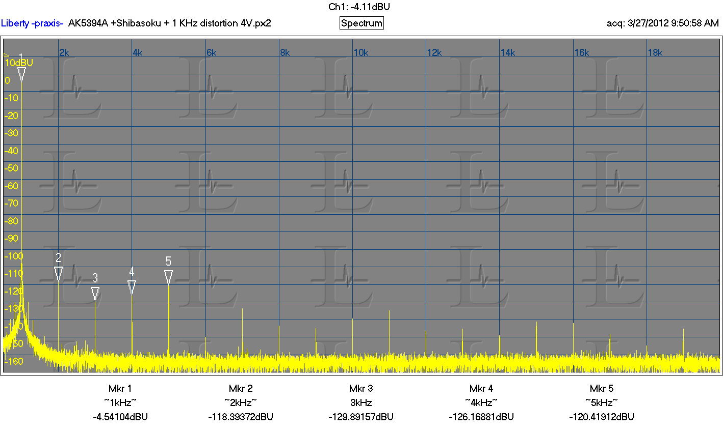

There are tons of disputes on what makes for a good clock. It can be reduced to some specific performance specs.
1) low phase noise/jitter.
2) Good isolation from the load.
Things like absolute frequency accuracy are not important. 5 PPM is good for compatibility but closer tolerance will have no benefits.
Most clock implementations have poor isolation from power supplies and loading. And your typical gate oscillator (crystal, two caps a resistor and an inverter) will have pretty high phase noise. Getting jitter/phase noise low in the 100 Hz to 20 KHz is important. Deterministic jitter is bad (repeating patterns). The best clock in the universe can be rendered useless with a bad layout or implementation on the DAC chip.
Attached shows the difference in noise floor between the onboard gate oscillator clock and an external Ovenaire OXCO with the AKD5394a

There is distortion there but it is below the noise floor of the oscillator.
This is why it may seem like there is more distortion with other oscillators because the noise floor is lower. It just a masking.

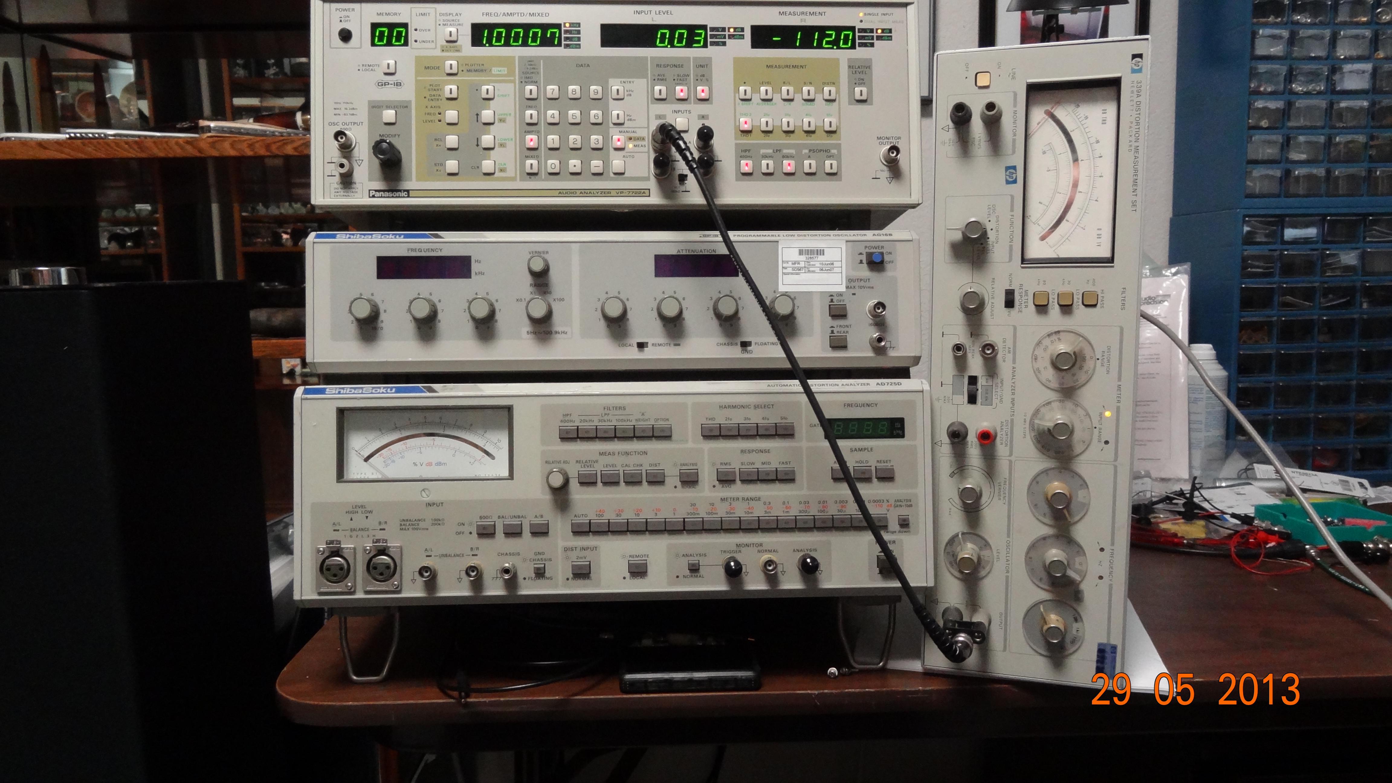

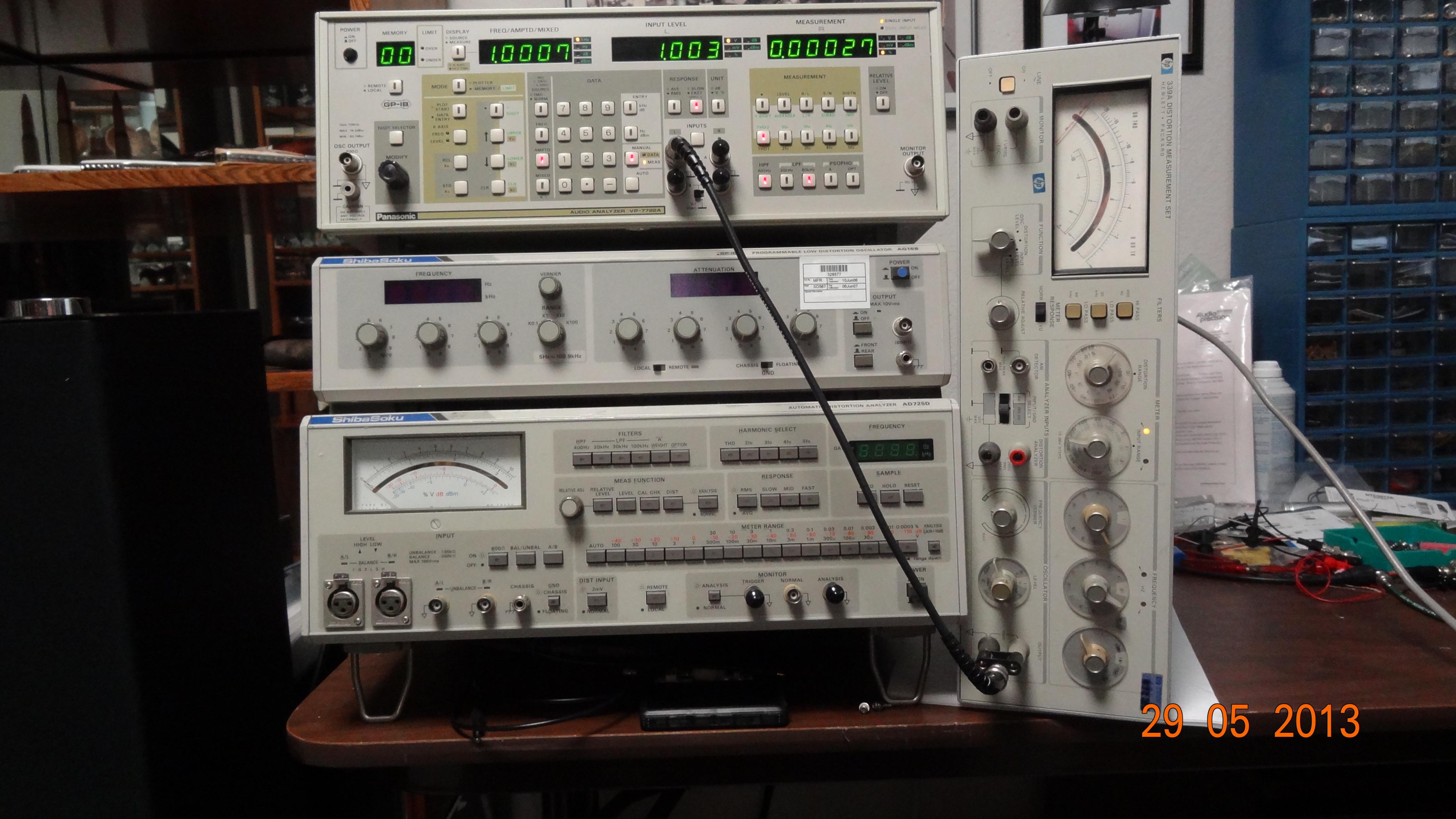

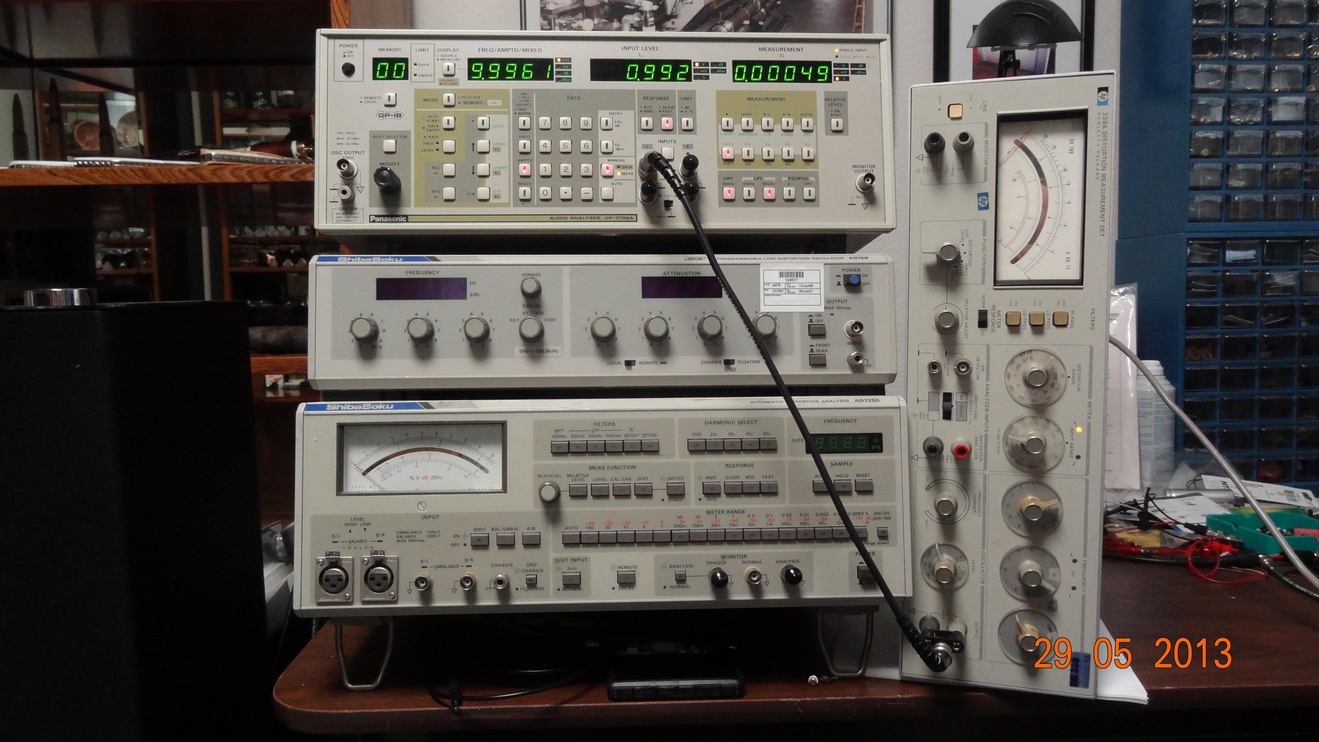

Some may wonder - its been awhile - to recall just what the oscillator section of the unmodified/stock HP-339A does - THD-wise:
This is a stock unit. 10Khz and 1Khz. It's pretty good and better than the stock 339A analyzer section says it is.
Just add another zero (0) to those numbers after mods.
Thx-RNMarsh
