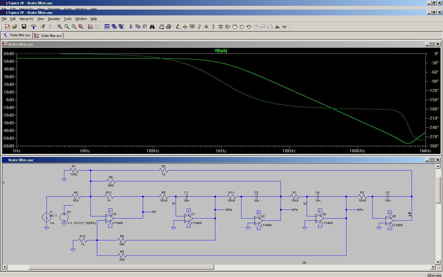

Can you post your spice file for this?
What am I doing wrong here?
Doesn't matter whether I use a current source or voltage source this is what I get.
I dont see the V-
You're shorting the inverting inputs of U1 and U4 with the "C" label.
Samuel
Thanks Samuel.
I used a file from a 2nd order circuit and modified it. Didn't see the labels.
Much better now.
