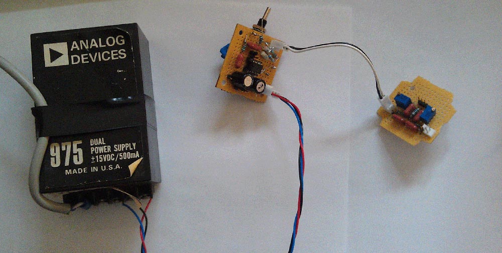

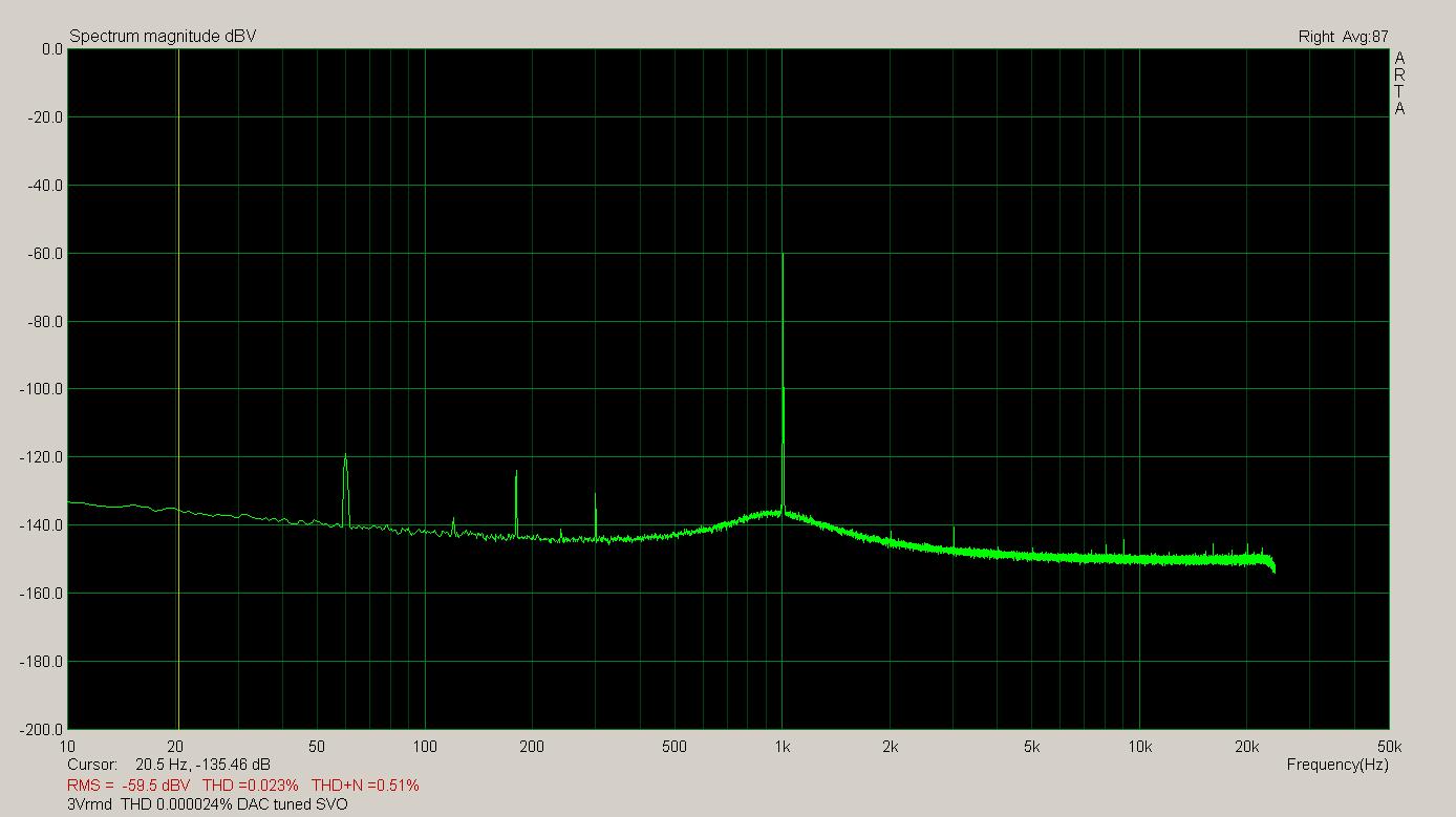

I'm getting close here Rick.
This is under the most non ideal conditions.
Crappy power supply, Boards sitting on my desk in open air no shielding. Board to board connecting wires far too long etc.
3Vrms @ 1Khz. SVO tuned with parallel Mdacs.
ARTA shows THD at 0.000024%
TT attenuation is 0.8dB for 2nd and 0.5db for all else.

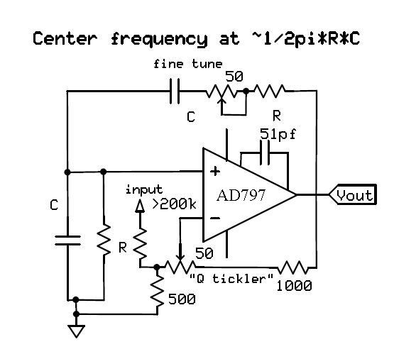

Repeated my measurements and here's the schematic (Ed the super-regen is sort of a joke for those that have tuned a tickler to the edge of oscillation).
Dave, the noise floor is around -150dB as expected when I use no gain. Adobe Audition uses 2V rms as 0dB and the oscillator is running at 4.8V rms.
No gain in path, ref level is 2Vrms = 0dB, ocillator output is +7.6dB over this reference.
Readings are with passive twin-tee notch in path.
Fundamental (notched) 3960.205 -72.824836731
Second harmonic 7919.677 -130.707321167 corrected -129.3
Third harmonic 10880.859 -151.646469116 (noise)
Fourth harmonic 15840.087 -134.771347046 corrected ~-140
Fifth harmonic 19880.126 -152.193740845 (noise)

Dick,
I know Scott is confused but you may be also.
Sorry Ed I'm not the least bit confused. I understand everything I am doing and why it does or does not work. If you can't keep up don't text and drive.
BTW - The caps I used were some brown ones out of the bin at work I think MPP, I did use a few ULT .01% resistors but also some from an eBay kit of lots of values. The board is a recycled rat-shack phenolic one. Thirds are almost at CLT level not bad.

I'm good with -150dB.
Scott can you take another one of these and tune it to the 2nd on the output of the TT.
With bit less tickling it might pull up where the TT attenuated. Several tuned to the individual harmonics could give a nice flat response to measure by.
You could call it a harmonic tickler equalizer.

If I understand it then you have .000015% distortion. (Or did I double correct your correction?) Of course with a passive output filter you could halve this. Better passives might improve that a bit.
So what can you do with $50 worth of parts?
BTW your schematic is missing a dot.
Would you post the notch filter you are using and how it is loaded.

Standard twin-tee with trims that Jeff Smith and I published (you have to walk the trims to deep null). All frequency determining components are .033uF MPP and 1.26K Tiwanese 1%.
Like the picture? :D
Obviously there would be a benefit to a nice PC board in shielded enclosure, the line and light buzz does get through this setup. $50 you're killing me, $20 tops (less PS).

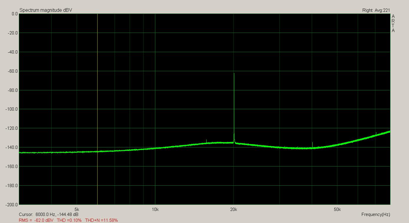

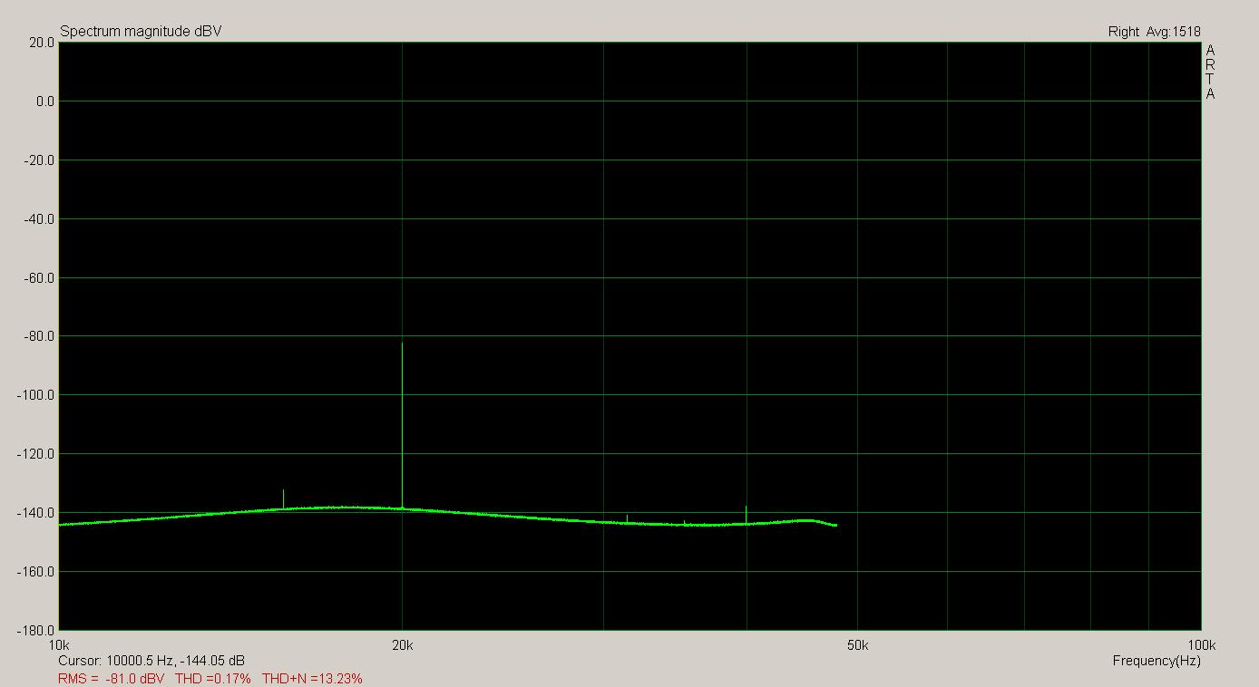

After much work today I have this.
