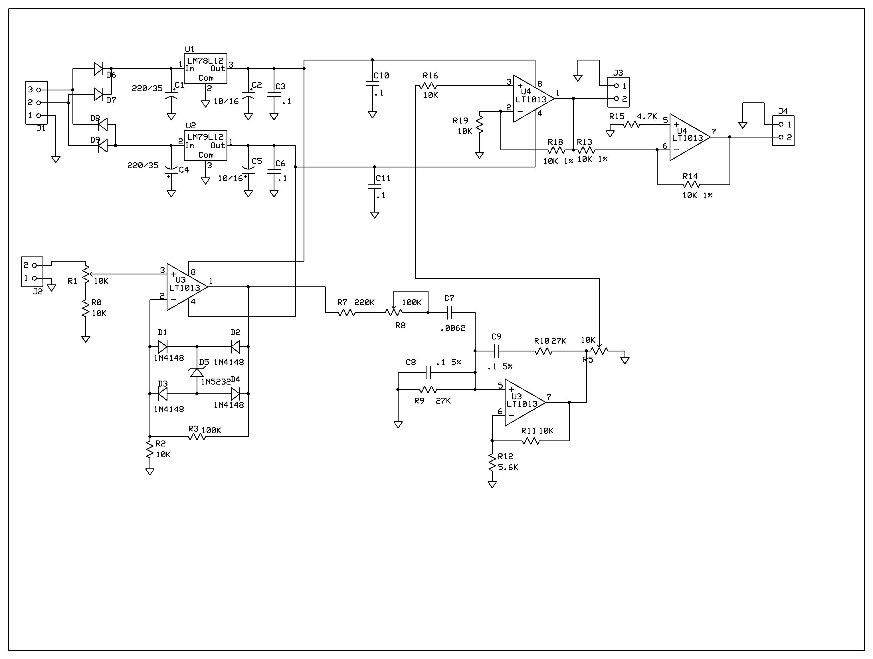

Dick,
I know Scott is confused but you may be also.
A Wein bridge is a combination of two resistors and two capacitors that when fed across the bridge have a strong resonance at the output.
This may be combined with an amplifier to form an oscillator. To get minimum distortion the gain of the amplifier has to exactly match the loss in the Wein bridge. The usual method to do that is to monitor the output voltage and make gain changes based on the level. If the level is rising without control the amplifier will clip. If the gain is too low the oscillations will stop.
Now when the gain is too low the circuit will resonate. Think of a tuning fork, it is a resonator as are crystals and bells. When you strike a bell it rings at it's resonant frequency and with decreasing amplitude. Now if you strike the bell every few seconds it will ring but the level goes up at each strike and drops until the next strike.
What we do with a Wein Resonator is strike it at the resonant frequency. This is different than a filter. (Subtle but important).
Now you can follow the resonator with a filter to clean up the distortion from using real world parts. This can be done simply with a Wein bridge driven from the output. To reduce loading effects the grounded R may be tapped to give a lower level and lower impedance source.
Now if you use state of the art parts such as bulk metal resistors and rel caps (I think you have heard if them. 🙂 ) you can get very low distortion of say -130 db.
You also asked about predistortion this is easily done by using two identical op amps in series with each one having half the gain of the system. The second harmonic generated by the first amp will be canceled by the second harmonic in the second stage.
Now to get to -140 db or better you will also have to consider issues such as the PC material. Glass epoxy due to the woven glass has impedence bumps even along the traces. So a more uniform modern dielectric based PC material should be used. A silver played copper enclosure is possibly even useful at these levels.
Now another issue raised by Nelson P is the open loop gain of the op amps. As the perfect op amp has a smooth HF roll off of 6 db per octave that results from optimum damping. As there is some stray inductance and capacitance there may be a bump or slouch at the start if the roll off. By increasing the gain and reducing the signal we can to a certain extent tweak damping.
Of course another issue is what power supply drives the circuit. Now that is a rather complicated issue and more than I want to get into at the moment.

Ed,
Not to be picky, but a Wein Bridge is a very low-Q passive arrangement. To the best of my knowledge, there is no such thing as a Wein Resonator, unless you are referring to a Wein Bridge in an active, oscillator-like arrangement.
A conventional Wein Bridge has a broadly-based minimum loss of 1/3 at its center frequency. A typical Wein Bridge oscillator is built by taking an X3 non-inverting gain stage and connecting the Wein Bridge as a positive-feedback network around it. At the center frequency the non-inverting loop gain is unity and it oscillates.
The non-inverting gain of 3 amplifier is usually built from an op amp, so you end up having frequency-dependent positive feedback through the Wein Bridge and flat negative feedback through a resistive network to the inverting input of the op amp. The AGC is usually applied to control the amount of flat negative feedback. The passive Wein Bridge is a low-Q device that obtains a high-Q behavior by being embedded in a circuit with positive feedback.
A high-Q bandpass filter can be made from the Wein Bridge oscillator arrangement by having the amount of negative feedback be slightly stronger than the amount needed for osillation, and by feeding the signal input into the inverting input of the op amp.
Bob
Bob,
When you have what would be an oscillator without a level detector and gain adjust set just below oscillation you have a device that rings.
Scott refers to it as regeneration, but technically it is a resonator.
If you treat it as a black box and compare it to a tuning driven tuning fork, you would be hard pressed to see any difference.

Ok,
I can show you the resonator version at least.
Here is the way I did it for my AC power line article.
All you need is the Wein bridge section. You won't need the power line clipper or the output buffers. Just drive it with a very stable oscillator.
ES

Of course. No disagreement there. I just thought your explanation was potentially misleading. As I pointed out, a Wein Bridge in and of itself is not a resonator and is fundamentally of low Q. Add some amplification and you get something that has significant Q and can be called a resonator, if you like.
BTW, I'm not sure it is fully correct to call any circuit, active or passive, that rings, a resonator. Obviously passive things like L-C circuits, crystals and tuning forks are resonators. It is less clear to me that an R-C circuit that is actively made to ring is a resonator. Is a poorly designed negative feedback power amplifier that rings a resonator? I'm not disagreeing with you, just scratching my head over semantics. Maybe I should look up resonator on Wikipedia or something.
