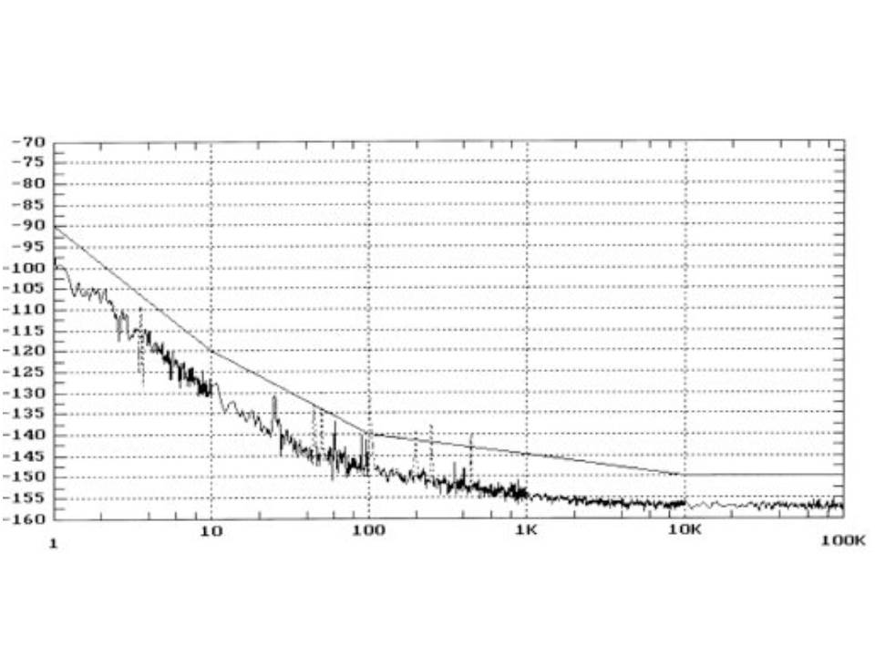

point: Make the noise of the osc lower.... especially at low freqs.
The point is that, whatever you do, the noise will increase with decreasing frequency. There are some laws that are impossible to avoid.
I have attached measurements of a low noise oscillator.
