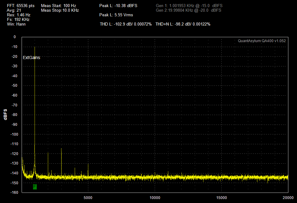

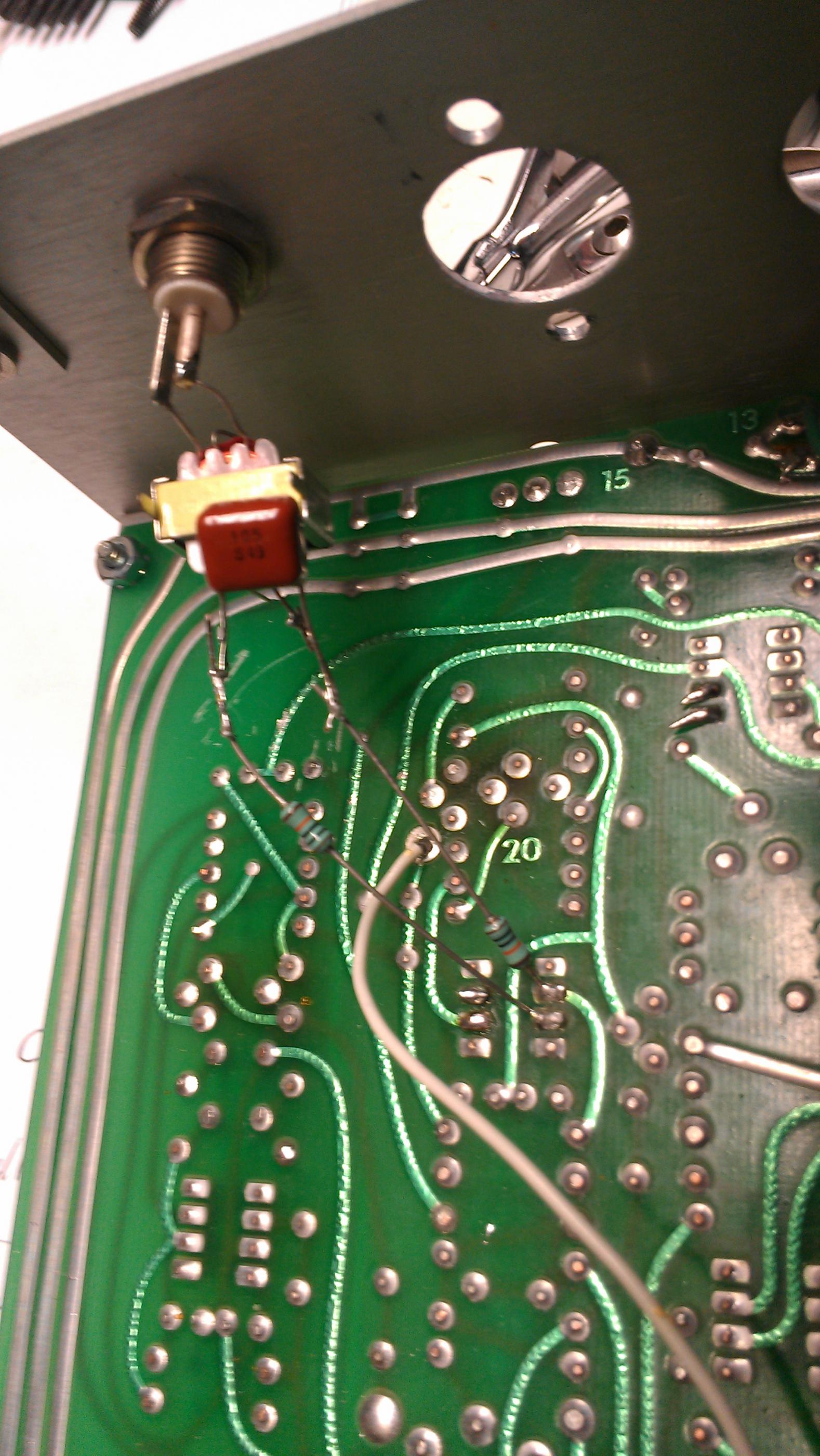

First, how I added injection locking to the KH4400. Its a junk box Radio Shack transformer (1:1) and two 100K resistors and a cap. I used a transformer to get ground isolation. It did not really work. I need to find a shielded transformer.
Then the QA400 during measurements runs the generator in bursts. This does not work well with injection locking.
Fortunately the Boonton 1120 can be set very precisely (6 digits) and is locked to a TXCO. (I get value from the toy. . . )

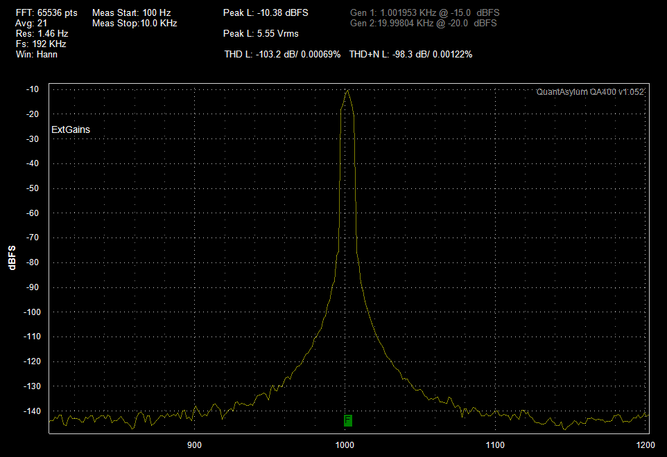

I locked the KH4400 to the Boonton set to the frequency of the QA400 internal generator. You can see how the skirts narrow when the generator is locked. You will also see the third harmonic increase when locked.

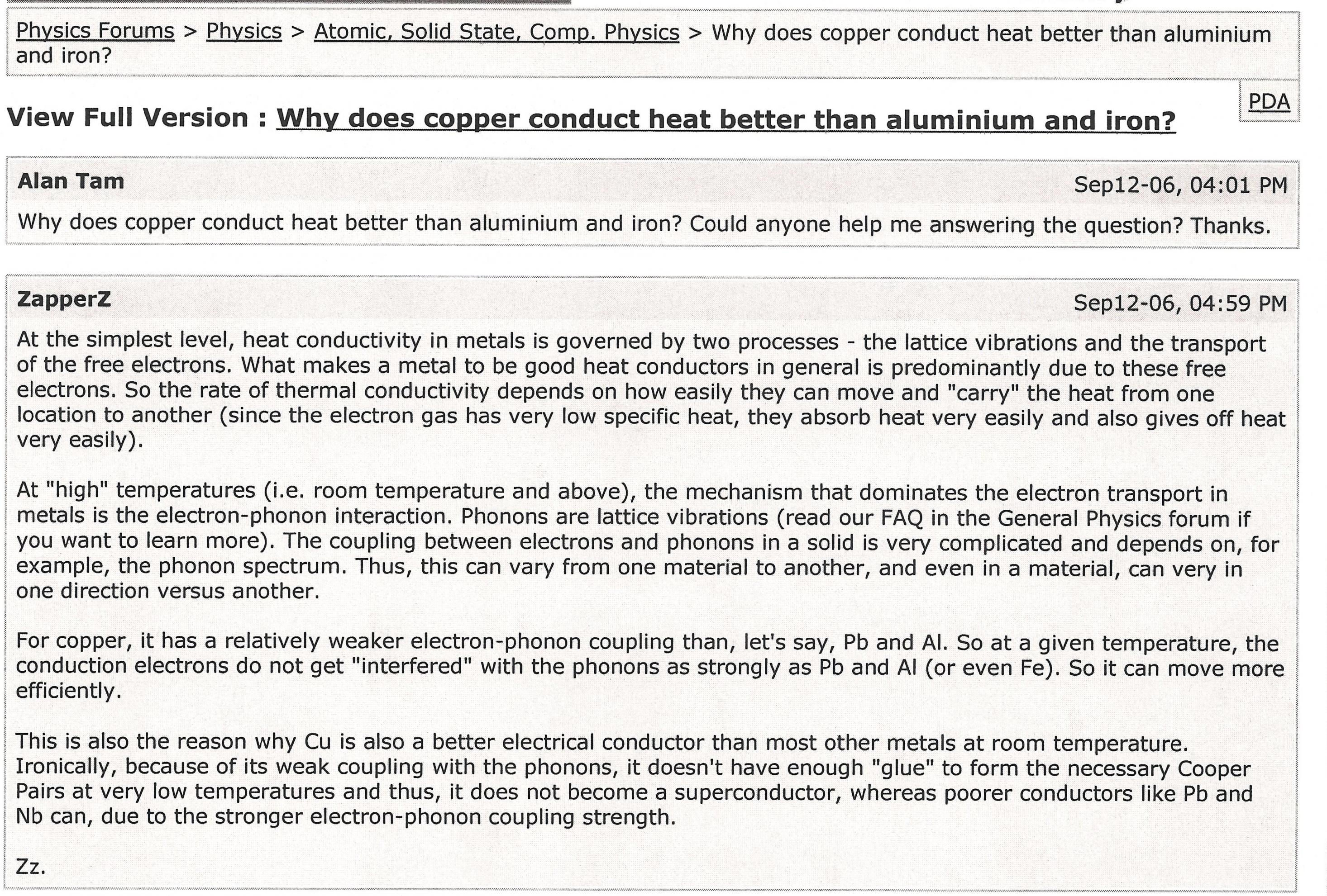

Also I have to apologize a little on the heatsink stuff. I have been fighting this for years. The JEDEC specs for ThetaJA are very pessimistic because the don't include things that would apper in a normal application like conduction out the leads. Parts are to be measured soldered to small dots on tiny boards.
Does it make sense to thermally isolate a heatsink and mount it upside down to defeat natural convection to prove the point that radiation can be up to 20% of the loss? (number from IBM) Bolted to the chassis and free and clear to encourage natural convection we are down to a few percent at best difference. BTW turning off radiation all the way in that program will give a wrong answer anyway, raw aluminum extrusion is .2-.3 emissivity.
FYI -- View attachment 342057
So there you are. Clear now? Good.

Ever try two transformers in series? (Load R between them.)
ES
Good idea. I'll need to check the junk box. I can ground the intermediate connections to reduce the noise coupling.
