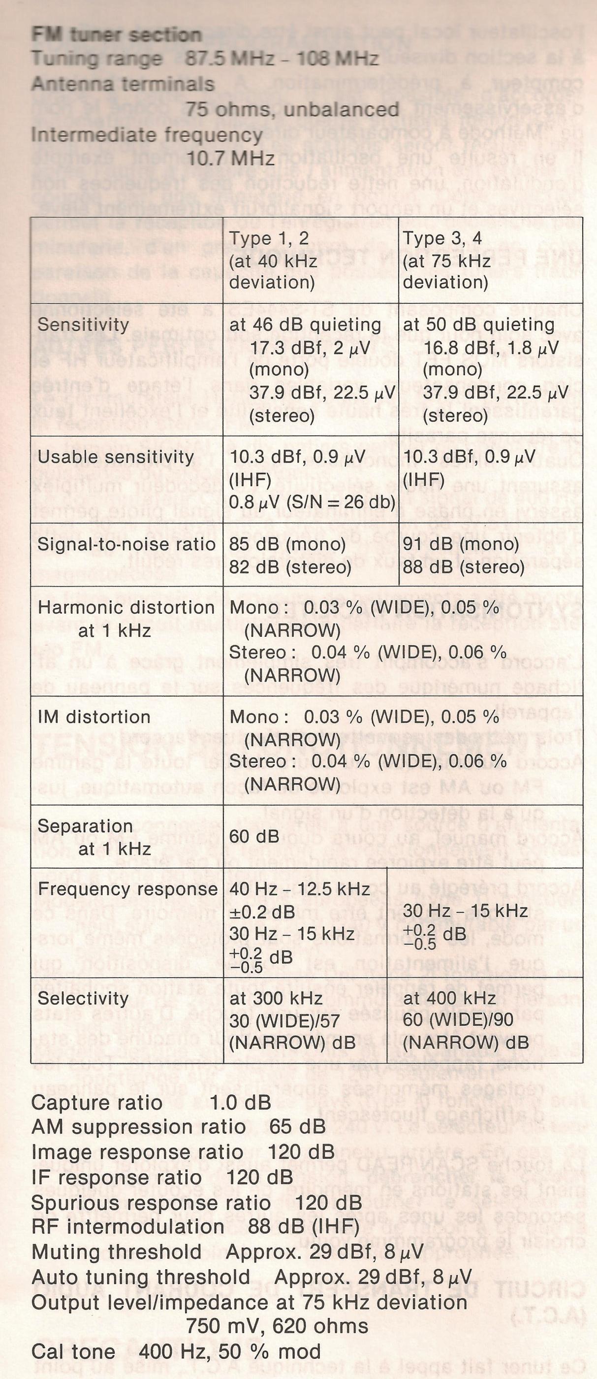

low distortion sources are always helpful. For inspiration... what did it take to design and then measure this Sony product..... A rare FM super tuner (called the Direct Comparator model) from the same period as many audio oscillators we now use; Check out the thd, noise etc. and those 120dB numbers all over the place:
And, this was 25-30 years ago ! Are we as good today? Who were these unsung hero's? Do we have some hero's here for our most difficult projects?

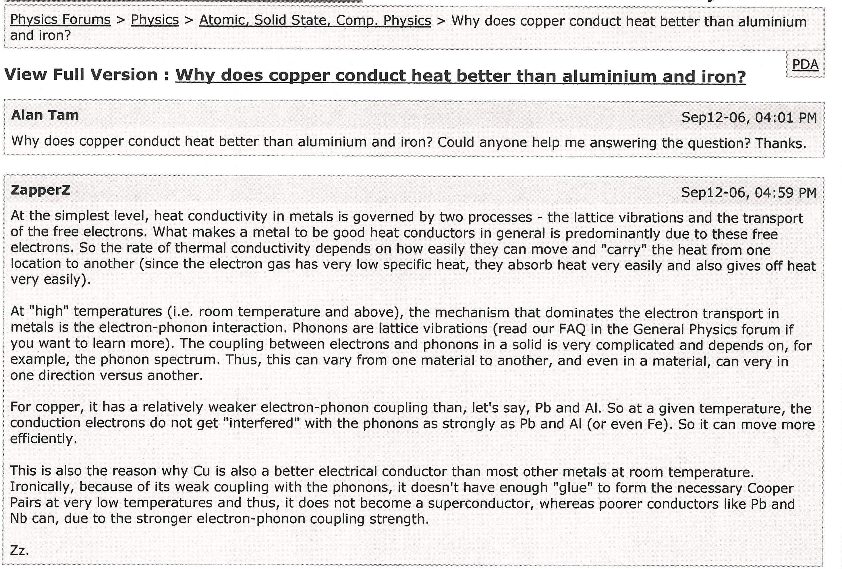

By coincidence one of the guys at work was experimenting with heat sinks. He found a solid block of polished copper 3x3x.5 in. worked better than a carefully machined, anodized, finned aluminum heat sink. I actually can't figure that one without seeing what he is actually doing.

Looks as if Silicon Labs has some more work to do on the Si4770 to do better.
Found this on the net, interesting!!
"From a 1983 US ES catalog:
"[...] Quartz synthesis tuners were inherently more noisy than the best analog models. So Sony produced one of the most highly acclaimed tuner circuits ever invented. The Direct Comparator.
The Direct Comparator improves audible reception because it functions above the audible frequency range. By making the required PLL comparison directly at higher frequency, the D.C. in tuners like the ST-S555ES cuts through the blanket of noise so prominent in FM reception. Result? A spectacular S/N ratio of 92dB in mono and 86dB in stereo."
Wouldn't air flow better over the polished copper?

FYI -- View attachment 342057

Dick, the comparison was aluminum with fins, anodization, and all the other good stuff. the copper was just a lump. I keep pointing out there is nothing to learn unless ALL the factors are covered.
yes. You are 100% correct. That physics explaination was about 2 lumps of metal.
I would suspect from description that copper is sooo much more efficient that much larger surface radiating area of alum with fins et al is needed to equal copper with same bulk (volume).
If cost is an issue - use alum. If space is at a premium ... maybe copper is better (eg Beryllium copper ?).
