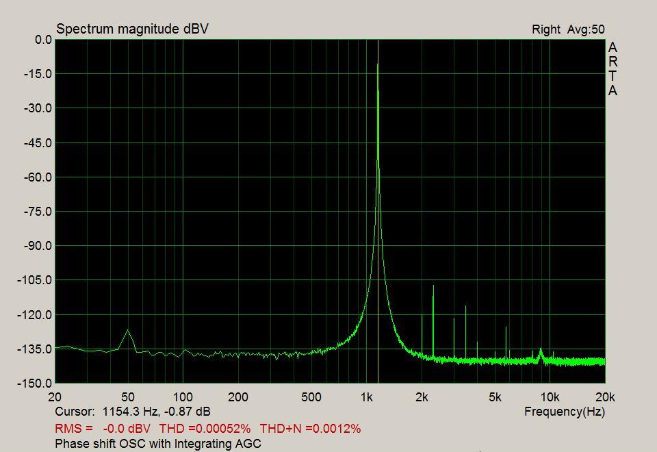

I was intrigued by the phase shift oscillator at the very start of this thread when I first saw it in 2003. I built it and found it worked like everybody here said, OK distortion, no level stability, phase noise, etc. except in my case the distortion below 200Hz was horrible. Thanks to Brian 'Pingrs' for his PCB layout which I cribbed and modified http://www.diyaudio.com/forums/equi...ion-audio-range-oscillator-2.html#post2886307 .
The other week I built a 2nd board with an integrating AGC a la Bob Cordell, etc. This solves the level flatness problem and it settles nicely in few seconds but some of the LF distortion issue remains. The HF range I added will run upto 175KHz but suffers from too much loss preventing me from reducing the LDR control range, which would lower the distortion, I might have to abandon that. It's all built with cheap generic parts, NE5532's on the oscillator, TL072's in the AGC, prabably lousy layout and grounding, so Lots of work to do - it's a good learning exercise.
I know that ultimately this phase shift osc is a dead duck as far as real performance is concerned and I'll eventually replace it with an SVF which wouldn't be any more complex.
Like RNM I think getting the THD+N is important and this oscillator doesn't cut it, it always shows a wide noise skirt.
Well that's my oscillator journey so far. I'd just like to thank all the contributors to this thread - it's been quite the most fascinating thread I've followed on DIYAudio. Many thanks to you all.

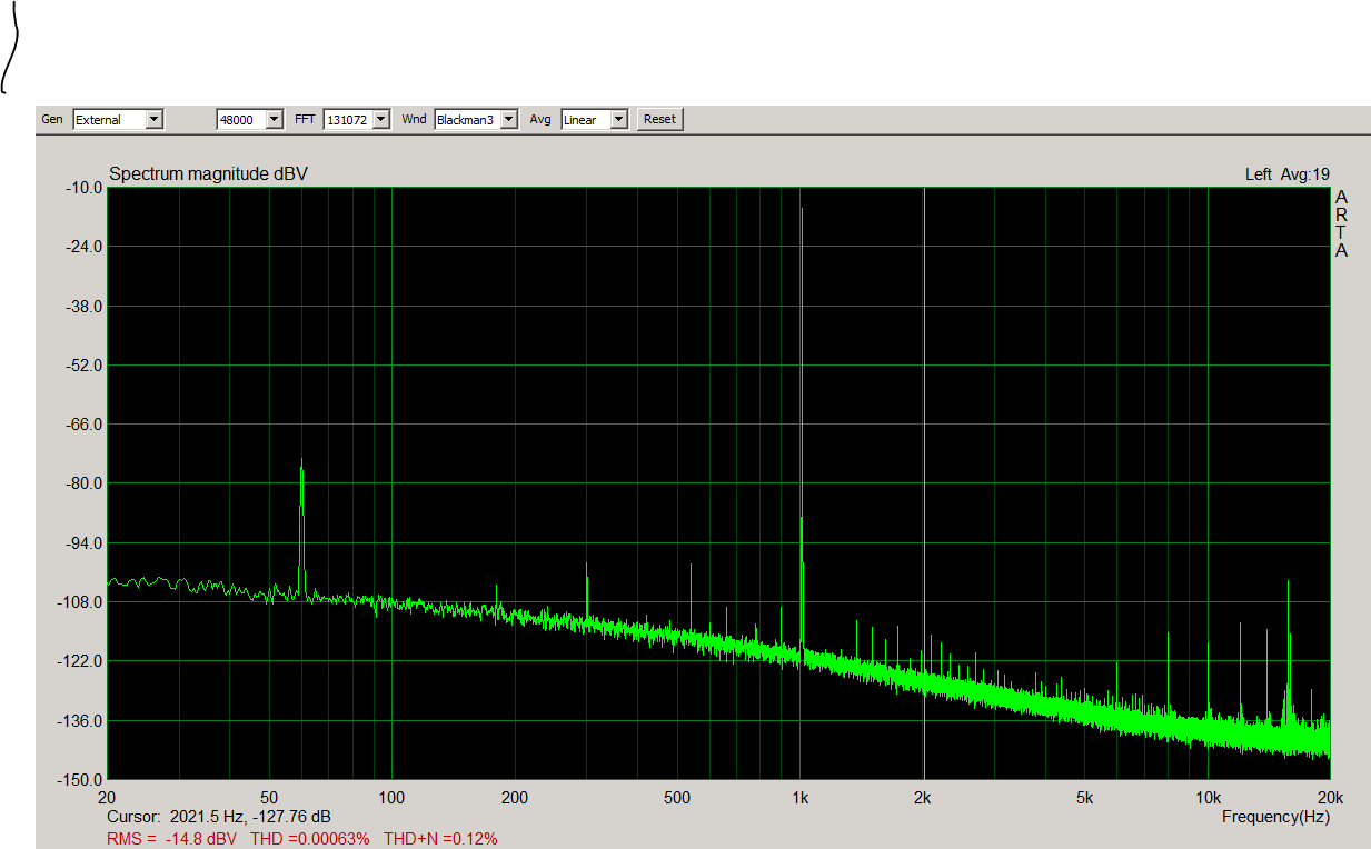

Here's how it's doing so far, Asus Xonar DX PCI-E card (CS5361 ADC) the noise spurs at exactly 1,2,3..KHz are from the PC.
I'm pretty sure the source of noise in mine is poor interconnects, no case, and the lab supply. I'm not sure, but I might make it manually variable using parts (the variable dual gang capacitor and range setting resistor network) from an old HP 200x wave generator that I have. Could use the case as well, build a low noise dual power supply, and it'll be almost too good for testing tube amps.

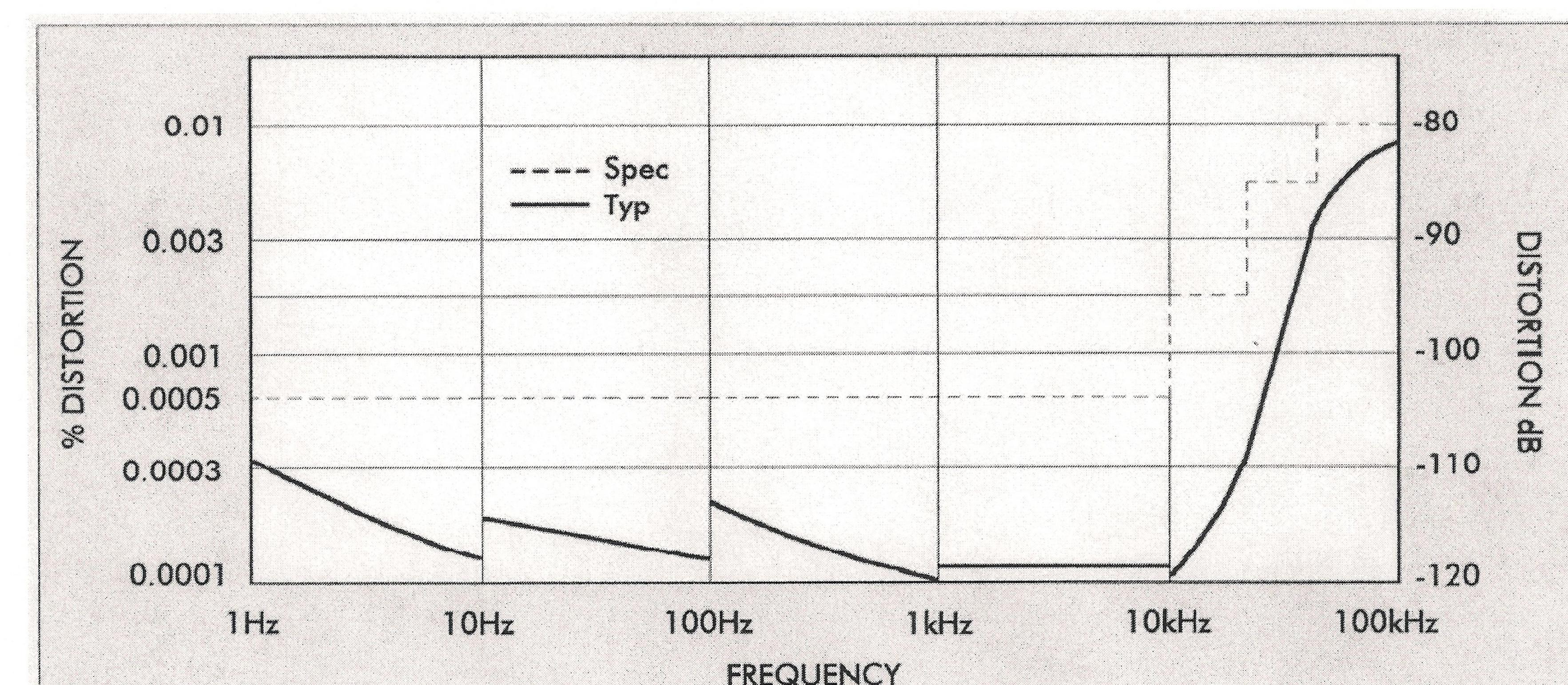

here is the spec for the KH-4402B attached. As you can see it is already very low and upgrading it isnt too hard. In the midrange it is already below -120dB, stock.
[BTW - KH is calling their newest model 4402B as beingfrom below .0005% to below .0002%..... did they just tighten up the spec to be less conservative or did they do some updates/upgrades like I am have done?
