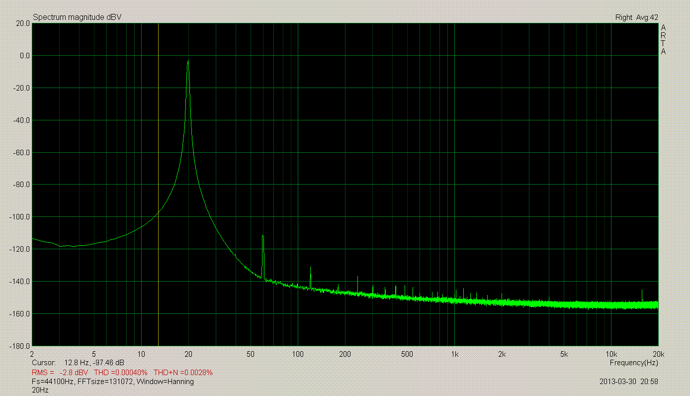

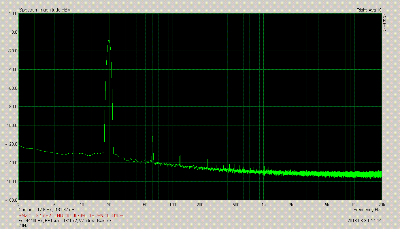

SVO @ 20Hz
This is the lamp based mult. SVO at 20Hz running just under 1Vrms no notch just the oscillator.
No AGC here just two 9V batteries and a pot to set the Vc on the multiplier.
This look okay to me.
Bob C. can you have a look and see if there any sign of thermal modulation?
That's not a hunk of third H there just power supply hum.
