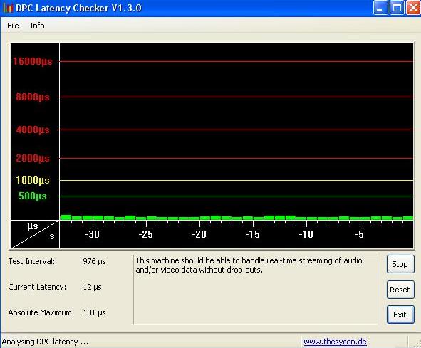

The jumping noise floor is dropped samples I think It has been a problem with most of the pieces I have tried, even the RME which has some pretty exotic stuff to manage many channels and DMA. I think its more of a system and background software issue. Pyrimix uses a special pre-boot trick to reserve 2 of 4 cores just for it to deal with this kind of stuff. Thesycon has a test software that checks for issues with lost interrupts DPC Latency Checker .

It would be nice to have something that tell you what is causing the latency.
DPC reports the numbers.
I would say 300 uS is a little high, you might have a slightly misbehaving driver.
What you are looking for with DPC latency is a driver that is taking more kernel time than it should. The best thing to do is to disable devices one-by-one in Device Manager and see when your periodic spikes go away. I would start with WiFi adapters (I have seen this behavior from an Intel and a Broadcom driver), USB devices, etc.
It's not likely to be your display driver if you have an AMD/ATi or Nvidia card, or your Intel chipset and SATA drivers if Intel, but anything else is suspect.
You might want to try LatencyMon instead of the Thesycon utility as it will give you info on which driver or process is causing the latency. Also, Thesycon's utility does not appear to work correctly under Windows 8 and reads high values constantly.

The latency shot up to as high as 14826. I think this is the problem.
No funky video drivers. I do have a few USB drivers installed but they are not active at the moment. That is the hardware is not connected. If I shut down much more in device manager I'll blue screen the OS.
Try that other utility I linked, it will let you know the service or driver causing the issue most likely.
If you have a Core i5/i7 machine you should be able to get below 100 uS consistently. Mine hovers around 33 uS but will go up to the 50 uS area if I move my mouse very fast, and that utility correctly identifies the usb driver as the source.
Chris719, thanks for linking to that latency tool.
My result from an old XP with Core2 Duo 3GHz while running ARTA and browsing diyA. Quite good I think.
