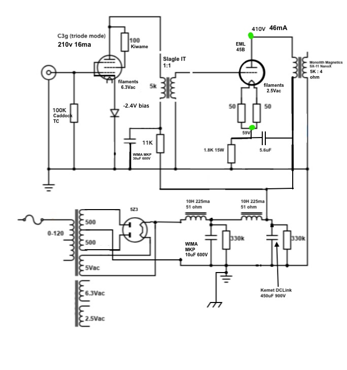

Soulmerchant is right: wrong 45B plate current values on schematics and nobody has seen it.
banpuku - the cathode R-values on you schematics are confusing. post 1: R-cathode 45B = 1K versus post 142: R-cathode 45B = 1.8K. Do it right.
Respect the 80 percent power limit dissipation of tubes. If you go near 100 percent they won't last long.

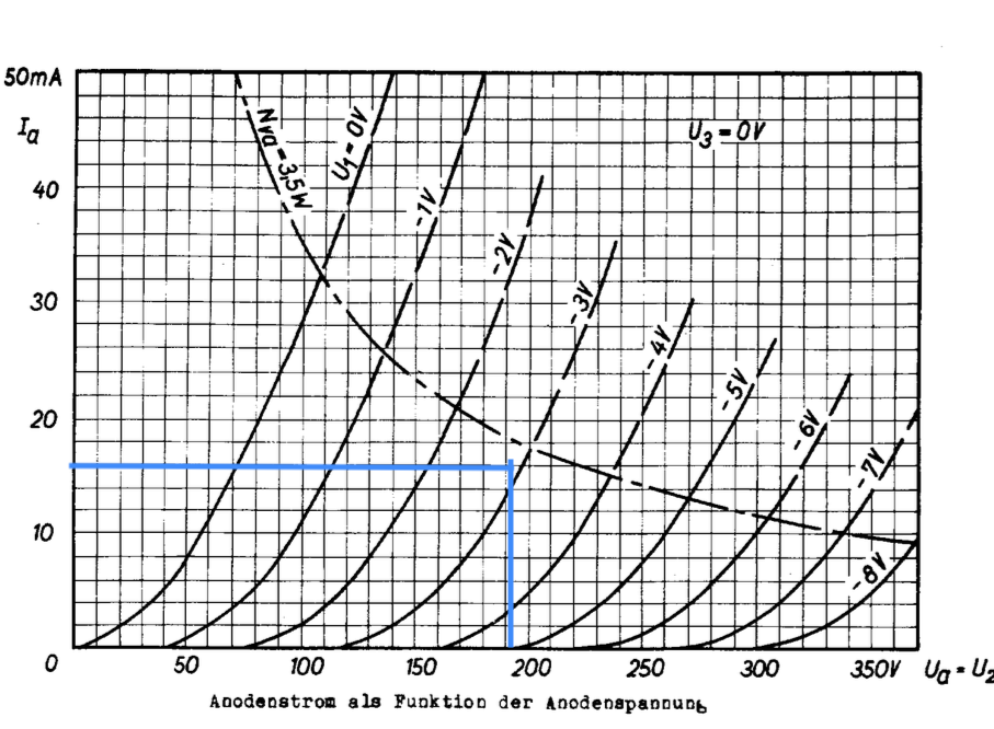

Post1: 45B _ 61V / 1K = 61mA x 349V = 21.29 Watt, limit is 22 Watt, _ tube C3g _ 16mA x 210V = 3.36 Watt, limit is 3.5 Watt
You want to replace C3g with a 1:8 silver input transformer + 801A driver. You are using a autoformer as volume control. Autoformer + 1:8 step-up to drive the 801A is a difficult task. 50AE may answer what is useful.
You want to use the 5K Slaggle interstage: the 801A has rp of 5K _ no match. You can use the 46 in triode as driver + a direct coupled input tube.

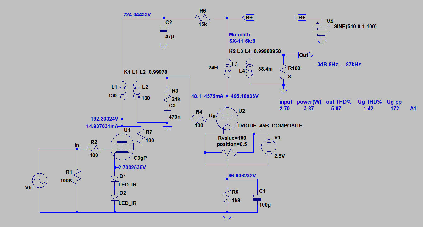

If I wasn’t big wrong in the simulation, this is the Emissionlab's recommended biasing for 45B at 5k load.
Emission Labs. Information about life time of electron tubes.
45B Recommended Single Ended operating points.
Bias Method: Auto Bias.
The 45B spice simulation is "as is", not verified with the original curves!
As you can see, even the IT loaded C3g is unable to drive this to maximum power.

The 45B in Post # 162.
495V - 87V = 408V
87V /1800 Ohms = 48mA
408V x 0.048A = 19.6 Watts
I know that the 45B is specified for 22 Watts.

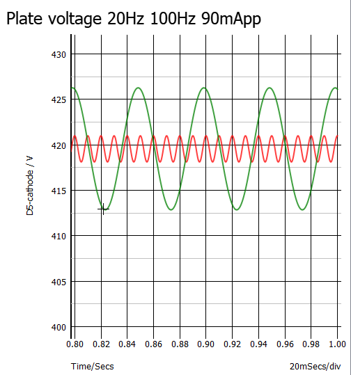

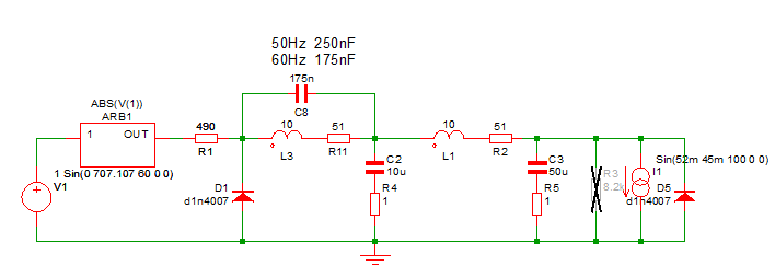

Very good, but you should include the supply as well. The impedance is quite high mostly from losses in Transformer and rectifier which I approximate with the 490R
Almost all of the variable current is supplied by the 50u cap, the choke has a very high impedance at audio frequencies. It delivers only the DC part. Even at 20Hz 80% come from the capacitor.
The varying anode voltage by 12Vpp will cause some more 3rd harmonic distortion.

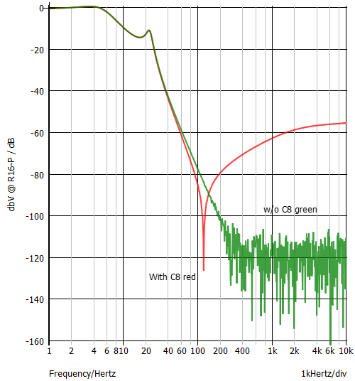

I modelled it this way. The additional cap improves the ripple about 20dB at little extra cost. It makes a notch at 100 or 120 Hz
In that #170 PS output impedance curve, bass phase changes roughly from -10º at 25Hz to -90º at 125Hz while our precious OT will furthermore add some LF phase shift. There's a point reproduction starts to loose realism, with or without the "snappiness" some are craving for. Add more poles for the loudspeakers and there you have it: a real to life reproduction system is just an illusion. Just be happy and enjoy the hobby.

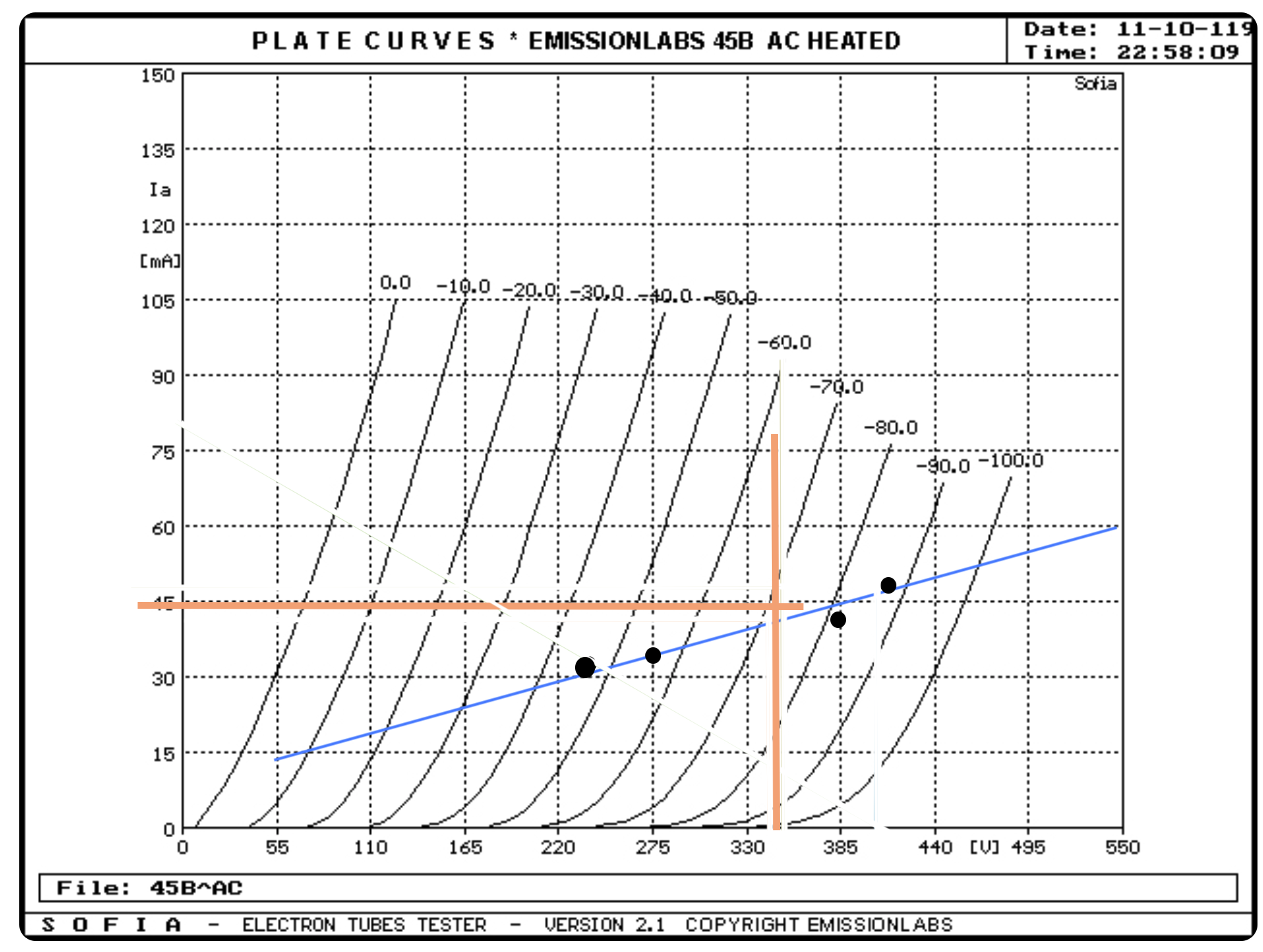

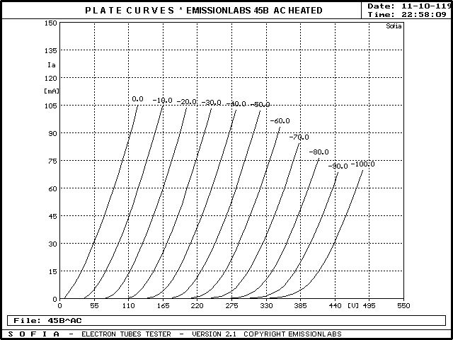

soulmerchant - your post 155 - plate curves for 45B, maybe i have an idea. You were looking at ca 333V plate and -60V grid: ca 75mA.
The 2 x 50r ballance resistors for filament are parallel, so act as one 25r. 25 x 0.033 = 0.85V + 59V = yes ca 60V. But if you look at 350V, -60V grid: EmL 45B plate curves should be ca 90mA. banpuku has only 33mA ! Power dissipation: 11.55 Watt ! This is extreme low. This has nothing to do with a weak psu, its the 45B tube. His tubes are far out of specs, if his numbers are real. This may be realy bad, because the tubes look like worn out. The datas from all 3 schematics show a hugh tube deterioration over time.
I have added the schematic from post 142. I marked 2 green points there.
banpuku - please measure the DC voltage at these 2 points again and give us the values for both tubes. On post 1 you have used a 1K cathode resistor. Since post 142 you have a 1.8K cathode resistor. Confirm this. No mA values. We want to check how much your 45B's are out of specs.
banpuku - on your thread - review dave slagle interstage transformer - from Oktober 19. 2019 in post 1 there is your 45B schematic: 410V on 45B plate, 66V on 1K catode resistor. 66 / 1K = 0.66mA, Filament ballance 25r x 0.066mA = 1.65V + 66V = 67.5V on cathode, a-k: 342.5V
Look at 344V plate and -66V grid curves: ca 66mA ! Power dissipation on 45B: 22.6 Watt - max specs are 22 Watt.
At that time your tubes were ca 100 percent specs.
Go to post 1 schematic of this thread: 410V plate, 61V on 1k cathode: 61 / 1K = 61mA, Filament ballance 25r x 0.061mA = 1.5V +61V = 62.5V cathode, a-k: 347.5V, plate curves at 347.5V and -61V grid curves: ca 90mA. Instead of ca 90mA you have 61mA ! Power dissipation: 21.2 Watt.
banpuku - if you would use a class A transistor amp 2 x 10 Watt with too low power for your loudspeakers - it would not hurt the amp. But if you do this with a small SE tube amp and power hungry loudspeakers, they will eat your tubes.

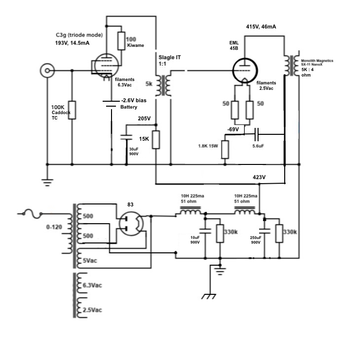

Hi team - hope all is well. I have made a few changes and would like to report the measurements and operating points.
Changes:
1. Installed a CDE 250uF cap at C2 position
2. changed the driver bias battery to 2.6V from 1.3V
3. changed the C3 dropping resistor to 15K from 10k
4. Re-installed the 83 rectifier in lieu of the 5Z3
5. changed the 100R C3g Anode resistor to a Riken 100R
B+ Measurements:
C2 = 423Vdc
C3 = 205Vdc
C3g driver
bias = 2.6Vdc
B+ at Anode: 193Vdc
calculated current = 423V-205V = 218V / 15k ohm = 14.5mA
dissipation = current * voltage = 193 * 14.5 = 2.8watts (80% of 3.2watt max)
45B
bias = 69Vdc
B+ at Anode: 415Vdc
Anode to bottom of 2x50R = 346Vdc
calculated current = 415V-346V = 69V / (15000+25) ohm = 46mA
dissipation = current * voltage = 415 * 46 = 19watts (86% of 22watt max)
The attached schematic and tube curves reflect the items above. Note: the EML 45B plate curves have 4 operating points (black dots) that represent operating points identified by EML. These are for reference only and as you can see, my operating point (intersection of the salmon colored lines) is nearly on the blue cathode load line along with these 4 operating points.
After letting the amps run for 4 hours, I listened for an hour. The immediate change in sound was the 3D depth improved significantly. Not sure what this is attributed to, but this change was clearly an improvement. More comments on listening as the system settles and he CDE caps break-in. Per Blitz, they take a week to settle down. More to come.
Comments welcomed!

banpuku - what is the value of the cathode resistor of 45B ? On schematic 1.8K, but your calculation is 1.5K. Your measurement is again confusing.
Measure this: look post 175 schematic with 2 green dots on 45B;
1. measure from ground to lower dot (bottom of 2 x 50r)
2. measure from ground to cathode (filament) of 45B. Cathode is not bottom of 2x 50r.
3. measure from ground to anode 45B (top green dot)
Give us this 3 values.

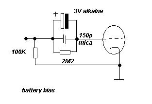

banpuku - in your schematic you have the minus of the battery at cathode of C3g. Wrong. The tube would work know with +2.6V positive bias.(grid current) Even if you have the + on cathode, battery on cathode doesn't sound good.
Go back to 2 x LED for +2.6V bias. Cathode of LED on ground.
Do a search for battery bias. This just a example, you need a coupling cap at input.
