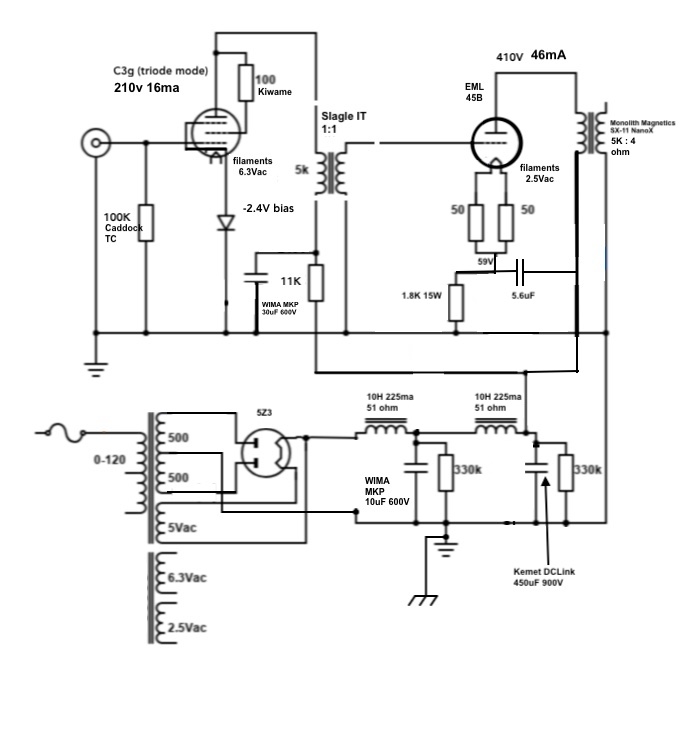

Ian - the amp is up and running. The IT secondary is grounded. And the 45B is measuring 59V on the filaments. The existing schematic is shown below reflecting some changes recently made.
Ahhh and the cathode resistor is 1.8k now too. So you are running around 33mA.

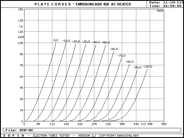

The plate curves suggest at 33mA, and -60V bias, the plate would be at around 290V. Add 60V to that to get the actual plate voltage. That makes it 350V.
But in your schematic I see 410V... strange, but ok.
Also in your schematic, I see this 11k ohm dropping resistor from the HT to the input/driver stage. You are using a (very nice) 5k 1:1 transformer as the load for your triode strapped C3g.
C3g plate resistance in triode is about 2.3k Ohm (at roughly 15mA - Siemens specs sheet). So... what do you think about this? How much amplification factor is lost with this modest 5k load do you think?
I don't want to be too critical. There are lots of ways to do things. I have my ideas, but others here are also able to make very good suggestions.

Not really a ringing endorsement. I have built many wonderful amplifiers over the years. Not a single one uses silver wound transformers (but I am sure they are very nice too).
Ian
Also, you are running ultra-path with only 5.6uF - I guess the 45 has a high enough plate resistance for this to work. I might try a bit more though.
oh yeah... and a 1k ohm grid resistor on the 45 is also a good idea. But you probably know this.
You might want to temporarily try this kind of arrangement (ignore the fact that it is push-pull, and the negative rail on the secondary):
Yes, it will require a coupling capacitor. But then you can use a larger value resistive load on the plate. Maybe you can re-purpose the 11k dropping resistor for the load (needs checking). You might be surprised with the result.

Ian - good questions / suggestions. Thanks. I am running ultra-path just recently (I believe Friday - 2 days ago) and the only cap I had was 5.6uF, other than the 50uF PIO Russian that it was replacing. I wanted to determine if the Jantzen Supreme cap 5.6uF would sound better / different than the 50uF Russian PIO. Answer: Yes, but don't know if the capacitor value or capacitor make Russian PIO vs. Jantzen Supreme is the difference maker. I do understand that the 5.6uF is too low in value. The 5.6uF had lower output, cleaner mids and highs. While the 50uF Russian PIO had higher output, but was slower and veiled. Ultimately, I want to use fixed bias and get rid of as many caps from the audio circuit as possible.
Regarding the 45B output tube. The Vdc at anode measures 410V. Bias measured at top of 1.8K cathode resistor is 59V. So the plate would be 411-59=352V, correct? Also, my ammeter indicates 46mA. Does this sound correct?
Regarding the C3g plate resistance and impacts amplification factor, I do not understand this concept so please share your thoughts.
Caps are not much of a problem. I think working on your schematic will make a much bigger difference. Once you experience what these two valves/tubes can do, you will be surprised. 😉
Yes, so now look at the plate curves for your 45B
Your quiescent operating point is roughly where the -60V curve intersects with 350V (This looks to be something like 75ma)
Learning Ohm's law by heart is a must-do in this hobby. You have 59V /1.8k Ohm = 32.8 mA. Ohm's law never lies.
I hope you know how to correctly measure DC current with the ammeter. You would need to detach your cathode resistor's ground connection (break the circuit) and insert the meter in series with it (make sure the negative terminal is well grounded). I never do this for any circuits with any high voltages, since we have Ohm's law. Lots of older analogue ammeters were broken with to high current in the past...
Now... there is a big difference.. between 75mA (plate curves) and 46ma (measured?) and the actual value of 33mA. Either the plate voltage is different or there is another explanation.
I have an idea of what this explanation is but you won't like it. Basically your supply can't push the B+ higher. And if it could, it would burn out your 45b valve/tube. Think of this is as just a possibility... (been there, done that).
Ok, so the C3g plate resistance is roughly 2.3K ohm and your load is only 5K ohm. back when I did things old-school, I preferred a load of at least 3x the internal (plate) resistance of the tube/valve.
In very lay-man terms (my daughter hates when I say that word), this helps reduce the amount of amplified signal loss through the de-coupling cap (in your schematic the Wima MKP 30uF) . Said differently, your driver will drive a lot more if the load is greater. It will "Swing" more AC volts with a bigger load (again, you can prove this to yourself by using Ohm's law).
But you need to design it. You can't just use any old big value resistor, since there will be DC drop across it too.
Looking at the Siemens specs sheet for C3g, a nice linear load line would be at least 10k Ohm. This would make it parallel to the plate curves. So your 11k Ohm resistor should work, as long as the B+ is correct.
If the B+ is too high, your C3g plate voltage will be too high. 16mA*11k ohm = 176V drop across that resistor. Your B+ is probably something like 420V or so, right? That would put the C3G plate at 244V, which is kinda hot for 16mA on C3g.
So that brings up my other concern.. you have 2.5V Zener or LED bias on your C3g, right? and the plate is 210V ? Look up that point on the C3g triode-connected plate curves from the siemens specs sheet.
So yes, your amp is working. Is it working at correct operating values to get the most out of your tubes? I don't think so. Valves/tubes are wonderful devices since they tolerate so much. Building solid-state without good design always fails. 😉
Coming from experience, designing even a good single end amplifier takes a bit of work. I spend a lot of time going over operating points, plate curves, comparing different potential components electrical characteristics before I even think about starting to build.
But then my results are really darn good. The driver swings as it should and even components that others say sound crap (insert marketing garbage claim of choice here) do something magical.
A well designed amplifier made of modest components will 100% hands-down beat a poorly designed one with expensive boutique stuff every time.
Thanks!
Feel free to PM me. At some point you will probably realize that you need to work on the power supply, after figuring out your B+ is too high for what you need/want to do....
