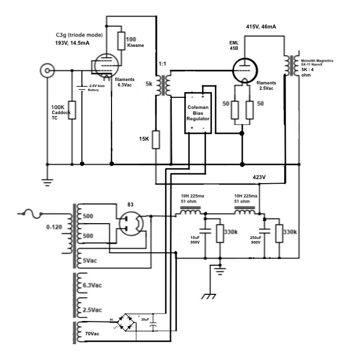

Remove C2? Is this what you are suggesting (see attached)? Or, do you want to have the 11K connected directly to the C3g Anode?
Sorry for my delayed response... unhook the 30uF 900V cap and see how it sounds.
It's still not really ideal if you do this, but it makes the 11k Ohm resistor part of the C3g load. Sure, there will be some increased instability, but it should also work and should be louder.
You could try an smaller RC dropping network than the 11k one, but keep a load resistor in series with the 5k IT choke (if you like it).

@ soulmerchant, since the secondary of the IT transformer is open isn't the input tube loaded by the inductance of the the IT primary rather than the arbitrary 5K printed on the schematic? I suppose it would be easy enough to check if it was working with a frequency sweep.
The secondary on the IT is not open, it is grounded. It won't work it is not grounded (or referenced).
Now, there is always a static resistance associated with coupling transformers (like IT's and OT's). It should always be quite LESS than the inductance... You can calculate it using Ohm's law. This is not the same a load though. The load is 5k in this case since that is what the amplified AC signal will "see".
For resistors it is simple. The AC load is the same as the DC load. 🙂
Frequency response is something very important to consider too. You can easily lose high frequency response if the source doesn't have low enough output impedance to drive the input capacitance. Then your amplifier kind of sucks...
You might think, hey.. I am using and IT so I will be fine. But capacitances are reflected through the IT, and even the BEST IT's have parasitic losses. So IT's need to be used in a careful way. If you try to use anything higher than 1:1 you need to do some maths to make sure you won't be unhappy with your result. Btw - it is possible to use IT's in configurations such as 2:1 and 4:1 - this can work well in the correctly designed circuit.

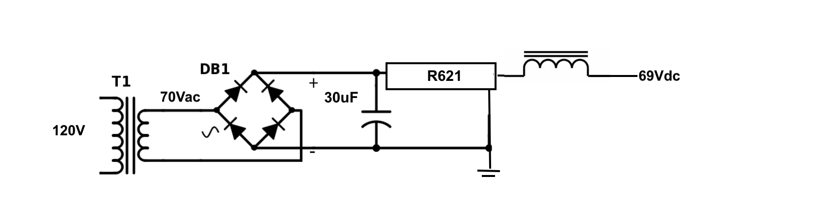

1. Fixed Grid bias. This eliminates the finals cathode bypass cap. I need 69V of bias on the 45B. I have an unused 70Vac secondary on the power transformer. The attached schematic shows the conceptual AC-DC rectification with cap, Rdropper and choke. First question: does this schematic look correct?
Vdc = 70Vac * 1.414 = 99V - Vdrop = 99V - 1.4V = 97.6Vdc
IF the calculation above is correct and my target is 69Vdc, then the Rdropper should be R = 28.6 / 46mA = 621 ohms.
I have no idea how to size the choke. Help!
2. Do I really need the c3 30uF cap? I did not hear much of a change with or without it. Ultimately, a dedicate power supply for the driver tube would be ideal. But until then, what if a choke was used after the 11K dropping resistor?

Be aware that a choke in the bias supply does not make too much sense as the current in this circuit is minimal, maybe 2-3mA. Dont make your life too complicated. You want a normal voltage divider with some potentiometwr in the beginning. like this one 1set Tube Amp negative Grid Bias Netzteilleiterplatte montiert 4 Kanal fur PP Eierschalen | eBay
Later you might want to upgrade to rod colemans bias regs or pete millets shunt bias regs.

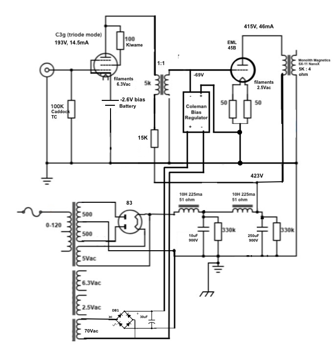

I already have Coleman's bias regulators. I just need to get the rectified DC. So, what do you think about this?
Also, any way to get rid of the 50 / 50 ohm resistors on the filaments? Other than using DC?

You connect the negative end of his bias reg to the other end of the secondary of the IT which does not go to the grid. So, you do not ground the It anymore on the secondary.
like shown here...Ergebnis der Google-Bildersuche
Other than that, Rod suggests a pretty simply 100uF-1k-100uF supply as the raw supply...have a look into the schematic in the manual.
No, you need clean DC I guess, but that is a simply task, no ?
You do not connect the IT secondary to the ground. only to the regulator ! Otherwise you shorten the reg. And have still ground potential on the grid.
Same for your driver tube. the 100k resistor pits your grid to ground potential while you want a negative grid potential. I have not worked with batteries, but I guess it comes between the resistor and ground.
And Rod wanted not 30uF infront of the reg but 100uf-1k-100uF CRC supply...
But I would simply put two cree sic diodes on the cathode of the driver tube. See Ale bartolas page. No messing around with batteries necessary.
Remind me about the 15k resistor infront of the primary of the IT...was this meant only for voltage dropping purpose? Then it should have a PSU cap behind it and attached to the first stage of your LClC I guess.
Currently it mixes up transformer loading and resistor loading and presents a high impedance psu to the transformer while we did everything to have a low DCR ib the psu (what was the name of this thread again?). This is a dynamic killer.
No. The opposite is the case. It is cooler as the ripple voltage VPp aceoss it gets smaller and the sttess level for the choke is less. It is a step towards CLC without causing a Voltage increase. And CLC is a lot less stressfor the choke (but sounds very different).
Blitz - the 15K is a voltage dropping resistor. I tried moving the 15K (including the bypass resistor) to the first stage of LCLC, but it caused too much hum.
