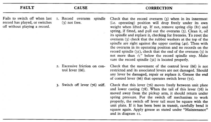

The 2025 service manual says that the switch off lever on the lower casting (beneath unit plate?) could be stiff or bent and to check that it moves freely and returns under control of its spring.

Says it all but it refers to each part number referencing the exploded view parts but scrolling further down it actually mentions this fault in the faults section and the arm I quoted says it could be "stiff " and the lever tail must be square ( 90 degrees ) with the unit plate ( it could be bent ) .
Or "excessive friction on the control lever" =66--needing greased that operates switch lever =72
Or record overarm spindle =3 not free --IE- drops under its own weight.
Again clean and oil.

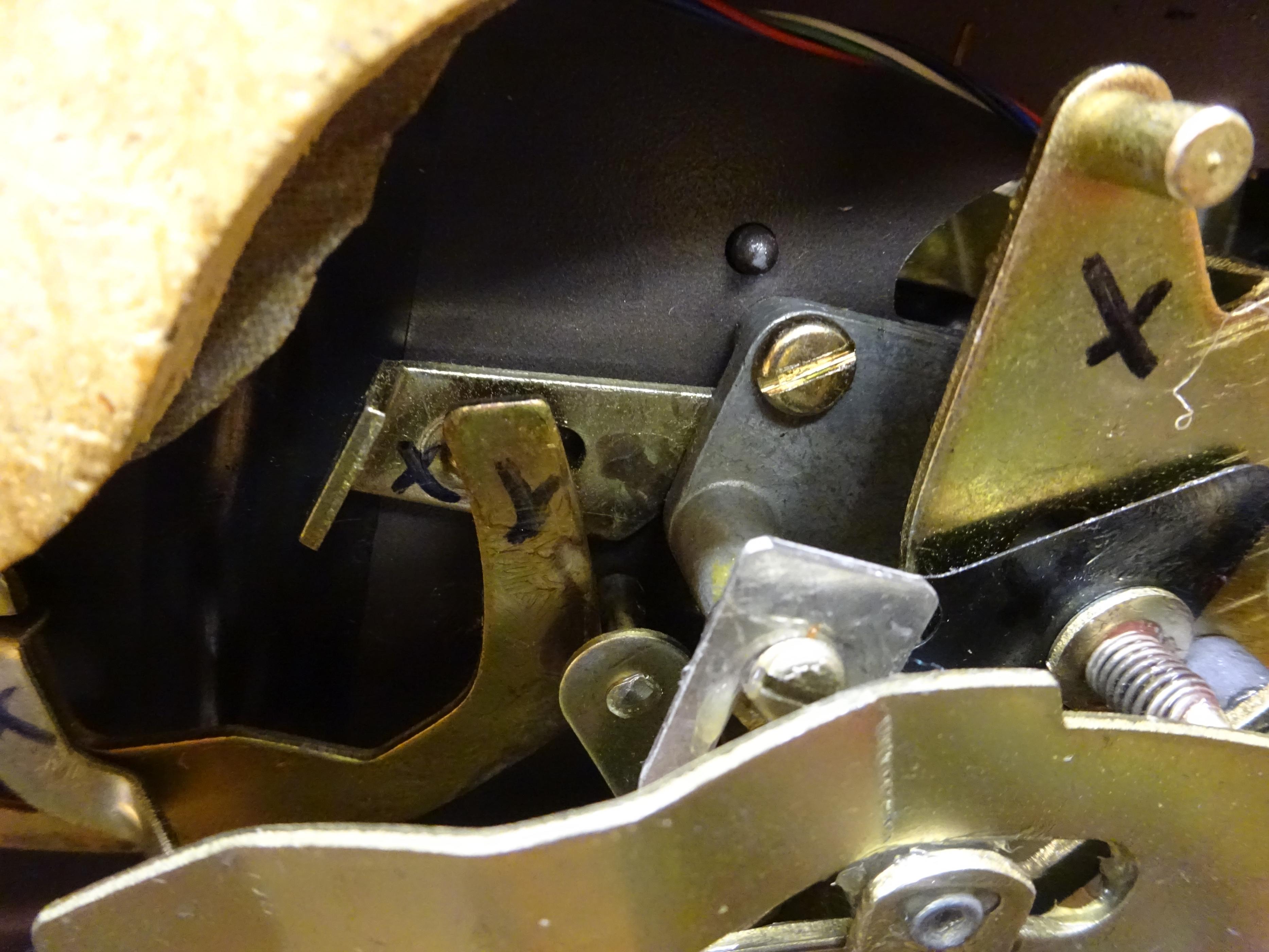

Thanks, I'm happy to go with that advice! 😉Better to go with the Service Manual - because it's the best advice...
I'm going to have a good look at it in a moment, and try and work out what is going on.
I will post my findings and any pictures later today.
I feel like there's some lever that needs to push the Manual lever to the off position, but it's not in the correct position to do this - just my feeling sop far.
Rob
Rob

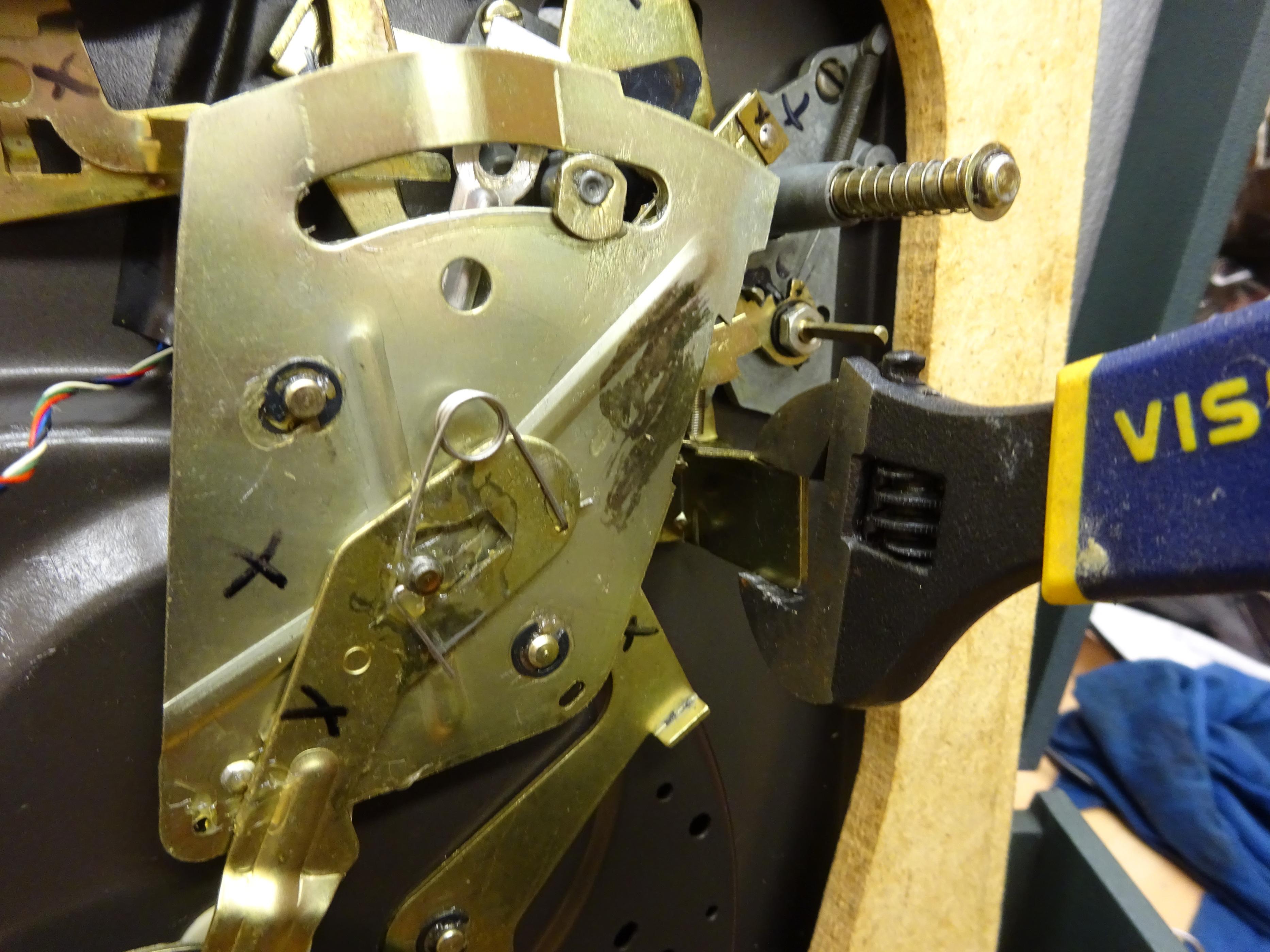

I've got it to automatically put it to the "Off" position now, once it's back on the support.
I eventually worked out what was trying to push what to release it, then gave it a little tweak (bend) to make it work.
The bit between the jaws of my adjustable wrench is what I adjusted.
I've also adjusted the height of the arm when it's lifted off its support, and increased the stylus pressure (turned the knurled nut at the rear of the tonearm) to stop the needle skating across the record when its put on. Its also had the new stylus fitted.
I'll play it for a while before I take it out to show anyone.
Thanks for all your help, Rob
