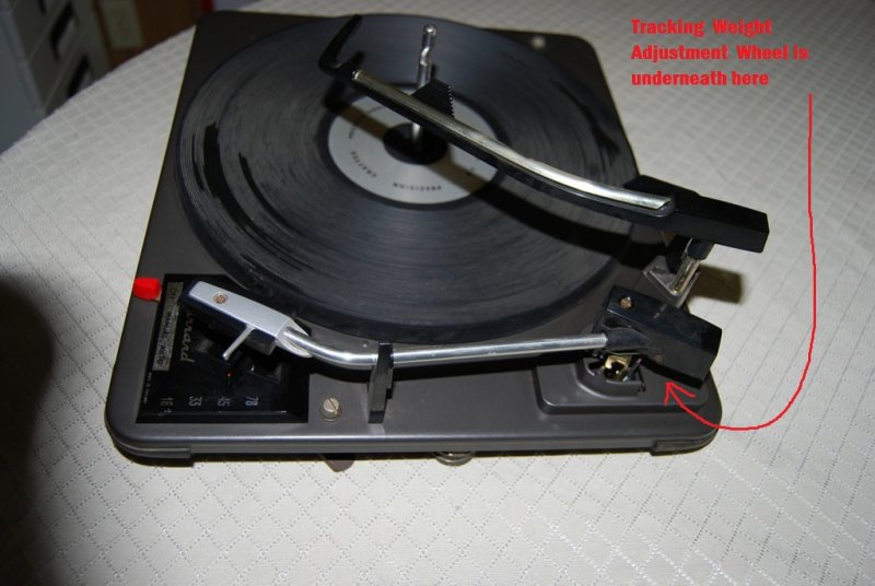

The stylus force adjuster wheel is underneath the black pivot housing, at the rear.

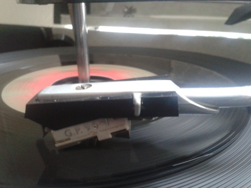

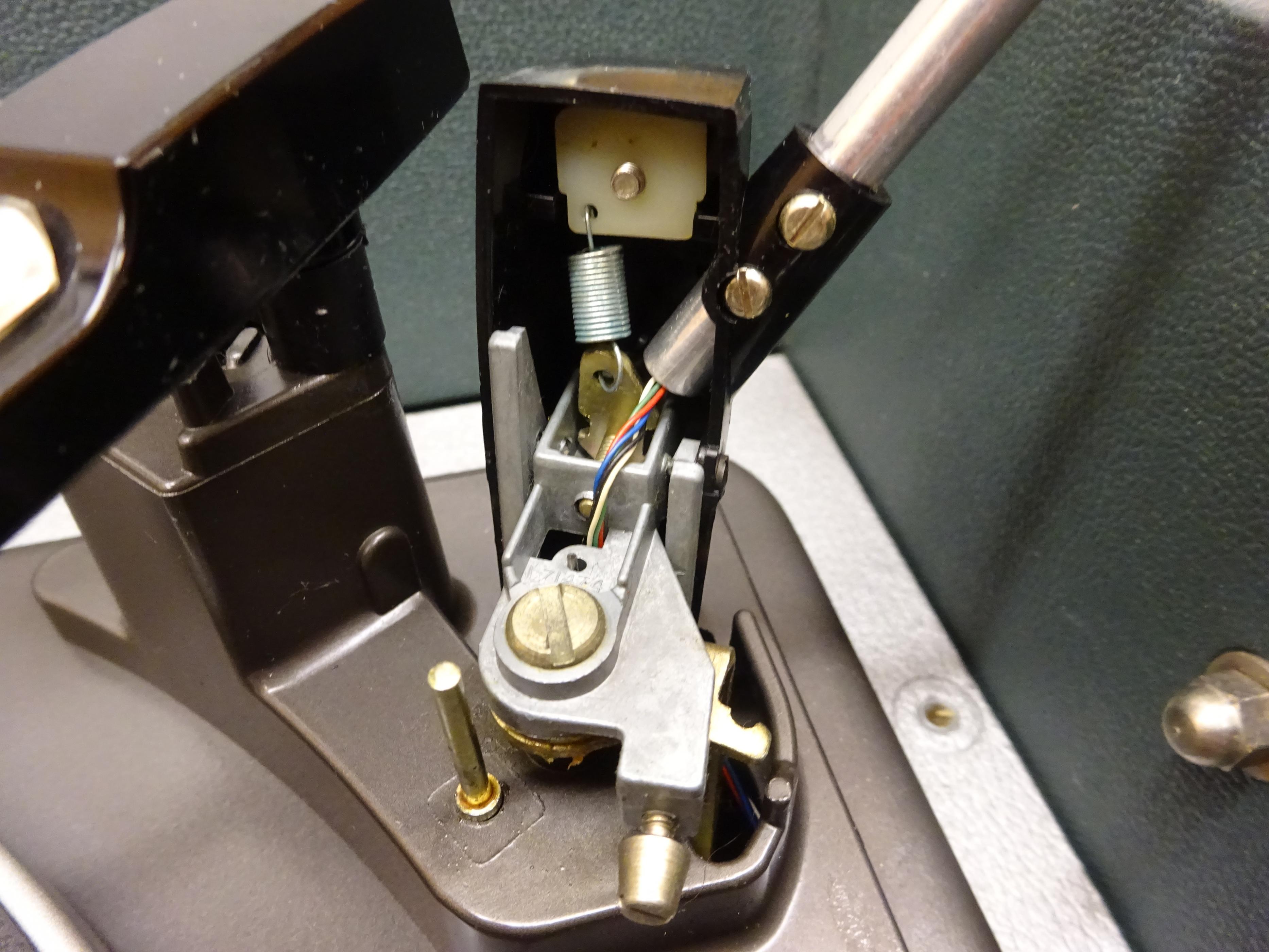

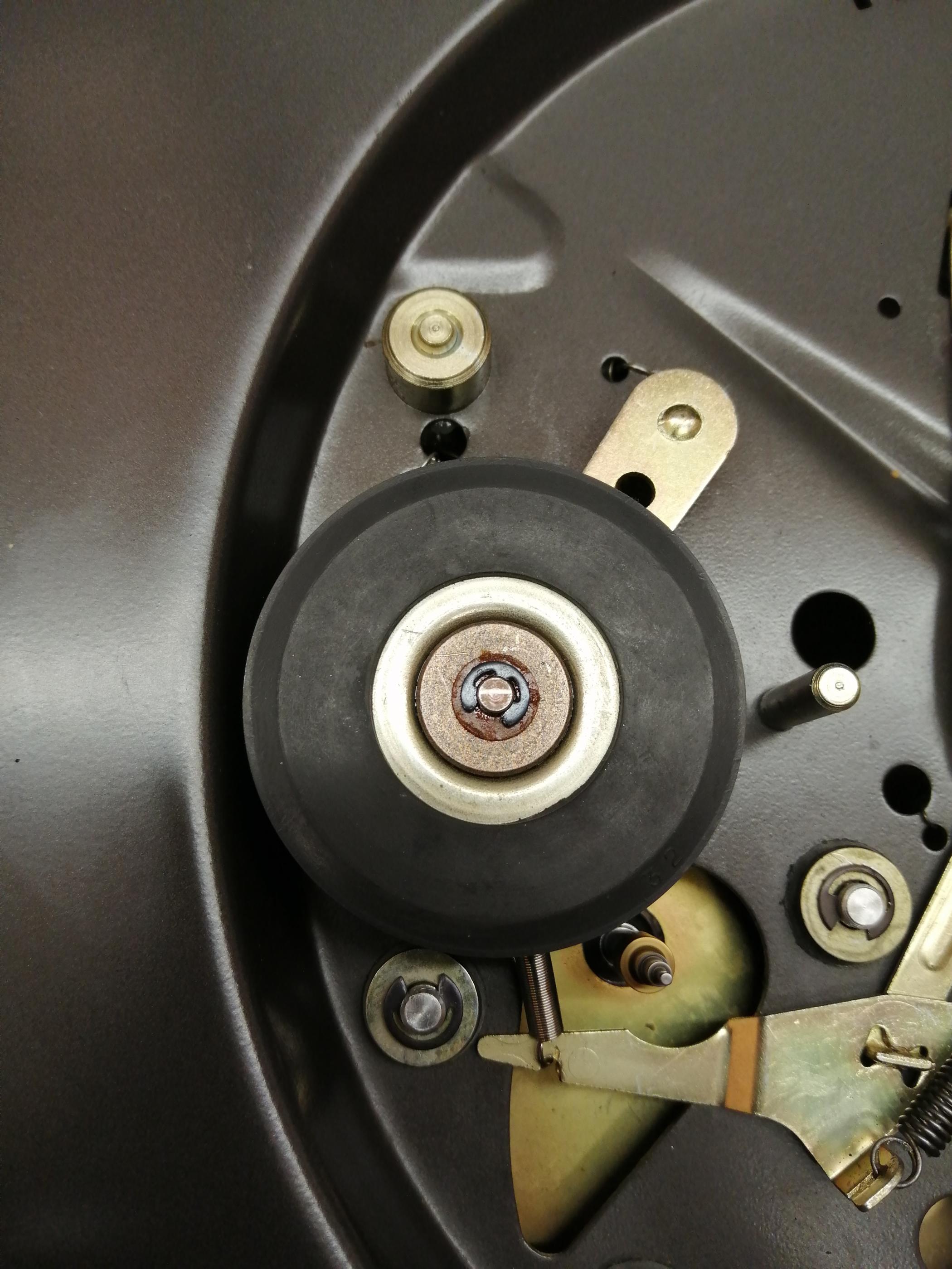

I've roughened up the rubber part of the motor idler wheel with some emery paper and cleaned the inside of the platter (as suggested), and I have better drive now. I also shortened the spring a bit that pulls it onto the motor drive spindle, so it's hopefully under a bit more pressure.

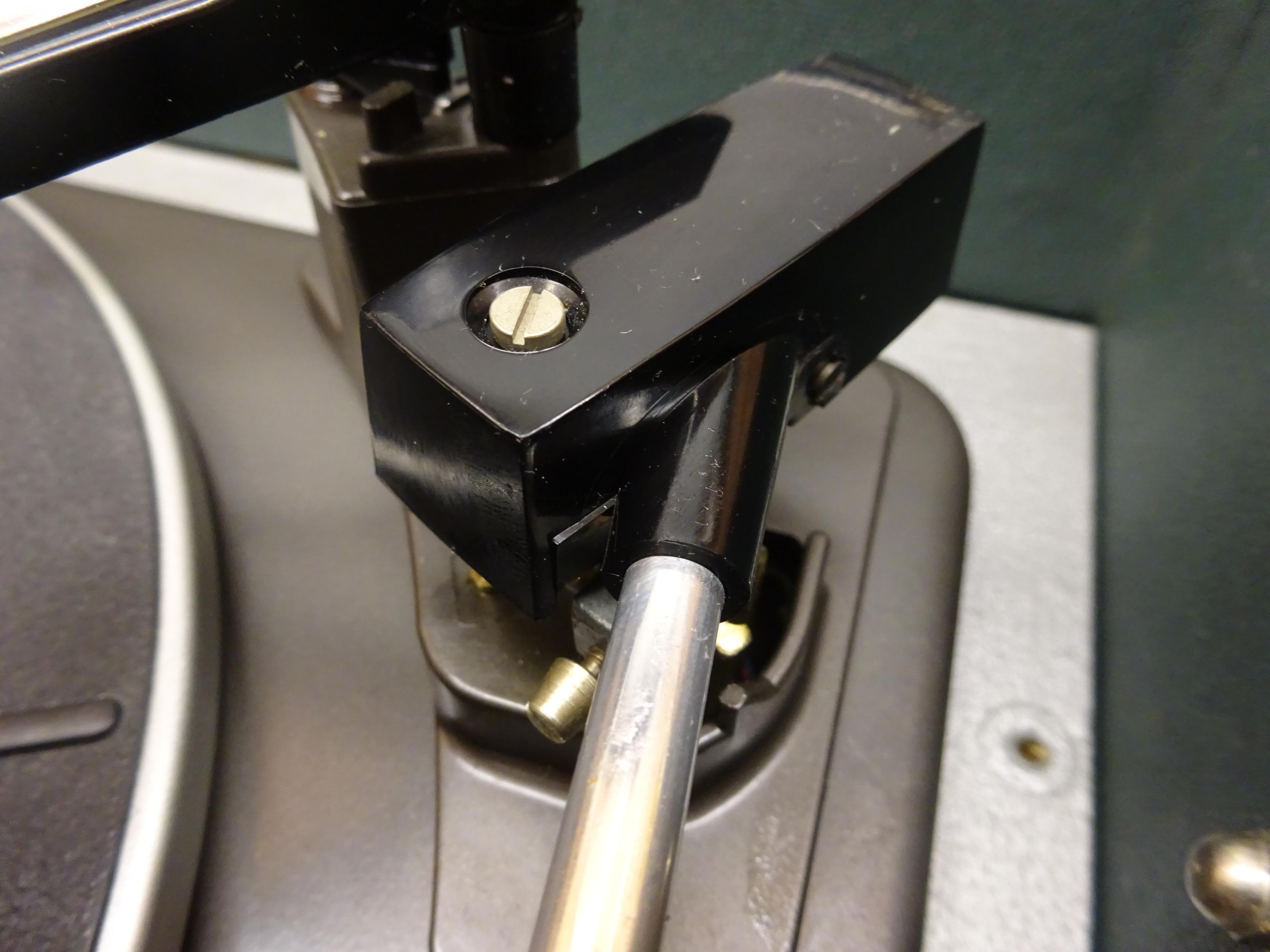

Can I presume that if I had the bit of alloy with both points in my hand then it had broken away from the main part (silicone sleeve, plus white and black plastic part) of the stylus? If so I will order up the replacement stylus you kindly sent me a link to, then see how it gets on.
With reference to the tracking force, are you able to show on the picture attached where I'm looking to adjust (once I have the new stylus)? Is it the screw on the top that tightens the spring you can see?

Make sure you've read the stylus replacement instructions: "To remove your old stylus ensure cartridge flag is pointing towards the centre of the turntable and remove the stylus by lifting the base of the cantilever, do NOT attempt to remove the flag (this is part of the cartridge)."
Yes, it sounds like your stylus assembly has come unstuck. However, a stylus replacement is de rigueur when renovating a turntable - who knows the condition of the existing needle tips?
The recommended tracking force range for the GP96 is 3 to 6 grams. I would set it initially in the middle at 4.5 grams. Cheap stylus gauges are readily available for under £10, if you don't already own one.
You've done something that almost everyone seems to do, to "help" add friction to an old, failing idler drive. - chopping the tension spring.
And sorry, but that's a definitely wrong idea to attempt. - and a temporary "backyard mechanic fix".
The proper way is to do a full clean and relube to the ider mechanism, motor, and replace the idler if it's not pliable, or glazed and hardened due to age.
Same goes for the rubber motor mounts if deteriorated.
These rubber parts are easily available, not expensive, and preserves the original quality of the unit.
The stylus is actually a GP94-1, so I ordered that one from the site you sent me a link to. It doesn't come with the flip over flag (that's part of the main cartridge), and is pretty simple to fit. I've superglued the old pole with the two needle tips back into the silicone sleeve for the moment, so I can still test it etc. I'm not going to adjust the tracking pressure, as all may be fine once the new stylus is fitted - hopefully.

I hear what is being said about replacing the motor rubbers, and the idler, but the motor rubbers seem pretty good, and I'm now getting good drive from the roughed up idler drive. I don't want to spend too much money on this, as I mainly just want to get it going again. If once I have it all working and it starts to play up during extended testing/playing, then I'll replace the motor rubbers and idler.

I'd like to take your advice and replace the rubber motor mounts (they look fairly good), and the large idler drive wheel (its not getting good drive, even after roughening it up etc), but am not sure where is a good place to get them, and not get stung for the privilege.
