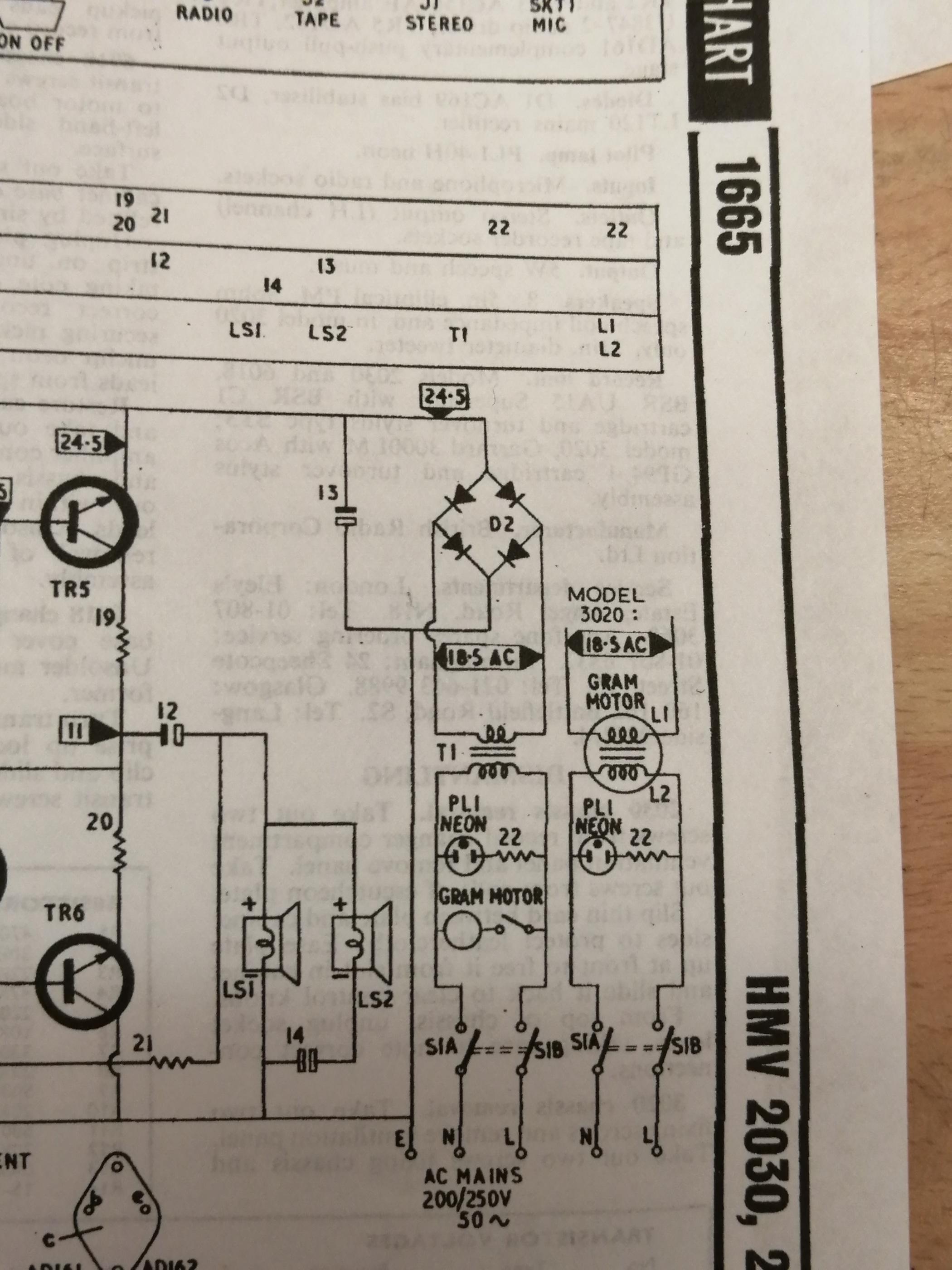

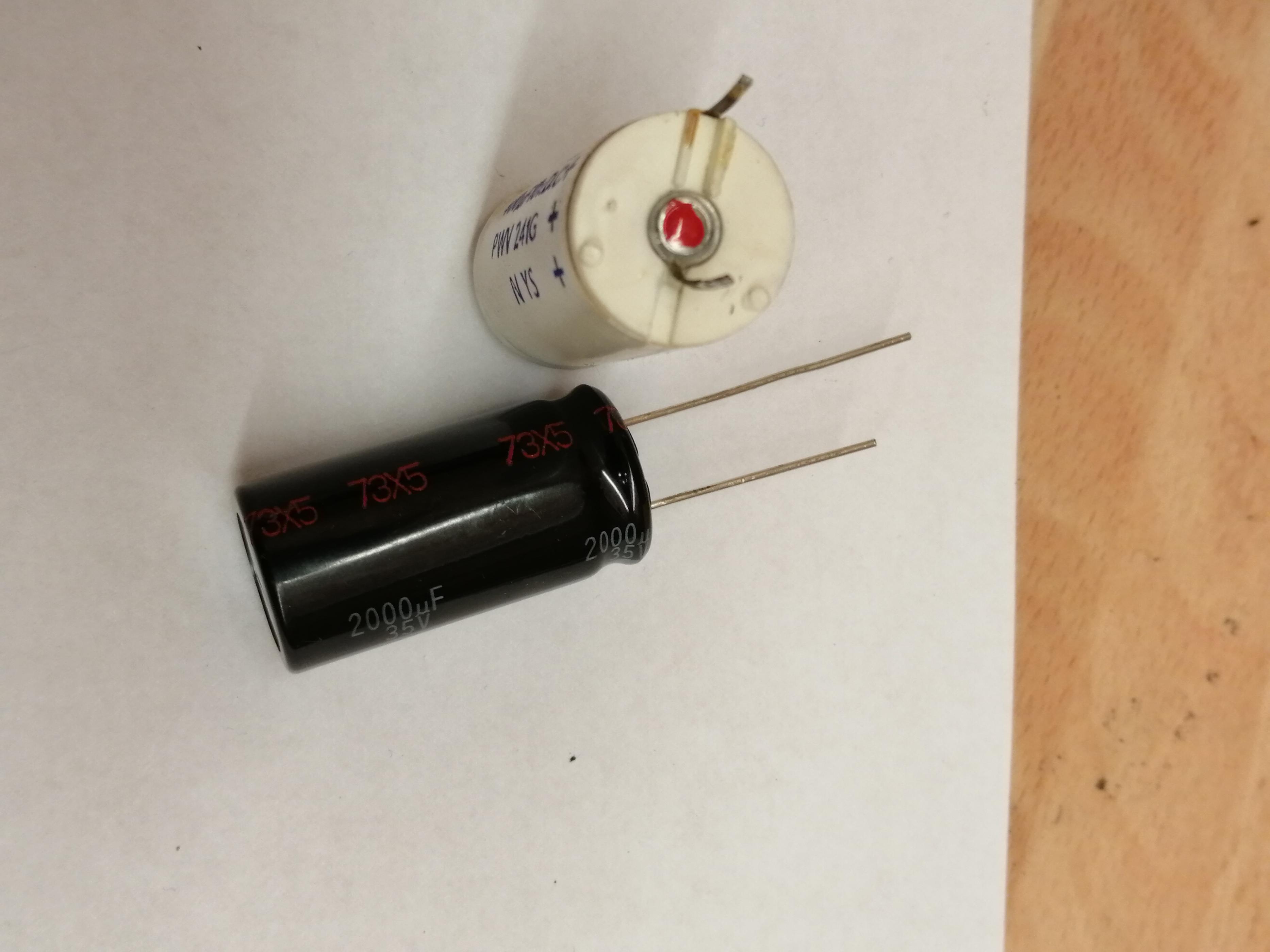

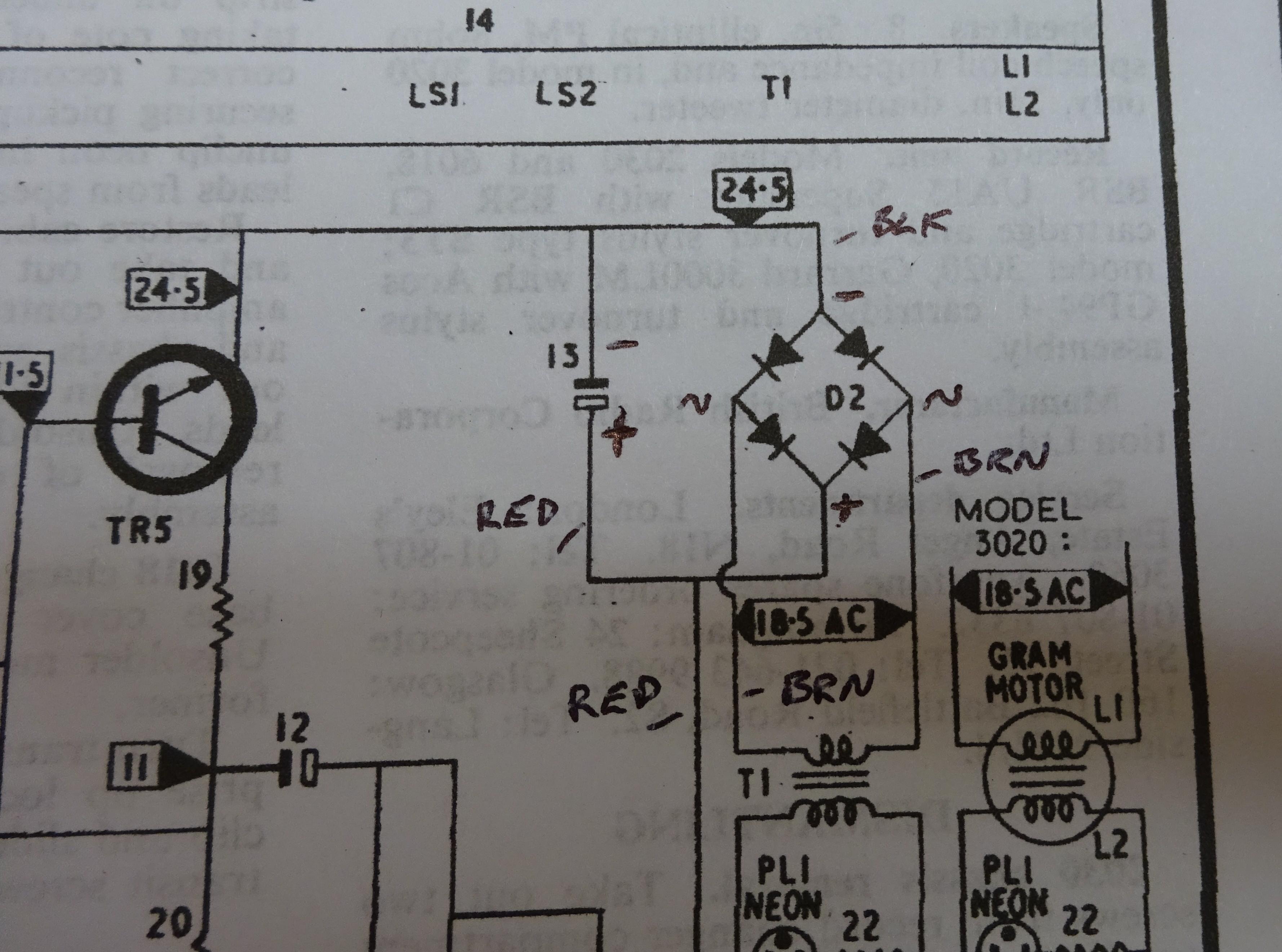

I was wrong! 😱 The positive side of the new 2000uF capcitor should be connected to chassis earth (as shown in your circuit diagam). The red dot on the original 2000uF capacitor is, of course, the positive terminal.
Re your new capacitors, if the short lead is -, then the long lead has to be +.

The +ve (red wire) on the rectifier, does that go to the long lead on the new capacitor?
Rob
Rob
If you've bought the new rectifier as advised, then connect + terminal of rectifier to + terminal (the long lead) on the capacitor.
Okay. And does the earth tag on the centre of the rectifier also go the +ve terminal of the capacitor (also +ve of rectifier)?
The rectifier mounting bolt provides the earth connection. Connect the tag on the bolt to the positive terminal of the cap. No other earth connection is required.
The positive terminal on cap should also be connected to the positive terminal on rectifier.
In other words, make the connections as they were originally implemented.

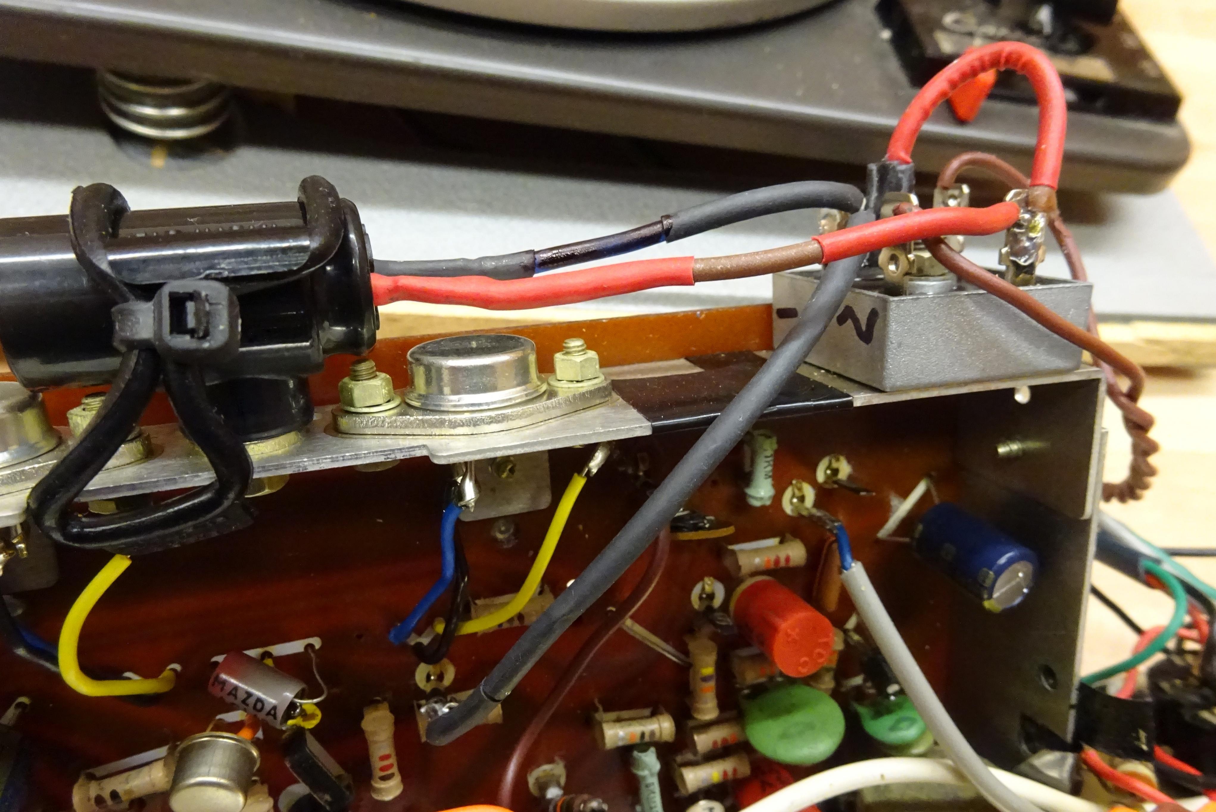

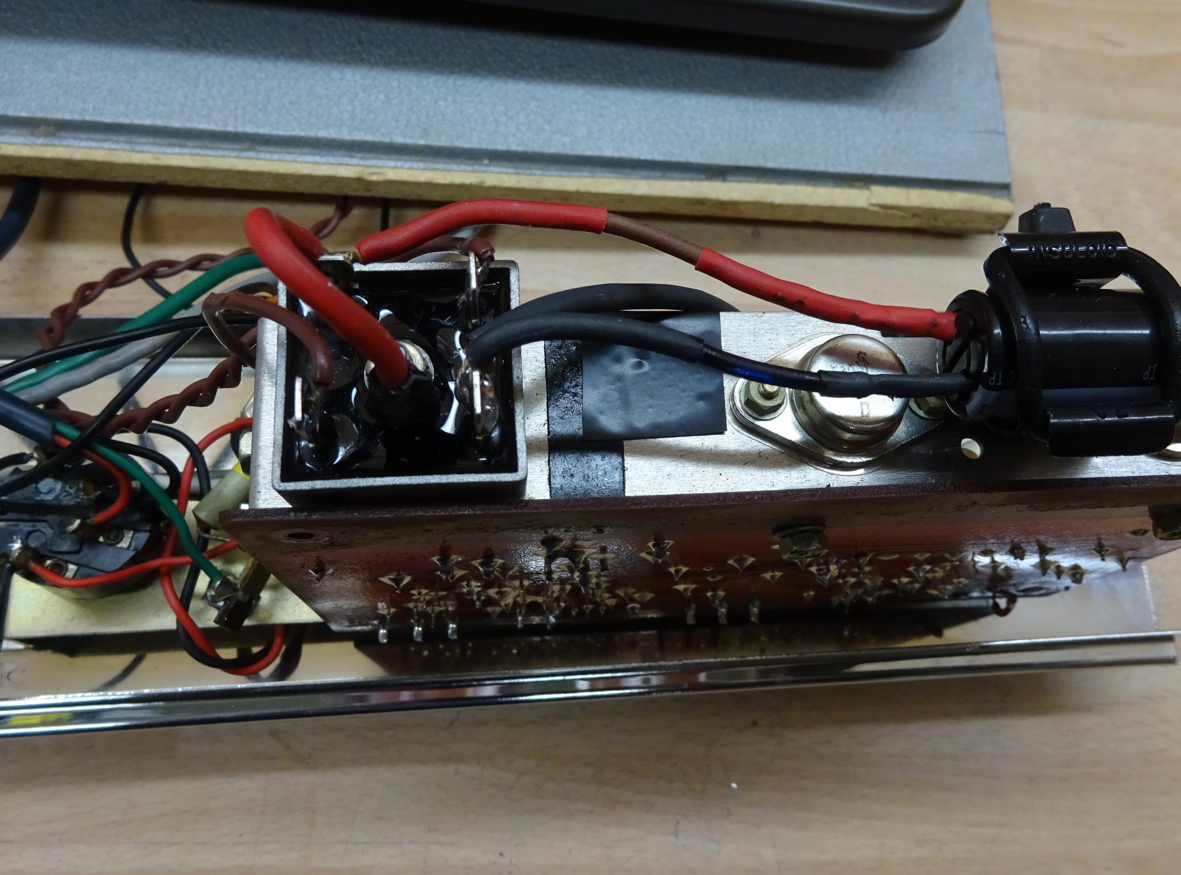

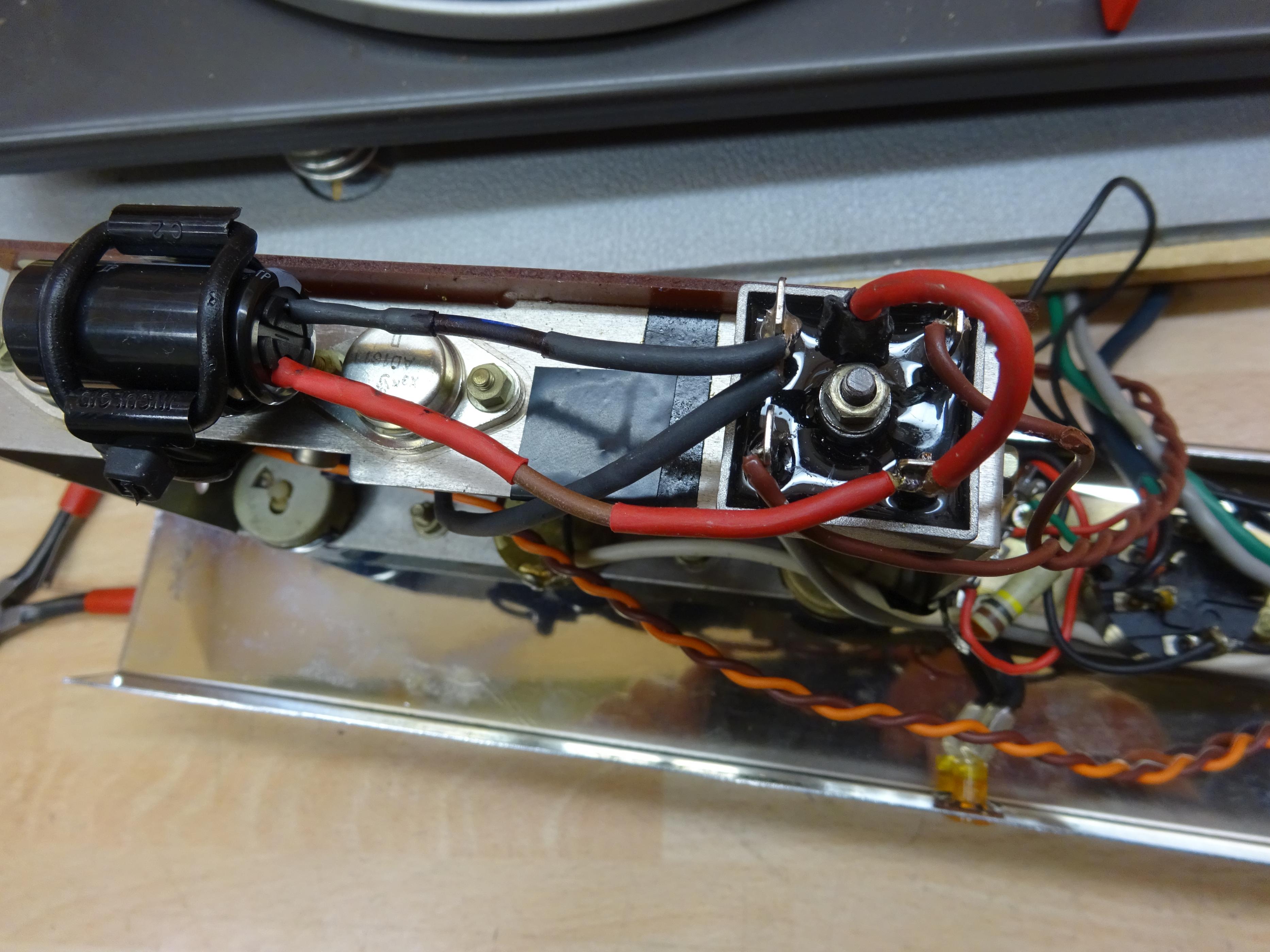

Up nice and early, and I've done the wiring how I believe it has been explained to me, and how it should be. Please see attached pictures, and labelled up circuit diagram.
I didn't have cable in all the original colours (red, and black), so to keep consistency I've sleeved the cabling the original colours.
The red lead goes to the +ve on the big (2200uF) capacitor, then to the earth tag. The twisted brown pair of wires come from the motor/transformer.
Yee haw! The hum has gone 🙂 Happy Days!!

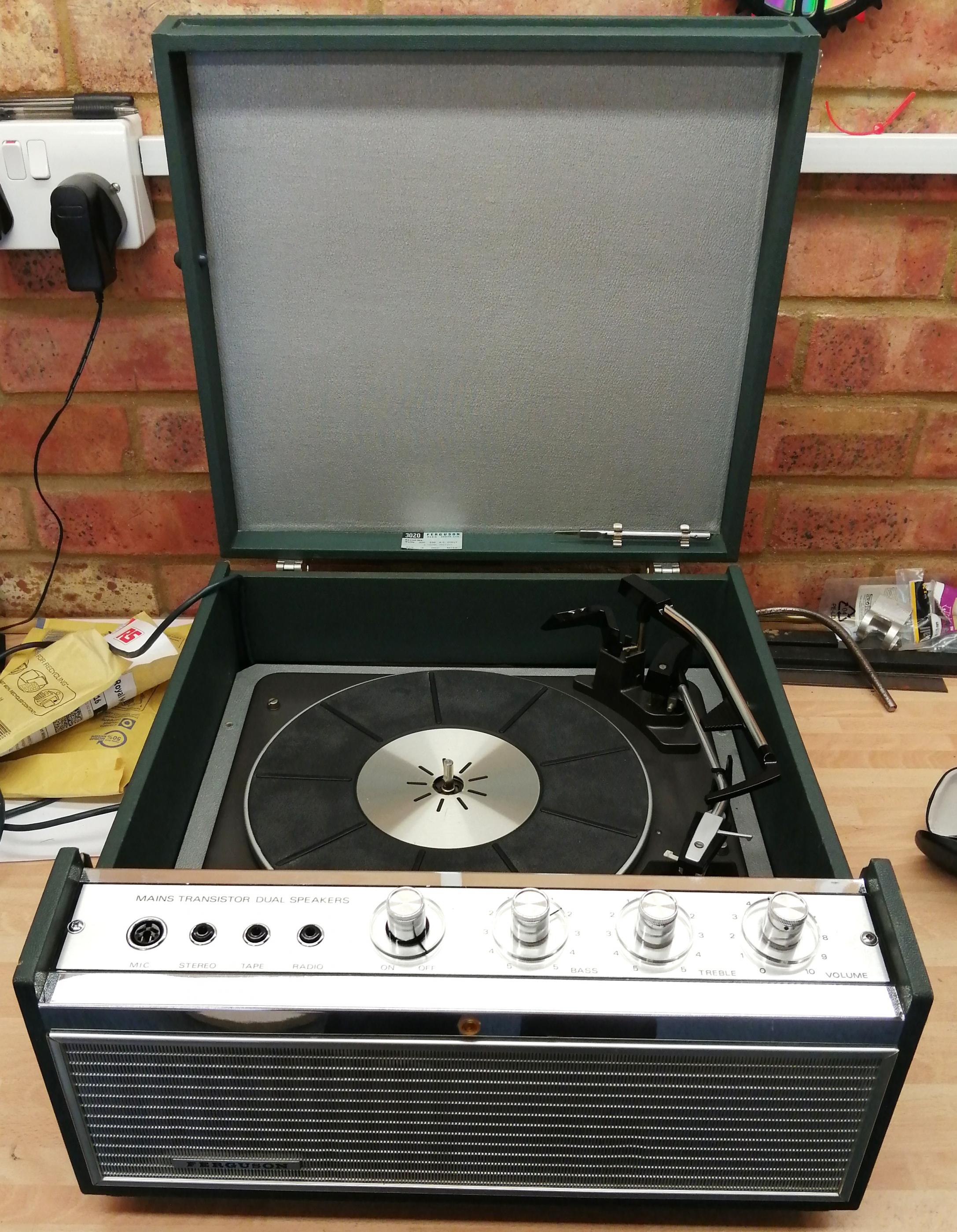

Here's a pic of what it looks like after I've cleaned it up a bit.
The bit that's poor quality is the top of the cabinet, but that's not shown in the picture.
I think there may still be a problem with the mechanical movement of the arm, but I'll look into that later.
Thanks all. Rob

Looks pretty good to me.
I would not attempt any more cleaning.
Be careful of the printed letters as they come off very easily.
Some auto-changer mechanisms appear "stiff" but that is the nature of the beast.
Clean off any old grease and renew with a smear of vaseline.
Andy

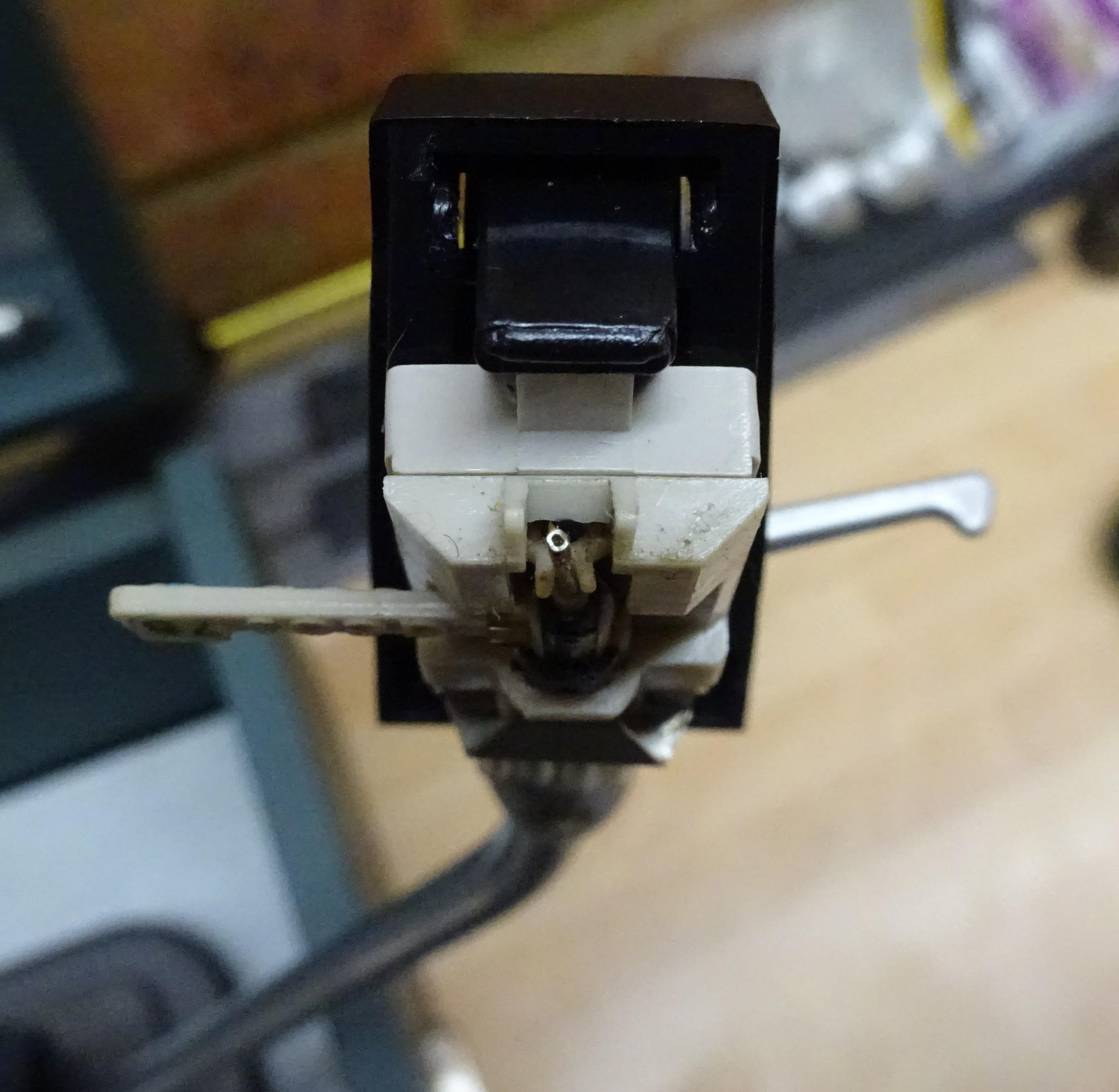

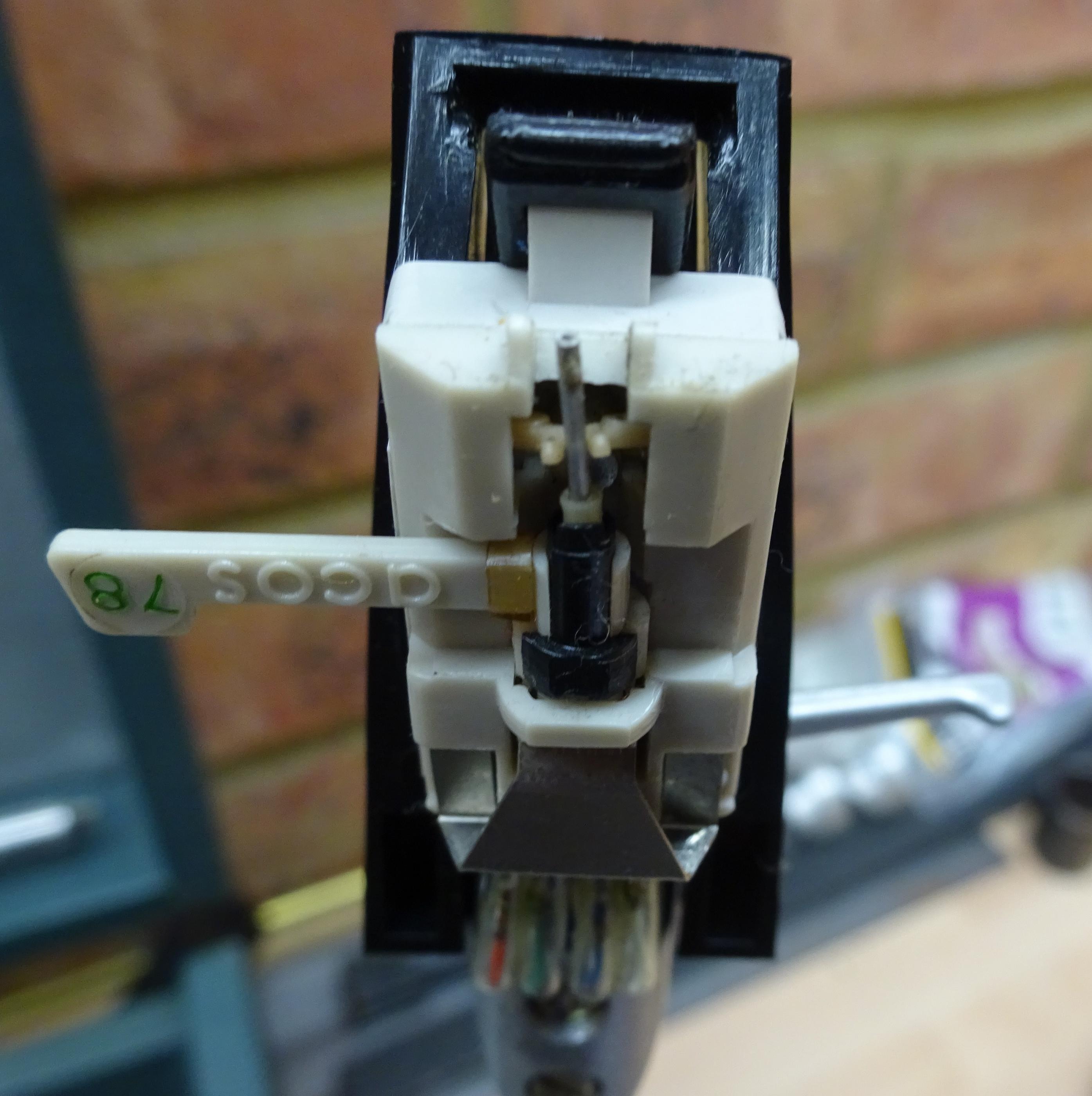

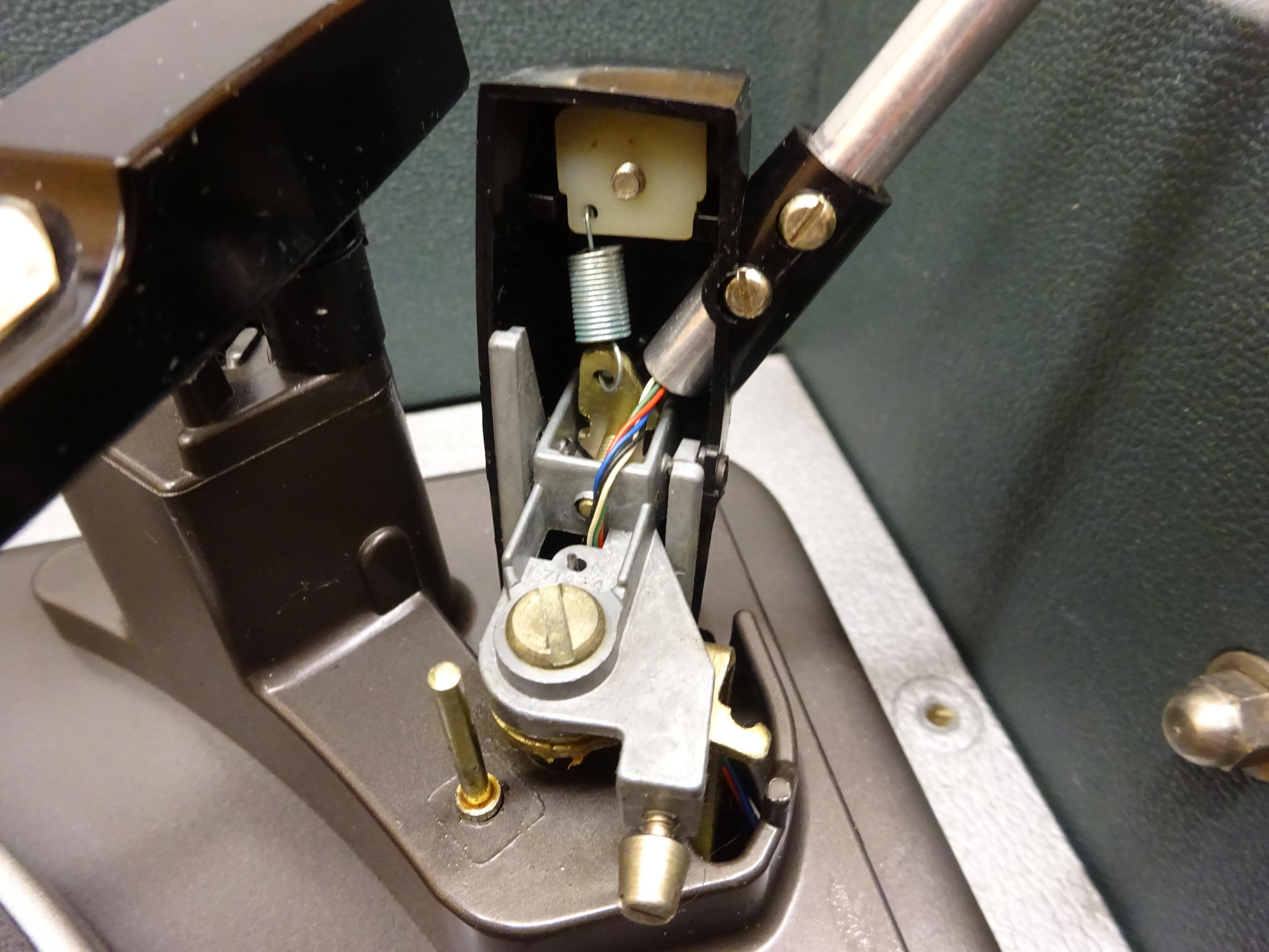

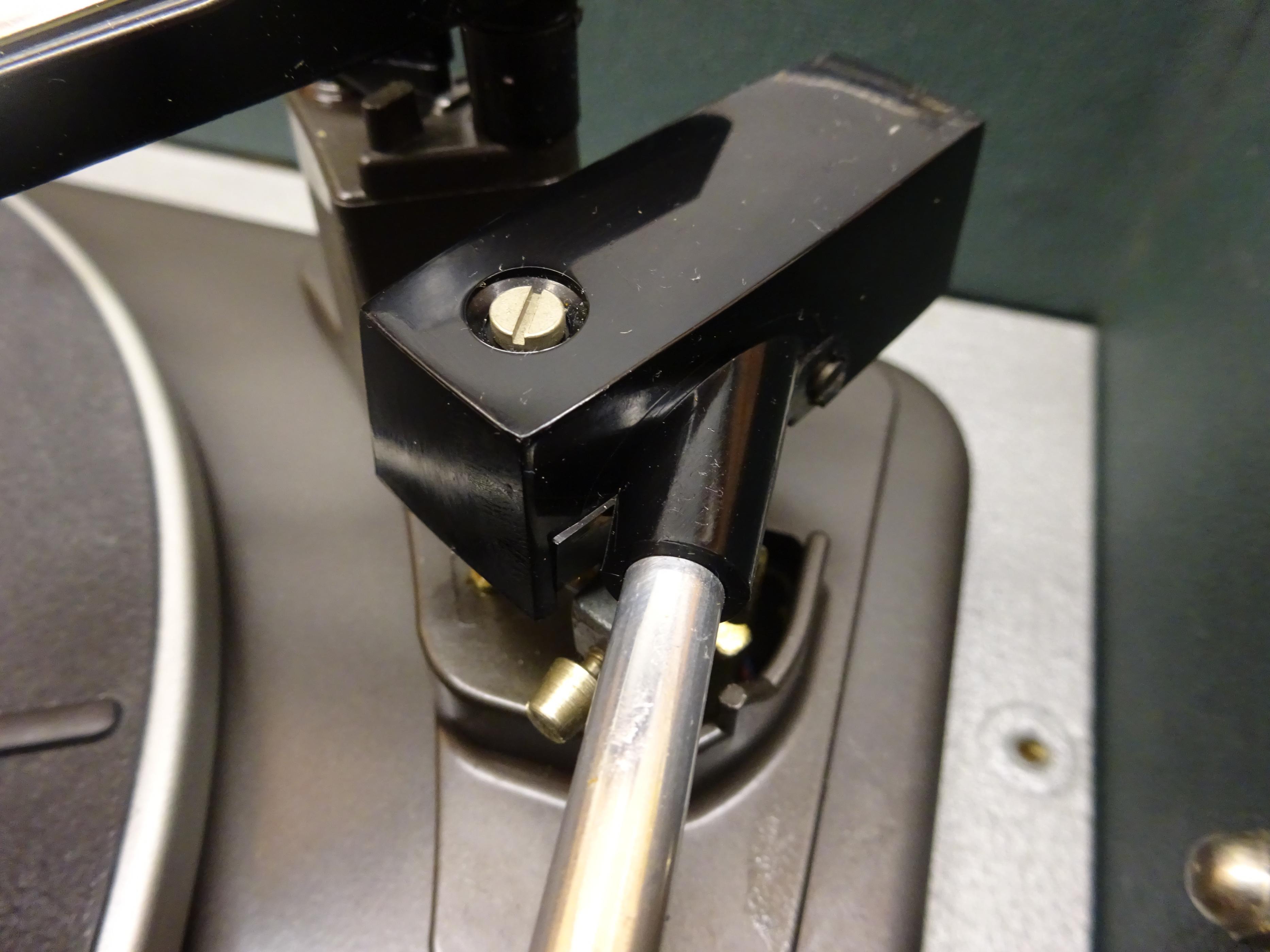

(2) The needle fell out when I turned the deck, and it got caught. This was a thin alloy shaft about 1 cm long with a needles on either side. I've pushed it back into the silicone sleeve and it now picks up and works again. However the cartridge can sometimes be heard rubbing on the surface of the record, so maybe I've done something wrong. Or could it be that the silicone bit that supports it has lost strength over time, or there's too much pressure being applied? I'm not sure how you set up tracking force on these arms.
Hopefully the pictures attached will also help.
Thanks in advance, Rob

1. First step is to clean the edge of the idler wheel and the driven surface of the platter with alcohol. If that doesn't work, roughen the rubber with fine emery paper. Replacement idler wheels are to be found on auction sites.
2. I presume this is the original stylus you are describing. It should be replaced as a matter of course, but the entire cartridge may need replacing if the stylus suspension has deteriorated. How to adjust the tracking force is described in the Garrard 3000 manual: https://www.google.com/url?sa=t&rct...s-Manual.pdf&usg=AOvVaw2drZlWJsEkauHLAPx-cpxy
