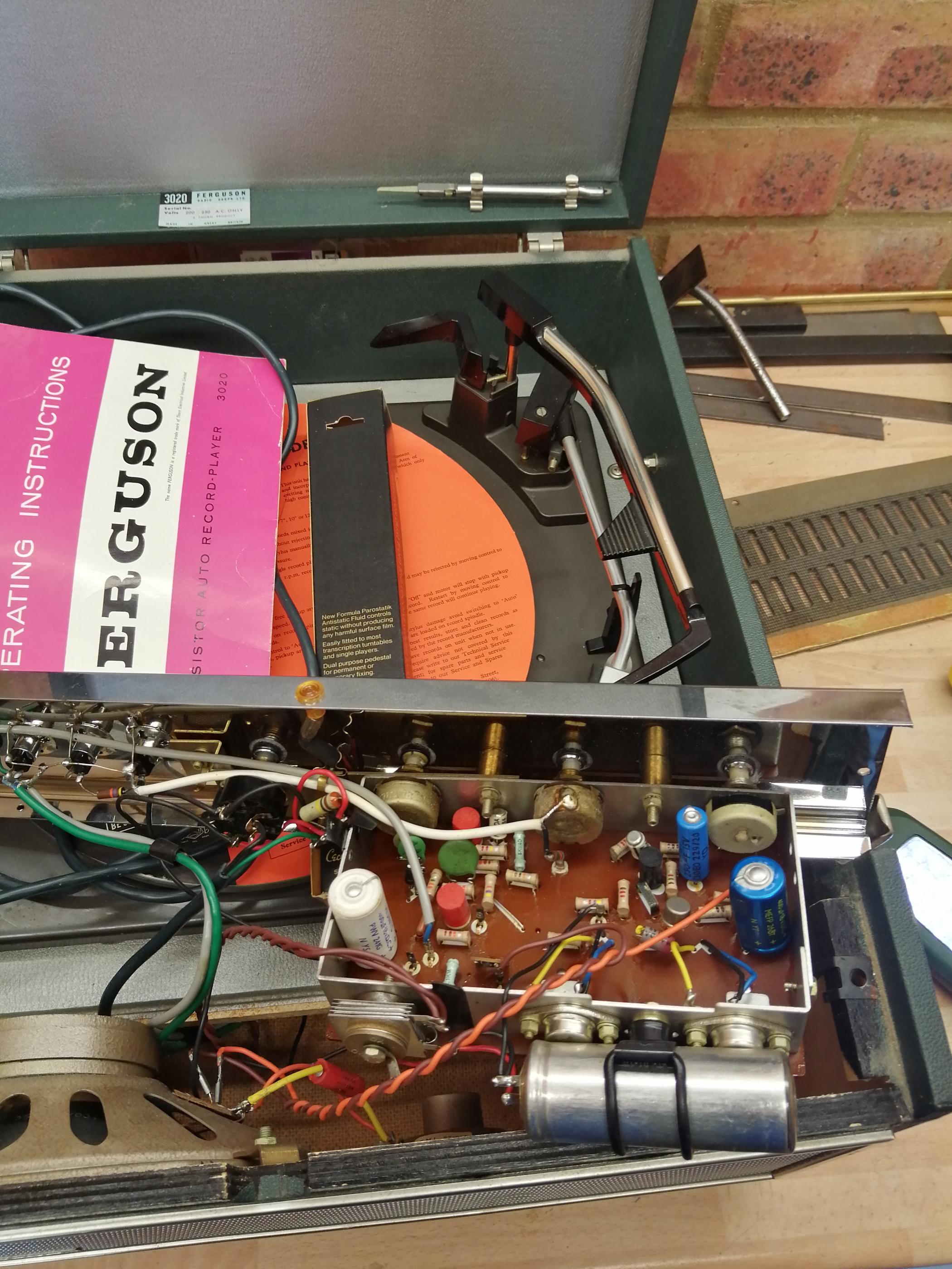

When I turn this 1960's (?) Record Deck on, it gives a loud buzzing noise over the speakers. It increases with volume. I can plug my phone into the radio jack (and play music), and play a record on the deck, and the sound comes out, but there's always the loud buzzing noise.
I've got the speed changer, and turntable etc to work, and would like to get it cleaned up and fully working, as it could look lovely. However I don't have the electronic ability to fault find it. I do have the ability to use a multi-meter and do the odd bit of soldering etc, so would like to "have a go".
Does anyone think if I change the capacitors in the attached photos I may stand a chance of curing the buzzing noise? I don't want to throw a lot of money at it, or sub it out to someone (and have to pay them), and if it stands a decent chance, I'd like to give it a try.

The electrolytics all look good, not saying they are though.
Sounds like you could have a bad earth wire on the cartridge/deck somewhere.
They are very simple to work on, once you have them opened up.
Disconnect the record player from the amplifier end, if the hum has gone, there is the fault, as described above.
If the capacitors were at fault, the hum level would not change with the volume control.

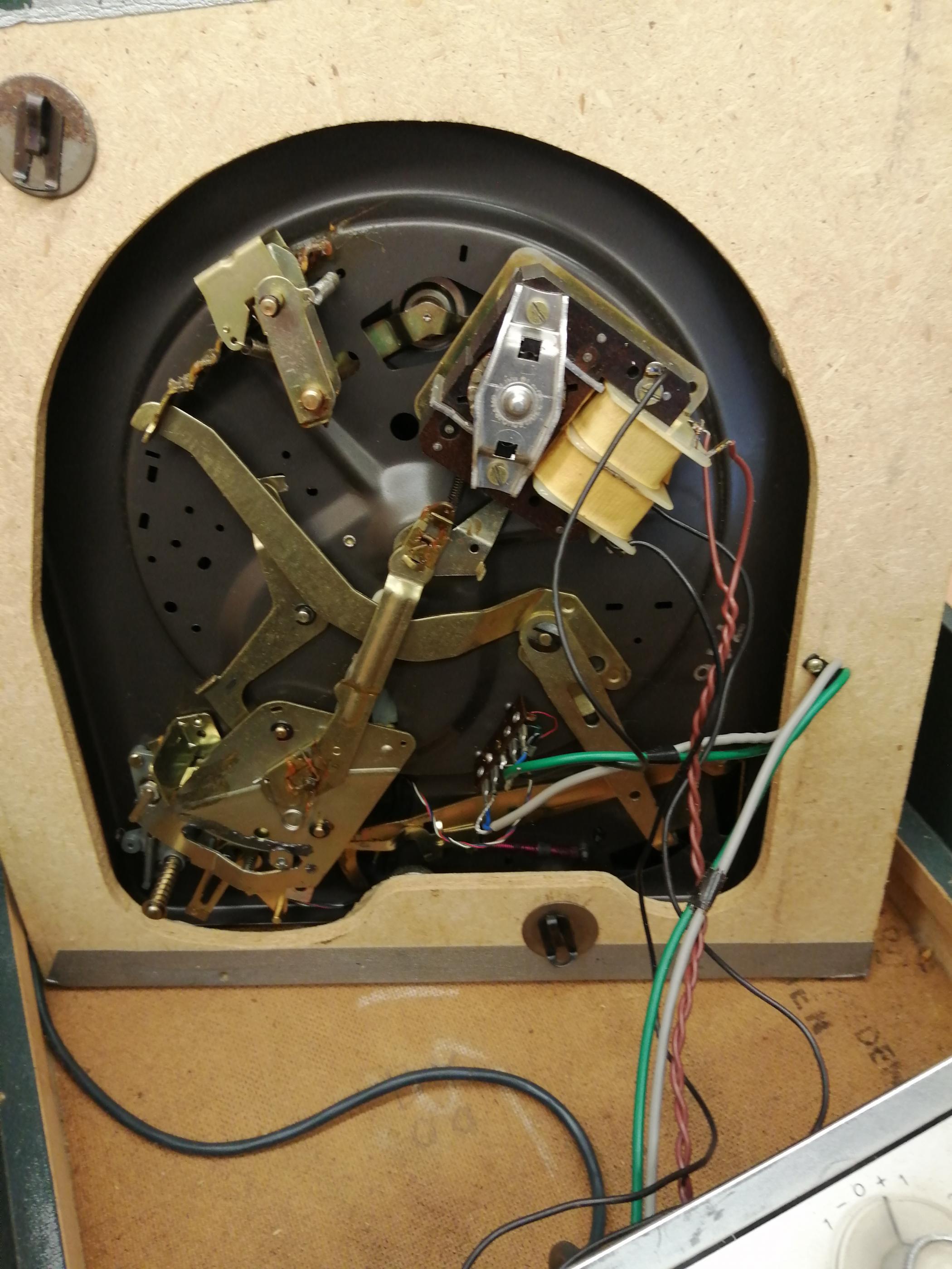

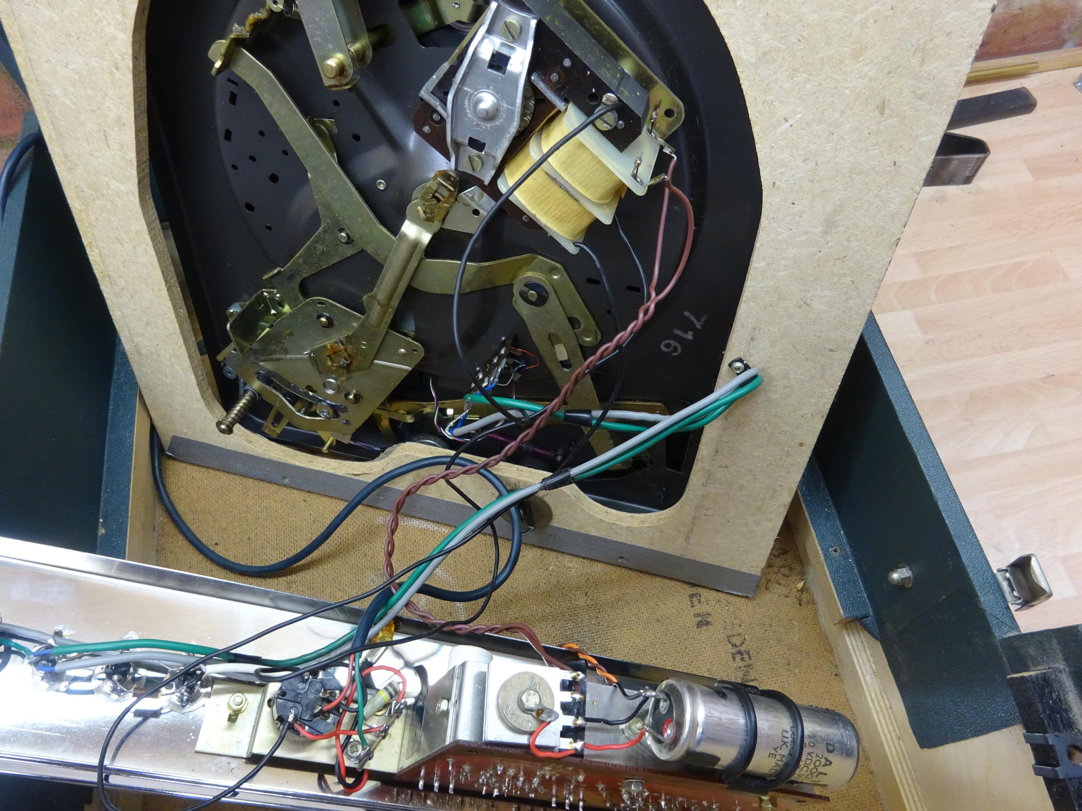

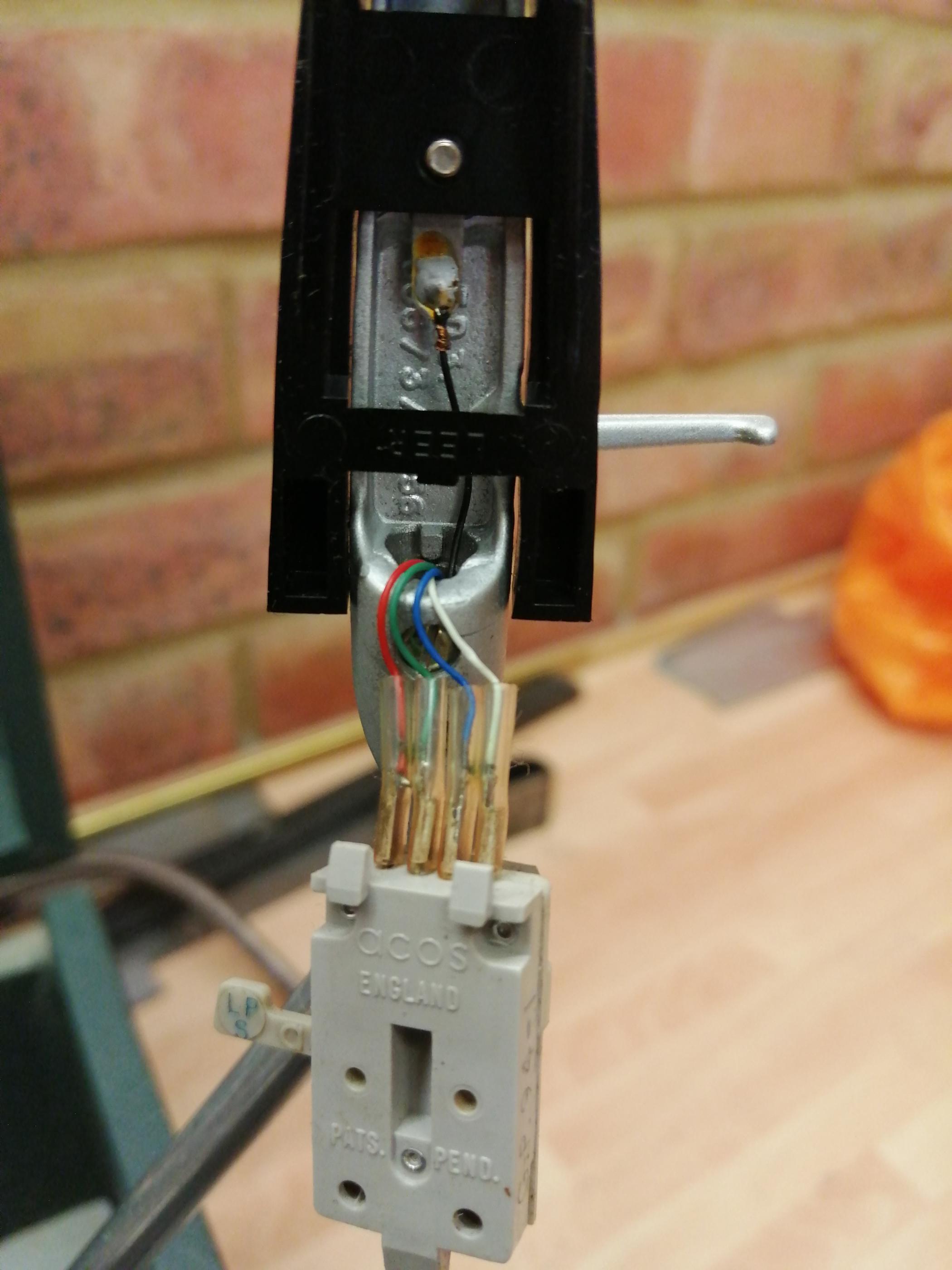

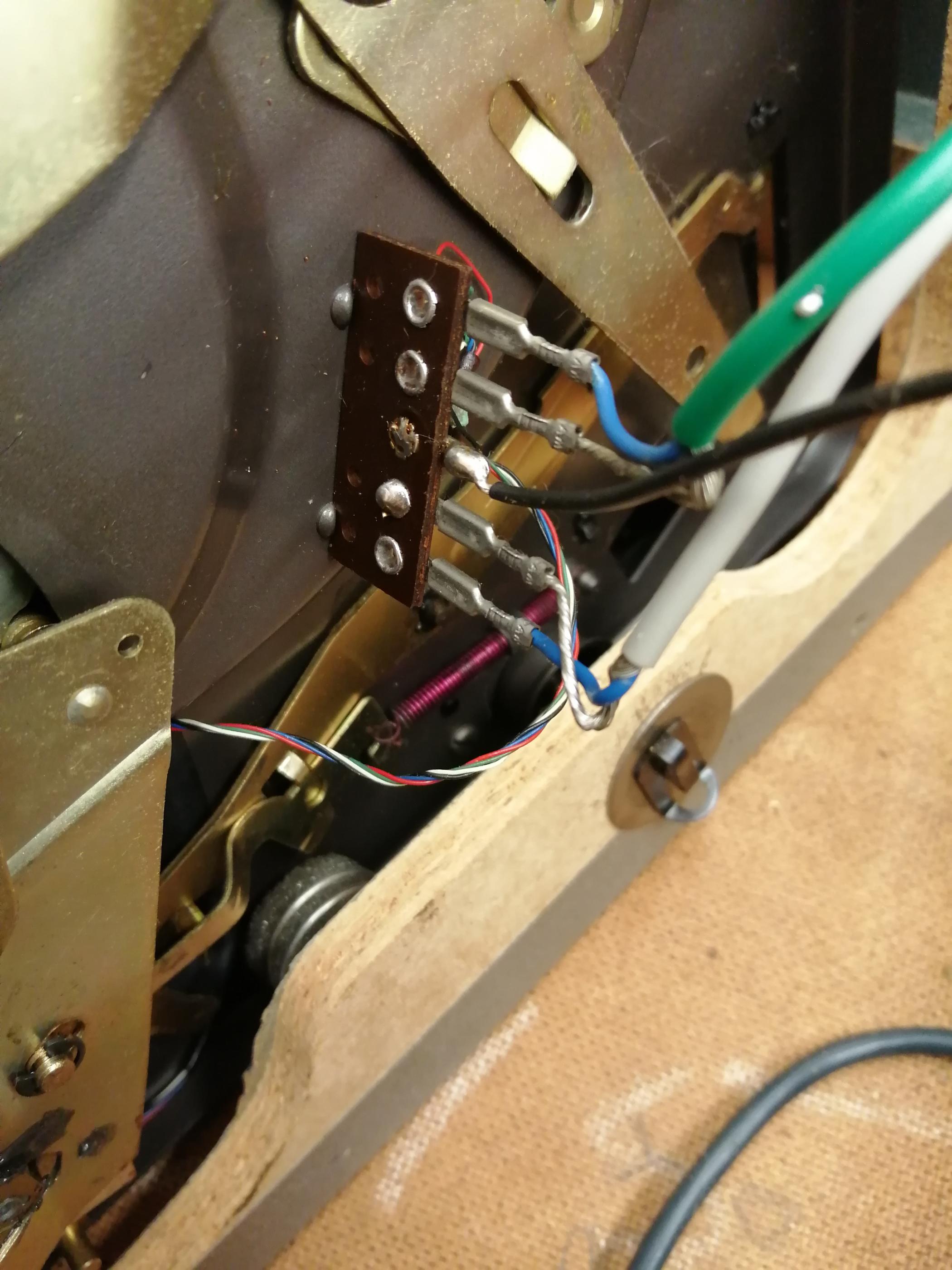

Please see the attached pictures.
I have tried disconnecting the wiring at the cartridge end, and at the connector on the underneath of the deck, but there was no change in the loud hum. I've also tried wiggling various things and tapping them, with still no change.
I guess the next thing is to try changing the capacitors as suggested.
Are the large ones in my pictures the only ones to replace (at first), and are they electrolytics?

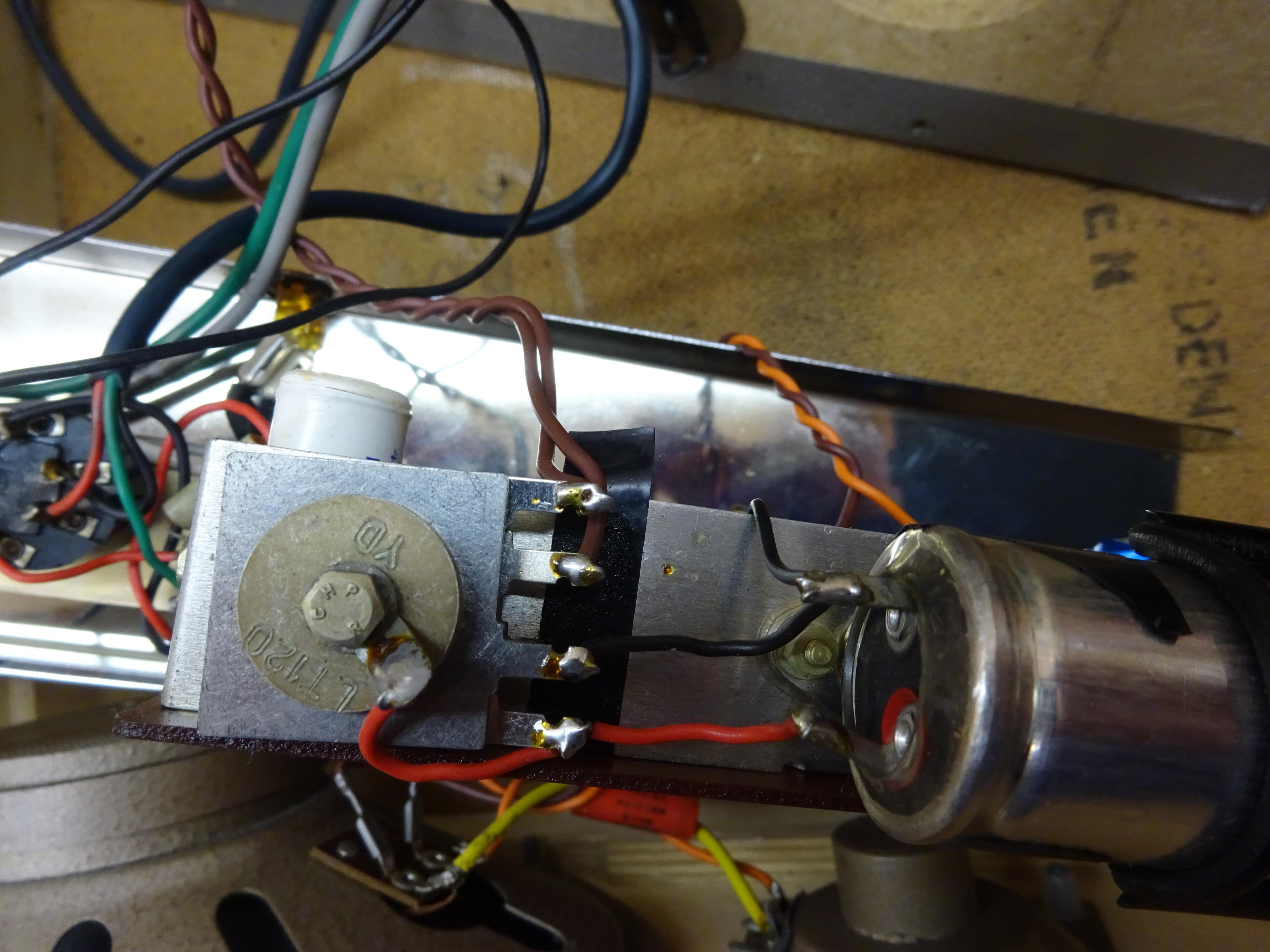

The selenium rectifier is the 'stacked plate' device situated to the left of the big 2000uF capacitor.
The brown wires carry the AC in and the black and red wires carry the DC out of the rectifier.
These age and become less effective. I agree that it is something to look at after replacing the capacitors.

Selenium rectifiers will fail eventually, so are best replaced as a matter of course.
Andy, would you consider that the smaller voltage drop of the replacement silicon rectifier would pose a problem in regards to producing a higher DC voltage in this circuit?
Rob, could you post pictures which clearly show the wiring to and from the selenium rectifier? Just want to make sure we put the right things in the right place!

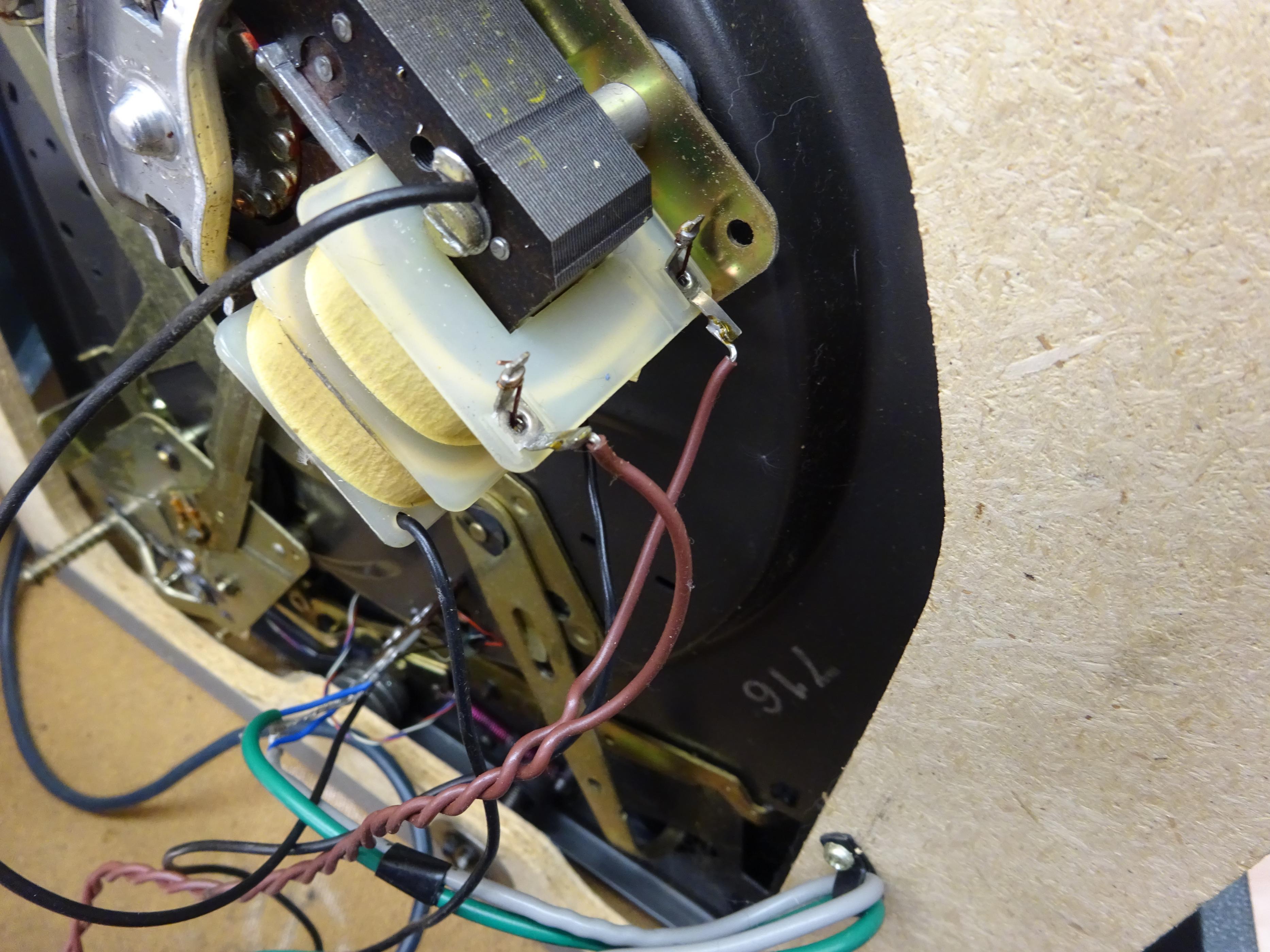

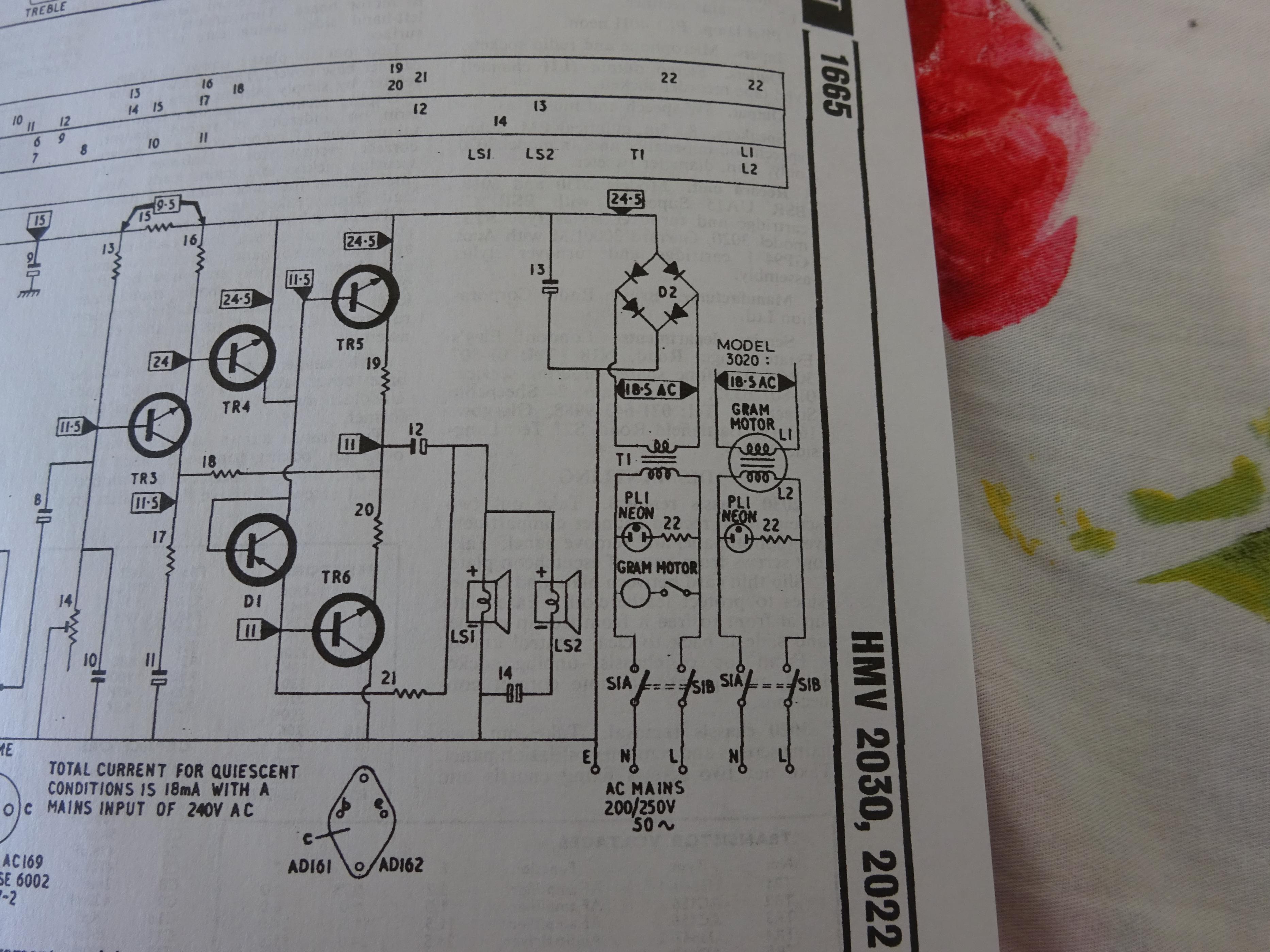

On the schematic its the wiring diagram on the far right that applies to my model (3020). Looks like they're using the motor as a transformer combined.

Hi.
Yes, they are using the motor as a transformer but this is not a problem. Just cost saving.
Any rectifier will do as long as it has a voltage of around 200v and around 3amps current capacity.

The bridge rectifier (I advise this type because you can simply bolt it in place) is wired as shown in the attachment.
i.e. The brown wires in your record player go to the AC terminals, the red wire to + and the black wire to -.
Remove the short length of red wire which currently connects to the mounting bolt of the selenium rectifier.
