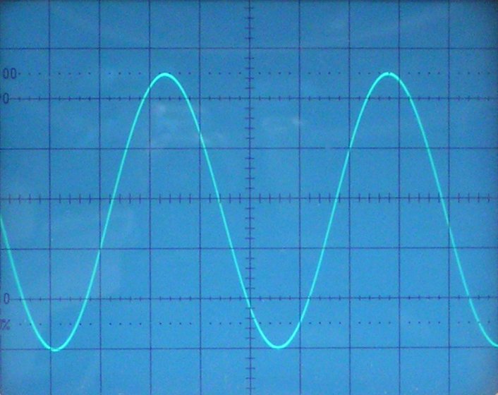

I haven't got suitable measuring equipment for measuring these low jitter levels. I attached an oscillogram of the produced sine wave signal of the simple 3-crystal version (11.2896 MHz / 5.5Vpp) at the input of the active element. Time division approx. 20ns / div. There is no visible jitter (very thin lines), at max. timebase setting (X10). The oscilloscope has a bandwidth of 60 MHz.
The actual output signal was shaped to have relatively fast positive going transients and relatively slow negative going transients in order to lower interference (square-wave with very fast transients creates a lot of unwanted side-bands).
The oscillator was designed for lowest possible frequency deviations at power supply voltage fluctuations between 5 and 8 volts (3V ripple).
The clock signal extraction and buffering circuit was designed to provide lowest possible frequency fluctuations at varying (capacitive) loads.
This resulted in a highly unusual design with up to 12 crystals.

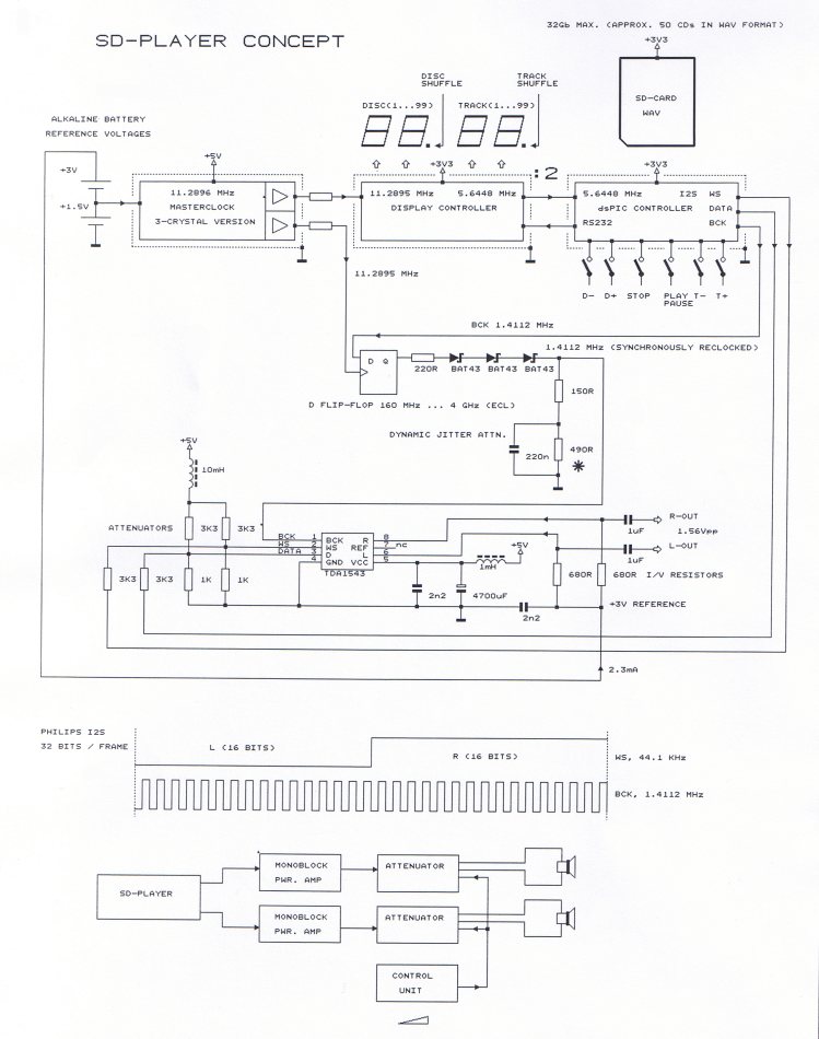

I attached a block diagram of the basic SD-card player. The master clock is a 3-crystal 11.2896 MHz version with 2 discrete clock buffers and an external battery reference voltage. This voltage is filtered and used for referencing the oscillator active element. One output drives the LED display controller, the prescaler on this controller feeds a 5.6448 MHz buffered clock to the main controller.
The display controller receives RS232 commands from the main controller to display required information.
The main controller reads the SD-card data and outputs I2S. It also scans the 6 keys that are used for CD, track selection, shuffle, start / pause and stop.
The 1.4112 MHz bit clock is then synchronously reclocked with a single high-speed D flip-flop (160 MHz ... 4 GHz), using the second master clock output. The clock signal is then fed to the DAC chip using a dynamic jitter attenuator circuit. It dynamically manipulates exact moment of triggering in order to achieve even lower sample timing jitter.
The other I2S signals (WS and DATA) are also attenuated in order to achieve lowest possible on-chip crosstalk.
The TDA1543 chip Vref pin is not connected (very important), an external reference voltage is used instead.
The timing diagram shows the I2S output signal.
The block diagram at the bottom shows how I connected the DAC, full output signal directly enters the power amp for achieving max. S/N ratio. The power distributed to the speakers is limited by a suitable attenuator. This greatly increases performance at lower volume settings that are most often used.

1) what is the function of the diodes in series with reclocked BCK? Don't they add noise?
2) is it OK to attach many I2S attenuators to one single choke? I guess BCK has to have it's own independent path...
3) doesn't the DC blocking cap form a too high HPF together with I/V R?
4) have you tried multiple series resistors (maybe SMD) on your DATA signal instead of one single 3K3?
Thanks in advance for the free lessons... 😀 :clown:
- Creating a suitable offset voltage of approx. 1.2V across 220nF. Without the diodes, the clock signal would partially discharge the 220nF cap, creating unwanted ripple voltage amplitude ( the diodes interrupt the bit clock signal below approx. 1.2V).
- The voltage drop across the Schottky diodes equals approx. 1.2V (3 x 0.4V). This is part of the requirement for correct bias level compensation.
- Schottky diodes produce almost no noise due to their specific properties.
- By placing 3 Schottky diodes in series, total capacitance is also reduced.
The circuit generates a DC bias voltage across 220nF, this voltage changes ever so slightly with bit clock duty cycle (jitter), thus changing the exact moment the TDA1543 triggers (and latches the outputs every 32 bit clock pulses). The time constant of the 220nF and 490R was tuned for lowest sample timing jitter and depends on application. The value of 499R depends on exact bit clock amplitude. The 220R series resistor is part of the attenuator that consists of 220 Ohm and 150 Ohm (the bit clock signal appears across the 150 Ohm resistor, 220nF is almost a short-circuit at these frequencies).
The effects of this circuit are similar to reducing master clock jitter amplitude. The circuit manipulates the exact moment the TDA1543 triggers (slightly earlier or later). This manipulation is done dynamically (duty cycle fluctuations result in bias voltage fluctuations), so it counter-acts jitter present on the bit clock (mainly the lower jitter frequency spectrum). This way the effects of the bit clock jitter can be compensated, leading to lower sample timing jitter (DAC output signal).
The choke is added to attenuate power supply noise. If you use multiple I2S attenuators (multiple DAC chips), it's best to use one choke for each chip.
BCK requires a separate circuit as crosstalk on this signal should be avoided.
This depends on connected load, I use a power amp with 47K input impedance (nothing else in between), with lower input impedances, the value of the coupling cap can be increased. I am still testing discrete buffer / amplifier circuits that may be included in the design.
I already tried this with previous designs like the DI4T, I still have to test what effect it has on this application. Multiple resistors in series increase inductance and reduce series capacitance. This may help to attenuate unwanted HF noise on I2S interface signals like WS and DATA.
The I2S signals also act as interference sources that usually flood the DAC chip with interference. That's why I use I2S attenuators / band limiters. These are dimensioned in a way that data integrity is maintained. By reducing I2S signal amplitude and reducing band width (causing less steep signal transients), on-chip ground-bounce at the I2S inputs can be greatly reduced. Now the DAC chip outputs less noise), and on-chip timing jitter level is reduced.
I get the whole idea... 😀
Does the dynamic jitter attenuator perform better than your last BCK attenuator with RL to VCC?
Sorry, I meant one single choke for both, DATA and WS from the same chip...as per your diagram.
Maybe for multiple chips (DI4M) I can make a "quatrifilar" choke?
...and that invention improves significantly the sound of this humble chip 😉 to a level no one could imagine...

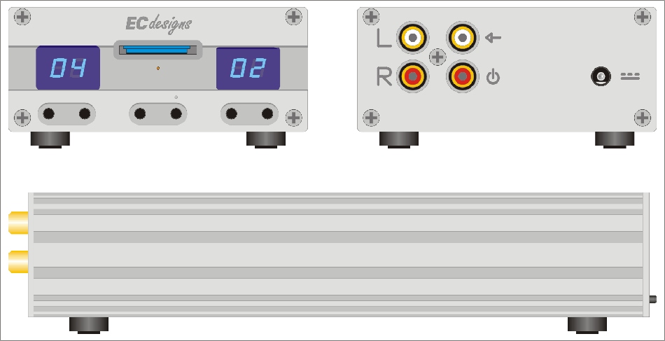

I attached a sketch of how the SD-player is going to look like. On the front panel there is a display for CD selection (left) and track selection (right). The small orange LED in the center is on during playing and flashes during pause.
The two keys on the left are for disk selection (- / +) the two on the right are for track selection (- / +).
The right center key (with a small indication) is the play / pause button. the key right next to it is the stop key.
Pressing either CD or track selection keys increments / decrements disk or track selection and stops the player.
The decimal point on both disk and track displays indicate disk and / or track shuffle mode. Shuffle mode is entered by pressing the (-) key when the readout shows 01, the decimal point now comes on and stays on when increasing disk / track number, or toggles on / off when keep pressing the (-) key at 01.
The player is designed to keep playing continuously, sequentially playing all disks and than start over again. When disk and / or track shuffle is selected, the player continuously plays random disks and / or tracks.
The SD-card is entered in the center slot, label facing upwards. The SD-card holder is a push / push version, so pushing the SD-card after insertion ejects it again.
If no SD-card is inserted the display shows (-- --). If the inserted card contains no valid WAV files, the display shows (00 00).
On the rear panel there are the analogue outputs (L and R), remote power on/off (controls relay that switched power supply), and remote control (RS232 receive-only) RCA sockets. Power is applied using an external DC power source (mains adapter), this is better for safety reasons, and both mains interference and transformer magnetic fields are kept away from the SD-player electronics.
The housing is a standard anodized aluminum housing that comes in various colors (silver, gold, red, green, blue and black). The housing measures 1.77" (45mm) x 4.27" (108mm) x 8.66" (220mm).
Both front and rear panels are made from 2.5mm thick anodized aluminum. They are CNC milled and engraved. The display windows are CNC milled from colored transparent plexiglass.
