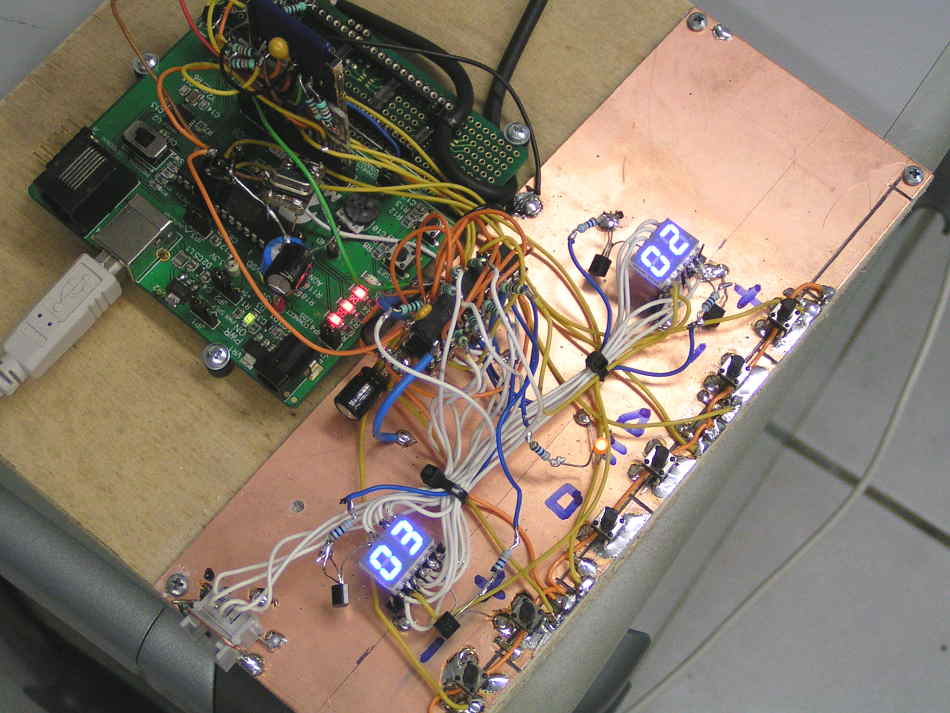

Hi EUVL,
The prototype now runs on a 2.8224 Mhz clock (derived from an extreme low jitter 11.2896 MHz master clock). The 1.4112 MHz DAC chip bit clock is derived from the DSP bit clock output that is synchronously reclocked by the master clock. Both DATA and WS are also synchronously reclocked with the master clock in order to ensure very low jitter on all I2S signals.
The master clock is a new development, it's a discrete circuit that unlike conventional crystal oscillators, is insensitive to power supply hoise / interference. This enables extreme low jitter amplitude and much flatter jitter frequency spectrum with practical power supplies. Most crystal oscillators produce highest jitter amplitude at lower frequencies, jitter amplitude will drop with increased jitter frequency. Unfortunately these lower jitter frequencies do have highest impact on sound quality.
Second problem is that the crystal oscillator performance will be degraded (sine wave distorts) when loads are connected. This is mainly caused by the fact that the load (clock buffer for example) is connected to the same circuit that maintains oscillation, the slightest crosstalk through the connected load will result in a distorted sine wave and increased timing jitter. Clock buffers can't prevent this effect (stray capacitance between both input and output).
The new master clock has two separate and identical circuits, one maintains oscillation and is not connected to the load. The other (also connected to the crystal) drives the load. Transformer-coupled output is used to produce a balanced output and provide galvanic insulation from the crystal oscillator.
The SD-card player prototype setup is now fully operational, and listening tests with the new master clock have already been performed.
The SD-card player now automatically detects and supports SD / SDHC memory cards, and should be able to support up to 32Gb cards.
Data transfer speed between SD-card and RAM buffer was further optimized / increased, providing very large margin for error (SD-card latency). Many different SD-card capacities and brands were tested, and all SD-cards (except for the very slow versions without speed rating) work excellent. In general, all SD / SDHC cards with speed rating of 2 and higher will do fine.
The SD / SDHC card must be formatted with FAT32, it's best to re-format new cards using a suitable card reader and OS.
After the SD-card has been inserted, the player will scan for directories (CDs), and WAV files within each directory (tracks).
The directory names should be preceded by a 2-digit number, same applies for the track names. The player can skip "missing" CD or track numbers, so when the directory names start with 01, 02, 40, 52, the corresponding disk numbers will appear on the display.
I attached a photograph of the SD-card player test setup. The left display indicates the disc number (up to 99), the right display indicates the track number (up to 99). The decimal point indicates disc and / or track shuffle mode.
There are two keys (-) and (+) for each display, these are used to select CD, track and shuffle. The remaining 2 keys are (stop) and (start / pause).
The keys are connected to the DSP (located on the upper PCB), and the displays are connected to a second micro controller that receives RS232 commands (single wire) from the DSP. This way DSP load (and interference) is minimized.
The prototype on the picture runs on a 5V USB power supply, and still had the conventional crystal oscillator.

Hi luxury54
yes, the player accepts SD, SDHC, and micro SD(HC) with an adapter.
The player uses a smart algorithm to initialize and automatically detect cards of different type and capacity.
The memory card speed rating needs to be 2 or higher. Cards with no speed rating might still work (depends on brand).
It's important to format the memory cards properly prior to writing the WAV files on it, pre-formatted cards usually don't work and need to be re-formatted.
Some SD cards (4Gb) may need to be formatted with FAT16 for correct operation. In general FAT32 can be used, this is required for card capacity of 8Gbytes and higher.
We tested many different brands and capacities varying from 2 to 8 Gbytes. The player should be able to support up to 32Gb memory cards. We are still waiting for 64Gb card specs, and support of these cards will be added later (firmware upgrade).
I attached a picture of some SD-cards we tested, the only one that failed was the 2Gb Verbatim, but it had no speed rating.
