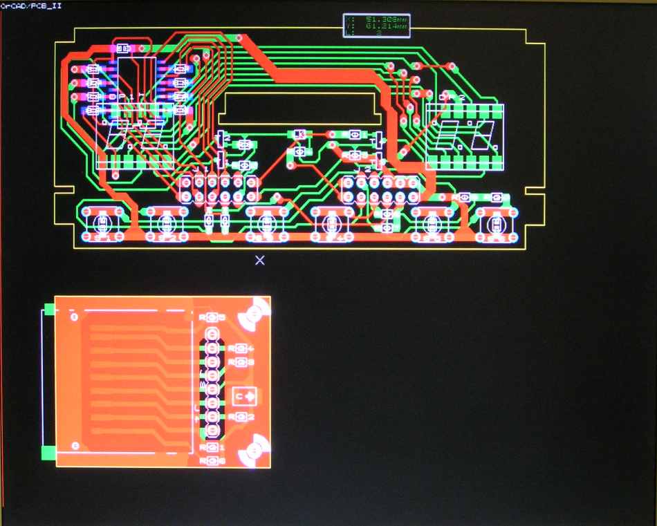

Main objective was designing a digital audio source that eliminates major drawbacks of conventional digital audio sources, thus providing much better digital audio playback quality. Other advantage is the possible construction of small portable audiophile players, running on batteries.
Both front panel PCB and SD-card PCB design have been completed. I attached a screen shot of the design.
The front panel PCB is tailor-made to the standard aluminum housing. It contains 2 blue LED displays (SMD), one orange LED for play / pause indication, segment / digit buffers, and keys.
In the center there is a slot for the replaceable SD-card holder module (lower PCB). The front panel PCB is directly soldered to the main PCB under a 90 degree angle, using double-row pin headers. The SD-card holder module is mounted to the main board using brass hexagonal spacers.
Main board schematics are almost completed.
We also performed some more comparisons with conventional digital audio sources. These appear to be unable to achieve SD-player performance, regardless of DAC chip, reclocker, analogue stages, digital audio interface or power supply.
Note that the SD-card prototype runs on a cheap mains adapter only, power consumption while playing is around 3.5 watts. Required minimum input voltage equals approx. 7 ... 8 volts. All circuits (including the 3-crystal super clock) run on either 3.3 or 5V.
We also fixed two minor software bugs that were discovered during extensive testing. Player now appears to perform rock-solid, card type or brand are not critical, as long as the SD-cards aren't exceptionally slow like some of the first 128 or 256Mb cards. In general SD-card speed rating of 2 or higher works excellent.

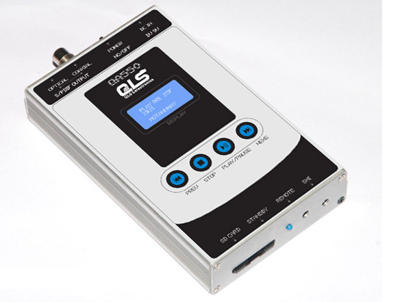

I got some information of QA-550 SD Card WAV player!
It is a similar concept like that of ECdesign. But there are some differences:
It has just S/PDIF outputs (optical/coaxial) and can be steered by a remote. It has a display and can be powered by battery. It has no analog outputs.
Cost: 51 € or ~70$ which is a bargain if sonically good!
Problem is - how well implemented is this SD reader compared to ECdesigns?:
- it doesn't have a built-in DAC so not as tightly controlled & implemented as ecdesigns seems to be
- clock implementation is a big deciding factor in the delivery of great sound
- 2 ppm clock (QA-550) means nothing without specifying the measurement freq (ecdesigns - what clock(s) are you using & what phase noise?)

QA-550 SD Card Player
I think you might be missing the point of the exercise.
If you just want a player without any mechanical drive, there are many to choose from -- any MP3 player (some even support WAV or FLAC), Squeezebox, TEAC WAP2200, any modern laptop with SPDIF output ......
They ALL have one problem -- SPDIF. Then you end up with the well known receiver problem of matching the DAC clock to the source, and getting rid of source jitter. There are tons of way to do so, but apparently the Sabre seems to be particularly good.
What Koon & John have done is to avoid this problem in the first place by using the same clock to drive both DAC and digital source, like in a normal CD player, but to remove the mechanics. There are people who have done similar things before in commecial products. If I am not wrong, Meridian used to have a player which read CD multiple times until error free, and put the data into a memory buffer and played from there.
I would have also liked to believe the QA550 would do the same job.
Pay the 50 Euros, feed it to the Sabre. Done.... That still is one viable, probably very good solution.
What is posted here is John, and to an extent earlier by Koon, is something else. And John has explained it in detail multiple times. You just need to read carefully, and understand.
