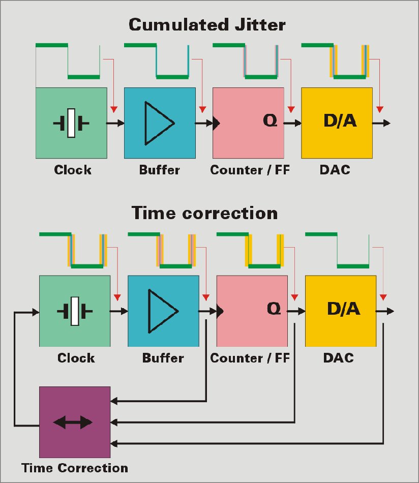

Your implementation of the clock signal distribution is interesting BUT I still think that you need to check the jitter at the DAC in order to prove that you have achieved your goal.
Hi jkeny,
I attached a block diagram that may clarify the problem (cumulated jitter) and a possible solution (time correction). Best comparison would be that of feedback in an analogue circuit
I have been trying to say that sample timing jitter (DAC output) is most important parameter, low master clock jitter alone is not the solution (top block diagram). So inserting a low jitter master clock is fine, but basically provides only marginal improvement since DAC jitter contribution is usually much higher as that of the master clock, followed by flip-flops / counters and clock buffers.
Sample timing jitter (DAC output / during D/A conversion) translates to audible digital artifacts, by using selected highly critical test tracks, the effects of sample timing jitter can be magnified. Without time correction these digital artifacts remain audible. With the time correction enabled, these audible digital artifacts vanish completely.
Measuring these extreme low jitter levels is difficult (here it can only be measured at a NOS DAC unfiltered output using a suitable test signal). Modern DACs are problematic as they don't provide a suitable feedback signal (integrated switched-capacitor filters). Connecting a test probe already affects measurement too (capacitive load + introduced ground loop).
OK, you've mentioned a number of jitter reducing techniques:
In order to maintain low (bit) clock jitter levels at the DAC chip internal circuits, I attenuate the master clock amplitude to approx. 400mV, and create a low load impedance (approx. 33 Ohm), this is possible with both TDA1543 / TDA1541A as these have TTL-compatible current steering inputs.
The 1.4112 MHz bit clock is then synchronously reclocked with a single high-speed D flip-flop (160 MHz ... 4 GHz), using the second master clock output. The clock signal is then fed to the DAC chip using a dynamic jitter attenuator circuit. It dynamically manipulates exact moment of triggering in order to achieve even lower sample timing jitter.
- Is the time correction you now mention actually the same as the dynamic jitter attenuator?
- Can this only be done with the TDA DACs or is it applicable to others?
- Can you say what test tracks show up timing jitter clearly?
- I'm not trying to be critical here but you're very aware, I know, that changes in how a track sounds do not necessarily mean lower jitter. The sound of jitter is very elusive - are you using the test tracks from here?: http://hddaudio.net/?p=393

It seems your circuit goes beyond Henk's in that yours dynamically adjusts the timing - can you tell me the details of how this works i.e for a late BCK signal, how does the I2S circuit work to deliver this on-time?
Does it work something like: the 1.2V bias voltage moves slightly with the jitter (BCK duty cycle) & this moves the pos & neg firing point of BCK, advancing or retarding it? The trick being to get the exact correct adjustment or it introduces more jitter. How sensitive is this circuit to thermal or other drifts?
