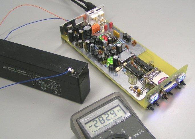

By now I built a number of the redesigned PCBs for mainboard, SD-card module, and 3-crystal masterclock.
Modifications on the mainboard:
- Controller power supply decoupling pins were disconnected from 3V3 and decoupling capacitor value was increased.
- Traces from main controller to SD-card were made shorter in order to guarantee most reliable operation and minimize interference.
- Ground plane surface was slightly increased.
- Capacitors were placed on controller reset inputs.
- PCB outline was changed for easy front panel alignment.
Modifications on the SD-card PCB:
- PCB length was increased by 1mm for better fit in the standard housing.
- Pull-up resistor was added for card detect.
- SD-card illumination (for use under dim lighting conditions) was added.
Modifications 3-crystal master clock:
- PCB was re-designed for HC49 /4H crystals.
- Amplitude stabilization circuit was added.
- Power on the crystals was further reduced (oscillator now draws approx. 1 ... 2mA without load).
- Screen was added.
I also tested the SD-player on battery power supplies (12V lead-acid and 9V Alkaline D-cells), works fine, player draws approx. 280mA. I added a photograph of a SD-player running on a 12V / 2Ah lead-acid battery, the multimeter shows current consumption.

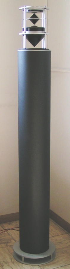

Hi lor.e.s
The sonic resonators I refer to are omni-directional speakers (point source), the cones were part of the tweeter / midrange construction, but aluminum turned out to be unsuitable (poor sonic properties) for these parts. I now use either wood or acetal copolymer for these parts. I attached a photograph of this sonic resonator / speaker.
The SD-player is a semiconductor-memory based device, so all problems related to mechanical digital audio sources (CD, SACD, DVD, and Blu Ray) like resonances, CD pit / land induced jitter, servo noise, unwanted laser beam reflections, laser pick-up aging, read errors, and servo electronics interference, simply don't exist 🙂
The SD-player doesn't seem to be sensitive to resonances (no moving parts, carefully selected components).
The wood might have dielectric effects (PCB traces are pressed against the wood), but wood resonates too. It might also be just a good excuse to offer the DAC without housing 🙂
