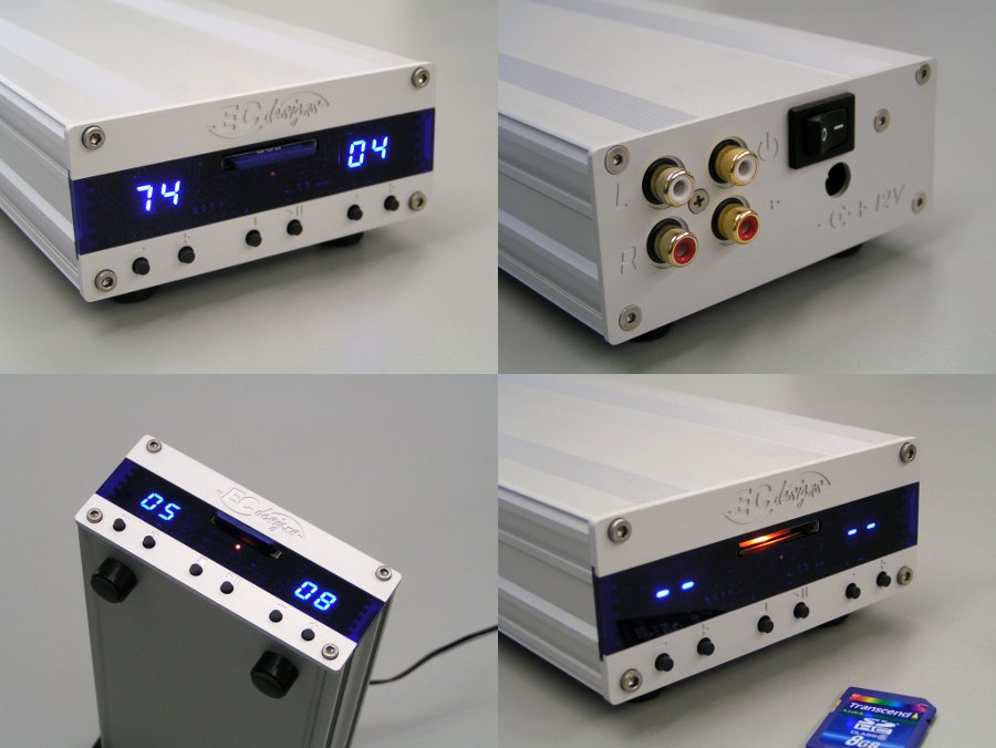

Well we did some diy anodizing of SD-player aluminum parts last weekend. never done this, so first attempt resulted in dark gray stains (we didn't use distilled water during sealing). Next attempt succeeded, the results are on the attached picture.
With some more practice it should be possible to color the aluminum parts if desired.
Top left, the SD-player being tested with disk number 74, track 4. I followed a333bt's advice and added symbols for the keys. Both symbols and logo are engraved (0.6mm deep) in the 3mm thick aluminum panels. Allen screws are A2 stainless.
Top right, rear panel, again all symbols are engraved in a 2mm thick aluminum plate. There are 4 RCA connections. L and R audio outputs, remote power on (white socket near the power switch), and a RS232 input (red socket). The SD-player is designed to run on external DC power sources from 8 ... 12VDC, including cheap mains adapters, batteries or even solar cells.
The rear panel is fixated to the PCB assembly through the philips screw in the center of the RCA block. The other screw hold a 7805 regulator for the segment buffer, and also connects the housing to GND.
Bottom left, a view of the feet. These are CNC milled from acetal copolymer (POM) and then turned to get a smooth finish. In order to avoid scratches and slipping, small 3mm thick neoprene rubber disks were glued inside the feet. The feet are fixated from the inside of the housing (counter-sunk M3 screws).
Bottom right, no SD-card inserted, the SD-player shows -- --. The SD-card bay is illuminated by a small SMD LED to aid SD-card insertion under dim lighting conditions.

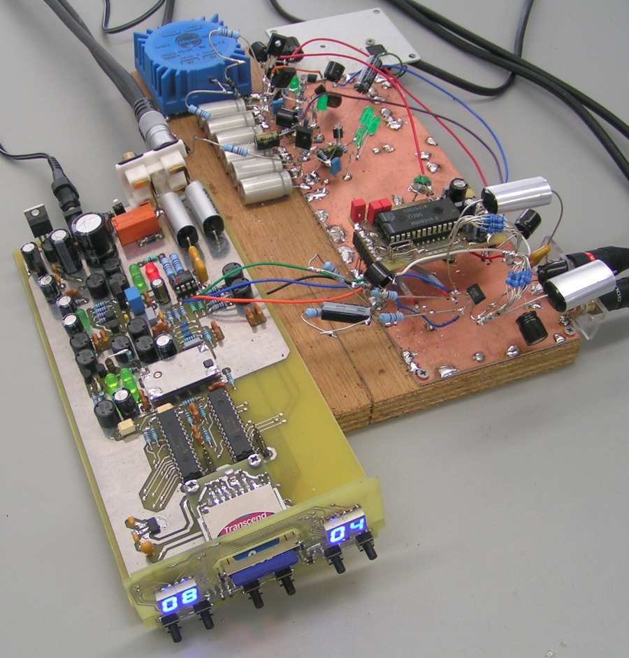

Yesterday I got curious and built a TDA1541A setup using LED referenced series regulators for +5V, -5V, and -15V. New output circuit was used (single-JFET) with biased passive I/V conversion, producing exactly the same output amplitude as the SD-player (1.56Vpp). Same output coupling caps were used and output impedance was matched. I have selected these output coupling caps after testing many, I used V-cap TFTF as reference.
The DEM clock was tuned to sync with the bit clock (1.4112 MHz) using both a 47pF polystyrene capacitor and a 33pF trimmer.
The TDA1541A DAC I2S inputs were connected in parallel with the TDA1543 I2S inputs (this shows how easily one could connect a TDA1541A to the existing SD-player).
The sound quality of both DACs matches closely, subtle differences can only be detected by direct comparison and using different music material. I can't say what DAC chip performs best, I think it's more a personal taste now.

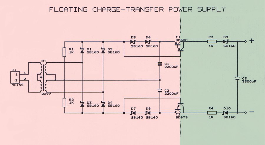

Hi maxlorenz,
That reminds me, John, does your SDP have the famous floating CT supply?
If not, do you think it can improve the player's performance?
The SD-player uses an external DC power supply (8 ... 12V), so many possible options here.
Until now I was using a cheap $4 mains adapter, this is worst-case scenario. I am confident that the SD-player will perform better on a floating CT power supply.
For those who are not familiar with the floating CT power supply. This type of power supply creates a high resistance between both transformer secondary and connected load by means of transferring charge between electrolytic capacitors using transistor or MOSFET switches.
I attached a schematic of such a floating CT power supply. T1 and T2 are electronic switches that are controlled by a 100 or 120 Hz switching signal, derived from the mains frequency.
Both C1 and C2 are charged the usual way, when no charge current flows (D1 ... D4 no longer conduct), both transistors are switched-on, transferring the charge stored in C1 and C2 to the capacitor C3. When C1 and C2 are being charged again, the transistors switch-off, keeping C3 isolated from the primary.
The red area indicates mains polluted circuit, the green area indicates the part of the circuit that's isolated from the mains interference.
The circuit isn't perfect, parasitic capacitances (diodes and transistors) still pass some unwanted RF energy.
