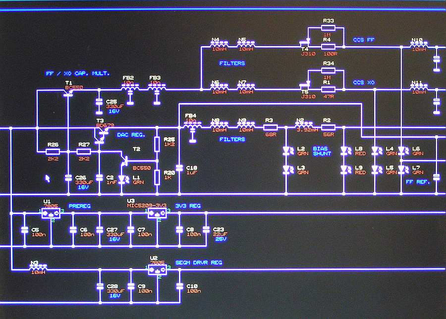

Hi soundcheck,
The SD-player needs the following separate power supplies, each with specific properties:
5V series regulator for display segment buffer.
5V series pre regulator for feeding the ultra low noise 3.3V LDO regulator.
3.3V ultra low noise LDO regulator for both processors and SD-card.
5.2V LED-referenced ultra low noise series regulator for feeding DAC chip, I2S attenuators, and Vref circuit.
3.2V cascaded LED shunt regulator for Vref (passive I/V conversion).
4V 80mW ultra low noise constant power regulator for the master clock.
4V 40mW ultra low noise constant power regulator for synchronous reclocker.
2V ultra low noise reference voltage for synchronous reclocker.
When using a 6V battery, there is also too little margin for regulation, I need at least 2 ... 3V margin.
Even when using a battery power supply, separate voltage regulators are still required to isolate sub-circuits (minimize crosstalk between circuits), minimize noise, and provide required specific regulator properties like the constant power regulators.
I attached a screen-shot of the early SD-player voltage regulator schematics to illustrate this.

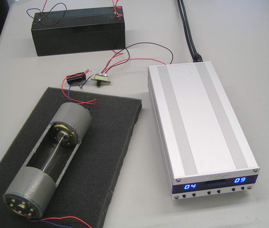

DC generator test - zero coupling capacitance
Hi plep,
When using conventional mains power supplies, there is always the coupling capacitance between both primary and secondary transformer windings. No regulator or smoothing cap can do anything about this, and the related effects on sound quality remain.
What basically happens is that both GND and plus are connected directly to the polluted mains voltage by a capacitor (coupling capacitance between transformer primary and secondary windings). This impedance is low enough to pass unwanted HF interference between interconnected mains-powered audio equipment.
Yesterday I did an interesting experiment. I attempted to completely eliminate this coupling capacitance by using a small DC motor / generator combination. I used 2 identical 12V DC motors, one is used as motor, the other as generator.
The motor was fed by a small mains adapter, both motor and generator were mounted in a plastic tube (insulator). Both motor and generator axes were coupled by using a 7 cm long clear plastic tube (insulator). This creates an approx. 6 cm wide insulated barrier between both motor and generator metal parts (axis inclusive), obtaining virtually zero coupling capacitance between both mains adapter and connected load.
The generator output only needs to be smoothened a bit using a 1000uF electrolytic capacitor, note that the polarity is reversed (red wire minus, blue wire plus). No rectifier diodes are needed as the generator has a collector. The motor red wire is connected to plus, the blue wire to minus of the 12V mains adapter.
The motor / generator combination very closely matched two fully charged twin lead-acid batteries in parallel !
This experiment basically shows that the capacitive coupling with the mains (conventional mains power supplies) is quite problematic for audiophile equipment sound quality.
I attached a photograph of this test setup, In this picture, the switch connects the generator to the SD-player.

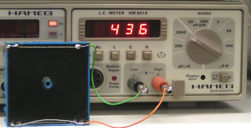

So, in that aspect it is better to use R core or similar transformer, right? ...as primary and secondary windings are separated... (I mean C core; EI...)
Hi maxlorenz,
Separating the windings doesn't mean that there is no coupling capacitance between both windings. First the windings are located side by side, creating a capacitance between both. Each winding also sits on an iron core, creating a capacitance between winding and this iron core material.
The end effect is that you have two capacitances in series (primary - core - secondary), and one more in parallel (primary - secondary). The capacitance is formed by the copper masses in both windings, coil formers, and iron core material. The other capacitance is formed by the copper masses of both windings and insulation between these.
In practice the coupling capacitance (depending on transformer properties) can vary between a few hundred pF up to a few nF.
This capacitance can be measured by short-circuiting all primary winding contacts, and shorting all secondary winding contacts (no short circuit between primary and secondary). Now connect a capacitance meter between both the primary and secondary connections. I use a Hameg LC meter for this purpose. I attached a photograph showing the capacitance between both primary and secondary windings of a toroidal transformer, reading is in pF, so this transformer has approx. 436 pF between both primary and secondary windings.
The motor / generator configuration has a 6 cm gap (plastic insulator) between both motors, and the surface area of the metal parts that are closest together is very small (thin axis). In order to achieve similar with a transformer, one would need an air gap of over 10 cm!
When doing so, the transformer will no longer function, the impedance goes down, and efficiency would be very low.
As far as I know, it's not possible to achieve zero coupling capacitance, using regular mains transformers, regardless of type and brand. In practice the coupling capacitance must be virtually zero in order to match battery power supply (floating power supply) performance.
The floating CT supply can reduce coupling capacitance to a few pF, and does improve things, but semiconductor properties (capacitance) still prevent required zero coupling capacitance.
The trick is to construct a mains power supply that has virtually zero coupling capacitance, one practical application that works is the motor-generator configuration. I am still trying to figure out a way that doesn't require moving parts. Until then, the battery power supply is the most practical option.
