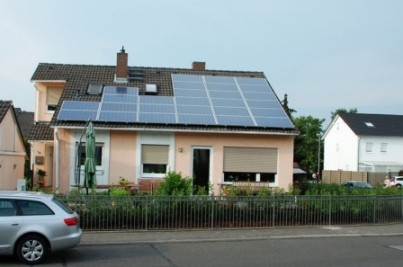

Re: photovoltaic cell
As I do already 😎
on a serious note, EC, did you try the difference between placing the 6x10uF close to the battery and close to the PCB ?
dukekiong said:you can try using photovoltaic cell.
place it in the sun for a green solution.
As I do already 😎
