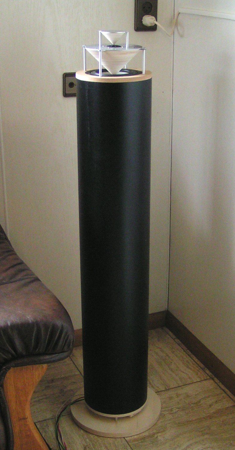

The speakers (sonic resonators) I have been using for testing are 3-way systems. It now turns out that it's very difficult to keep 3 speakers under control, and achieving correct phase response (crossover regions).
Two way systems can offer cleaner sound, but often bass response is limited. Full range speakers suffer from too high moving mass and doppler distortion (one speaker cone producing two different frequencies simultaneously).
So I finally settled for a semi 2-way sonic resonator, using a 130mm bass / midrange and a titanium / aluminum alloy speaker chassis. Omnidirectional emission was achieved by fixating CNC milled wooden cones above each speaker (both fire upwards now).
The sonic resonator is driven by the 130mm woofer/midrange chassis. The sonic resonator is built around a 170mm subwoofer / corrector. This subwoofer is acoustically driven (not connected to the power amplifier).
The new sonic resonator is slightly higher than 1 meter, and diameter of the tube equals 20cm. Both, all-FET bridge amp and this new sonic resonator finally revealed what the SD-player is capable off.
I attached a photograph of a test setup of this new sonic resonator prototype. The filter is located external for testing, it will be integrated later.
Based on this, there is no need to further modify the SD-player design, it already performs beyond expectation. so I plan to start-up a small batch soon.

Your speakers look very elegant. Are you planning to market them or make DIY information available in the future?

Hi EC
He is selling them since years . 😀
