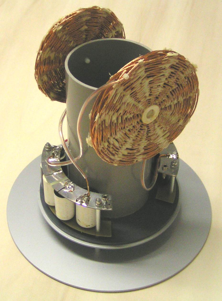

Project update,
I spent a lot of time optimizing and redesigning my audio set in order to achieve sufficient resolution to further improve the SD-player.
Power amp performance was improved by adding miniature honeycomb chokes for improved performance of both input and driver stage.

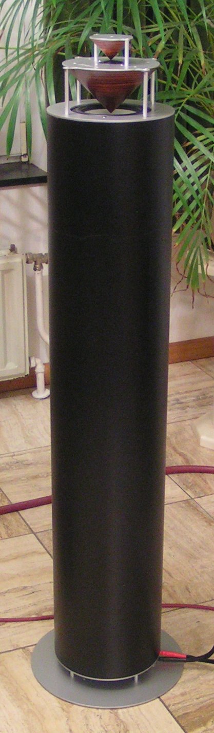

I also had to redesign my sonic resonators, using a semi 2-way system. The passive crossover filter was optimized using hybrid capacitors, I used a V-cap TFTF as reference and managed to get much higher resolution using the hybrid caps. The idea is to minimize material resonances in each cap by reducing power dissipation in each cap, and to enable combining specific properties of capacitors.

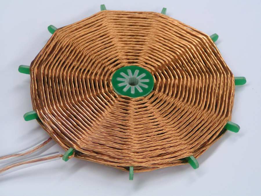

After testing a lot of chokes, I used planar honeycomb chokes with high Q factor and low stray capacitance. Stray capacitance of chokes can cause unwanted trebles roll-off (unwanted stray capacitance in parallel with the tweeter) and short-circuit of the power amp at specific frequencies (stray low pass filter choke capacitance in series with low pass filter capacitor). The low-pass filter choke stray capacitance can cause power amp instability and unwanted oscillations.
I added a photograph of the new passive crossover filter prototype. The planar honeycomb chokes were made using a removable frame and were fixated using construction glue. The wire is litz wire (multiple insulated strands). The next photograph shows the completed sonic resonator.
After improving the audio set I was able to further increase SD-player performance. The following modifications were made:
- I/V resistors were changed to non-inductive wire wound resistors using honeycomb choke construction in order to minimize stray capacitance. Wire length for each resistor equals 6.8 meters. This had tremendous impact on sound quality. I added a photograph of these non-inductive wire wound honeycomb resistors. They are wound on a CNC milled frame of PCB material with a plastic 5mm high spacer in the center.
- Power supply filtering was improved using hybrid chokes consisting of multiple ferrite beads, a miniature 150uH honeycomb choke, and multiple 2.2mH chokes in series. The idea was achieving lowest possible stray capacitance, thus creating a true "open loop" power supply by maximizing series impedance. I added a photograph that shows both a honeycomb choke and a spiderweb choke for the master clock power supply. The spiderweb choke will be replaced with a honeycomb choke later.
The filters aren't only intended for mains powered operation, the effect on sound quality also applies for battery power supply. Battery power supply provides best clarity, transparency, and resolution.
With the complete audio set tuned, and the SD-player improvements, the sound quality has improved way beyond expectation. I never imagined that plain 16 bit recordings could hold such detail and transparency. Key factor turned out to be resolution.

Oh, a new secret weapon: honeycombs. 😉
Bees knows that since primitive times! 😀
Looks very unique.
Looks very unique.
That's why I run by"bees" on the battery power rails. 😀
looks impressive ecd, but I cant help to wonder if those big discs of copper would pick up more EMF or radiate some?
Also, I'm going to make a pair of omnis my self. Settled for the 90 degree disperser as there is no difference between that and a parabolic and it's much easier to make.
Do you know if the surface of the deflector impacts the sound or dispersion in any way?

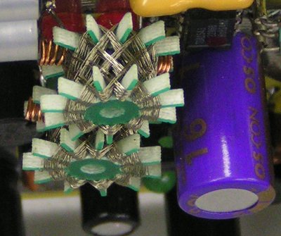

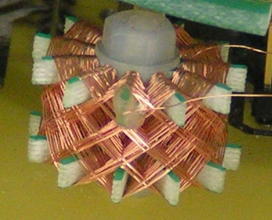

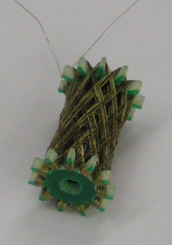

Honeycomb chokes are less "mysterious". It's a winding technique that increases the distance between wires that run in parallel, and minimizes the surface area where the wires touch. This results in much lower stray capacitance between the choke terminals compared to conventional chokes where all wires touch over a much larger surface area.
In short, it's a choke that offers low stray capacitance.
Here is an explanation where and why I used them in my audio set:
1) Wire wound passive I/V resistors.
I use wire wound I/V resistors to achieve low noise levels. But with common non-inductive winding techniques, stray capacitance is rather high as the wires touch over a large surface area. I used the honey comb winding method in combination with non-inductive winding (mobius loop) by running two wires side by side with one peg offset. The result is a very low noise, non-inductive resistor with low stray capacitance. I use a different approach to brickwall filtering by maintaining relatively large bandwidth signal throughout the audio set right up to the speaker chassis.

The winding pattern can be further optimized by preventing exact alignment of subsequent windings. This however requires either a computer-controlled winding machine, or a lot of patience.
My prototype chokes and I/V resistors were wound by skipping 5 pegs and looping the wire around one peg instead of two.
The choke diameter equals 2cm, and it's 9mm high. The PCB material is 2mm epoxy, and the pegs are 0.5mm wide and 2mm high. I didn't have a machine to wind these yet, this results in approx. 2 hours of hand-winding for each choke. I used 0.1mm thick lacquered copper wire, DC resistance of the completed choke is around 20 Ohms.
The I/V resistors (680 Ohms) were made using resistance wire (100 Ohms / meter) and a non-inductive honeycomb winding pattern. This is done by running two wires in parallel, with one peg spacing, creating a mobius loop.
I added a close-up of a miniature honeycomb choke for reference.
2) Additional filtering of highly critical power supplies in the SD-player (masterclock, reclocker, and DAC chip). The honeycomb chokes with low stray capacitance do a better job of rejecting HF interference (noise) because of the higher impedance at these frequencies.
3) Increasing impedance for blocking HF (noise) in the bridge power amplifier input and driver stages.
4) Reducing stray capacitance of chokes in the passive crossover filters. Just look at a speaker crossover filter and imagine there is a capacitor (1 ... 10nF for example) in parallel with each choke. The following things might happen now:
- Power amplifier output is short-circuit at specific frequency range. High-pass choke stray capacitance in series with high-pass capacitor, and low pass choke stray capacitance in series with low pass capacitor.
- The tweeter is short-circuit at specific frequency range instead of receiving full power (high-pass).
This could very well lead to power amplifier instabilities (oscillations) and increased distortion at higher power levels.
Honeycomb chokes can be home-made with some effort, so they can be constructed at minimum cost, just a frame, some (stranded) lacquered copper wire, and some patience 🙂
Construction of a honeycomb choke requires a frame with an odd number of pegs (I used 11 pegs). The frame must be rigid, and the pegs must not be allowed to bend as a result of wire tension.
So for larger chokes, steel pins need to be used for the pegs in order to minimize bending. Since these steel pins cannot stay in the completed choke, they must be removed after fixating the choke. So the frame must be constructed in such way that it can be removed afterwards. I used steel pins covered with teflon tube for easy removal after fixating the choke with glue or lacquer.
The smaller chokes can have frames made of cheap PCB material (glass fiber enforced epoxy), and a plastic 5mm spacer. These can stay in the choke after completion.
Here is some information about construction of honeycomb, spider web and star chokes, use google translate:
http://www.jogis-roehrenbude.de/Spulenwickeln.htm
http://www.jogis-roehrenbude.de/Leserbriefe/Neumann.htm
http://www.jogis-roehrenbude.de/Leserbriefe/Schlemm-Wickelmaschine/Korbspulen.htm

Hi maxlorenz,
Constructing a non-inductive (mobius loop) resistor with honeycomb winding pattern is rather difficult. The insulated constantine wire has a diameter of approx. 0.1mm and it tends to curl-up and get entangled very easily, rendering it useless. It requires a 2-chamber coil former to hold the thin wires during winding.
Since a mobius loop has to be made, one has to start at the center of the wire, meaning you fixate the center of the wire to the frame, and wind each wire on a separate part of the dual coil former. Two wires of 0.1mm must then be wound simultaneous on the frame with a spacing of 1 spoke.
You need to count the skipped spokes without making any error, especially until the first complete honeycomb pattern is formed. Then one can use the existing wire location for easier reference. With the final I/V resistor construction (19mm high and 12mm diameter holding 6.8 meters of wire) I skipped 7 spokes with 1 spoke offset.
The I/V resistor is wound on a frame consisting of two small CNC-milled PCBs (2mm thick) and a 15mm high plastic spacer. I attached a photograph of this latest I/V resistor, it's 680 Ohms and there are fewer turns compared to the previous version. Because of tolerances in wire alignment caused by the increased resistor hight, self capacitance is further reduced.
The lead wires connect straight to the circuit in order to prevent adding extra solder joints. This I/V resistor offers very high resolution, way better than the bulk metal foils or copper wire I/V resistors that had too high self capacitance.
I also made a different construction for the SR60 crossover chokes. I use 11 CNC-milled spokes and two CNC-milled PCB disks that are then clamped together to form a non-removable frame. It requires quite some force (hammer) to lock each part firmly into position, tolerances are chosen such way that the frame is self supporting without requiring any glue.
The home made litz wire (I use 7 x 0.4mm and 12 x 0.4mm) is then wound on this PCB frame, this is quite easy to do. The lead-out wire is fixated by looping it through 2 holes drilled in one spoke. I attached a picture of the completed honeycomb choke (330uH).
