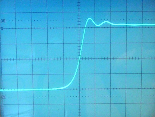

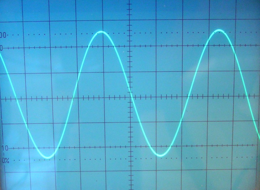

Yes I performed the standard measurements as usual, but the capacity of the probe affects the measurements and the jitter level is too low to measure with my equipment.
So the real jitter "measurement" is done using selected CD recordings. After all, the reproduced sound quality is all that matters.
First oscillogram shows the sine wave output signal (that drives the capacitive node). It has already been filtered by 4 crystals that are also used for oscillation. I had to turn up beam intensity to get the camera focused. The flip-flop triggers on approx. 1V signal, the sine wave output (without probe connected) outputs approx. 12 ... 15Vpp with approx. 2.5pF load (trimmer plus capacitive node).
Second oscillogram shows the buffered output signal, this has slightly higher jitter as the signal has passed a discrete clock buffer, yet my equipment fails to show it. This output signal drives one clock load (processor).
Third oscillogram shows the reclocked BCK signal in detail. This is the actual output signal from the on-board 180 Mhz synchronous reclocker.
The square wave runs in perfect sync with the crystal oscillator, I also took precautions to minimize crosstalk. Tests showed that the advantages of having a very short signal path between both oscillator and reclocker (few mm) outweigh possible crosstalk issues. This technique also allows to tap the crystal output signal without using buffers or comparators that do add some extra jitter.

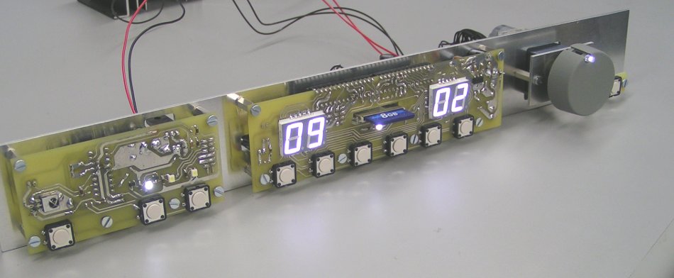

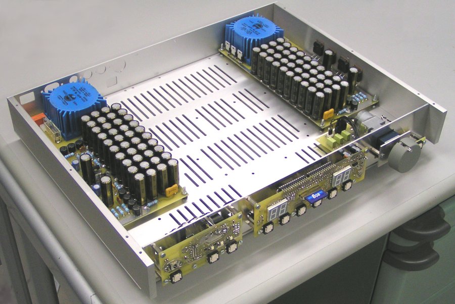

I attached a photograph of the front panel modules, mounted on an aluminum frame.
On the left is the new system control module. It provides IR remote control functions, power up/down, input selection (3 analogue inputs) and volume control (Motorized ALPS pot). The IR remote control now has 12 keys for controlling all required functions. The SD-transport is located in the center, and the volume control is on the right.
Keys (left to right) are for ON/OFF, input selection, disk-, disk+, stop, play/pause, track-, track+, and all the way too the right, muting.
Second picture shows how I plan to place the modules in the DI8-size housing.
High resolution DC-coupled bridge power amp modules are on the left and right. Most other modules are mounted on the front panel. The large space left is for power supply, DAC module (various DAC chip types possible), and optional DAC tube output stage plus power supply.

It looks wonderful! I can almost listen the crystal clear sound... 😀
I presume from the photo that you will install inner panels to divide the PS sections and heatsinking...
I expect to see the volume attenuator system soon...
You probably choose high quality connectors too...

It seems my single box solution comes to reality! 😀😀😀
No fancy cables, connectors... even between innner modules they will be interlinks direcly soldered.
I like design also. It look very compact.
As you see from foto, for start it will be relays for input and motorised Alps potentiometer. It seems it satisfy high resolution sound.

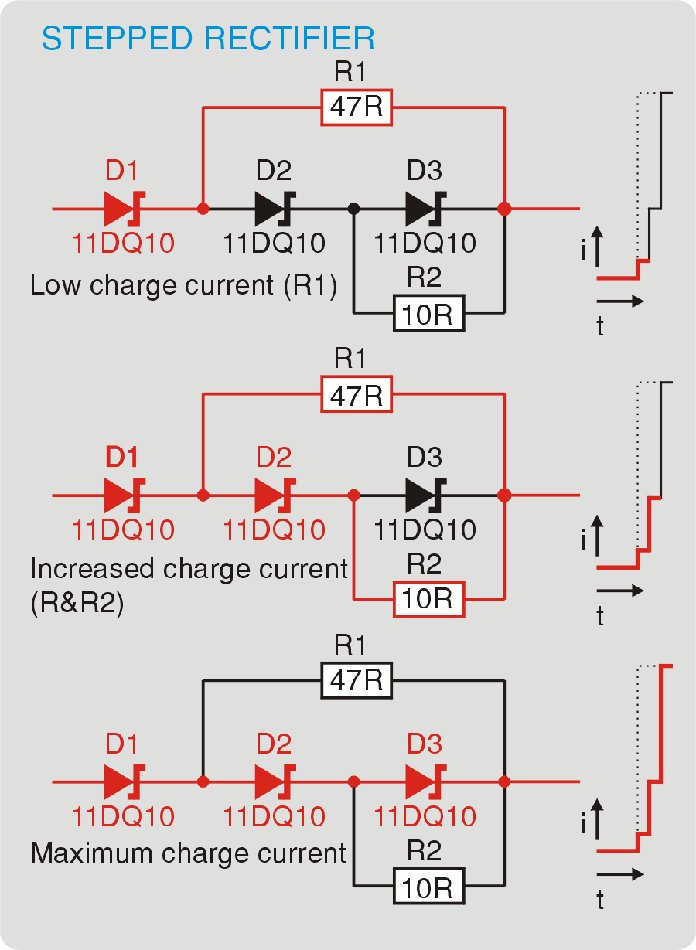

Hi void,
Semiconductor rectifiers switch-on fast, causing peak surge currents as the connected smoothing cap starts charging instantly. Similar, during fast switch-off they could induce back-emf (inductive loads including smoothing cap self inductance). These in turn result in unwanted switching noise, note that a Schottky barrier rectifier would not prevent this either, as it switches-on fast too, and causes similar peak currents as with plain silicon rectifiers. During switch-off, back-emf can also be induced by using a Schottky diode. The Schottky diode does have advantages over plain silicon rectifiers (reverse recovery characteristics).
Tube rectifiers switch-on and off more gradually (controlled), causing lower surge currents. Call it dynamic compression as the tube rectifier limits peak charge current similar as with a clipping tube amp. So using tube rectifiers can have advantages.
The rectifier switching noise spectrum depends on, and is shaped by connected smoothing and decoupling caps. This is why each (electrolytic) cap causes different perceived sound quality, as it produces a different switching noise spectrum. The switching noise spectrum then inter-modulates with the signals processed by the connected circuits so the effects become audible.
Now lets think "out of the box" for moment and observe attached schematics.
There are 3 Schottky diodes placed in series, each Schottky diode has approx. 0.4V threshold voltage (voltage across it needs to exceed this value in order for the diode to start conducting).
Upper circuit shows situation where V-primary just reached V-cap + 0.4V, only one diode (D1) can conduct now. The current has to flow though R1, so we start with a reduced charge current instead of full surge current that would occur with a plain rectifier (dotted line on the charge current graph).
As primary voltage rises to V-cap + 0.8V, D2 also switches-on and the charge current is further increased (D1, R1, D2, R2).
Finally, when the primary voltage exceeds V-cap + 1.2V, D1, D2, and D3 start conducting, bypassing R1 and R2. We have full charge current now.
Switching-off is also done step-wise in reverse order.
Resistor values need to be adapted to required load current.
What we achieved is a more controlled (step wise) switching of the rectifier and reduced surge currents (reduced switching noise). Number of diodes and resistors can be increased depending on allowable voltage drop and cost, for creating even lower switching noise levels. Simplest step rectifier would consist of 2 diodes and 1 resistor placed in parallel with one of these diodes.
I plan to use these stepped rectifiers in the ISD playback unit.

Hi EC,
Would an RC (AKA snubber), tuned for the circuit, improve things over plain R?
R-C Snubbing for the Lab - Maxim
