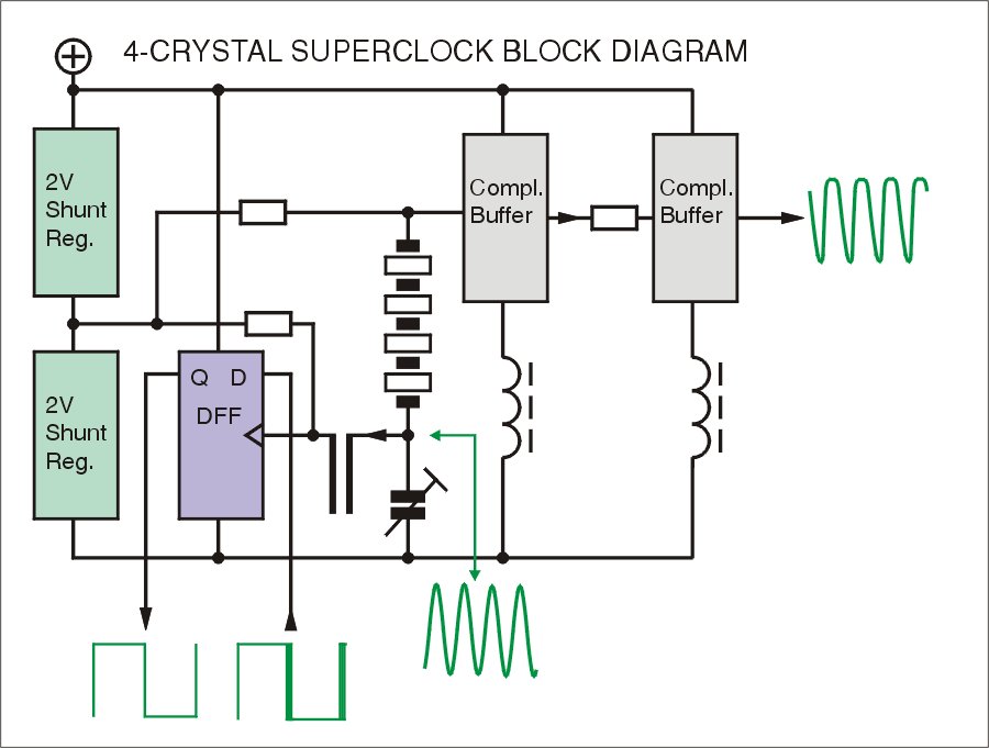

Hi jkeny,
The way the master clock is used makes all the difference, I tried to connect fewest possible clock loads and tried to isolate clock loads, preventing crosstalk between loads.
In most common designs, the synchronous reclocker or divider is external, connected through (a few inches) of wire. In these ultra low jitter applications, every millimeter of interconnection counts. The longer the interconnections, the higher the risk of picking-up unwanted interference that not relates to the master clock jitter spectrum, significantly increasing jitter.
One of the special features of the 4-crystal master clock is that the single synchronous reclocker is merged into the master clock, ensuring shortest possible link between master clock output and synchronous reclocker input, thus reducing unwanted interference to an absolute minimum. In order to prevent negative effects from higher harmonics, the masterclock output signal is filtered (fundamental) prior to feeding it to the integrated reclocker. In order to prevent possible timing uncertainty, both reclocker and master clock power supplies and reference voltages track.
In order to completely isolate the highly sensitive synchronous reclocker circuit from the main (buffered) master clock output (that might pick-up interference from connected clock loads), the synchronous reclocker is driven through a capacitive node (<1pF).
I attached 4-crystal master clock block diagram, this is the master clock integrated in the TDA1543 DAC module.
Two filtered LED shunt regs create plus and minus 2V with respect to the reference voltage. The shunt regs are powered by a 20th order LC filter, located on the TDA1543 PCB. This LC filter also provides required current limiting (choke DC resistance).
The oscillator is built around a complementary choke-loaded JFET buffer. This type of buffer provided highest PSRR by far. Frequency is set by 4 crystals that are placed in series, these also filter the oscillator signal (output across 2.5pF PTFE trimmer). The filtered output signal is the fundamental (sine wave) with high spectral purity. Amplitude is much higher than the 4V power supply (calculated 20Vpp). I can't measure exact amplitude as the scope probe forms a capacitive load (>10pF) that significantly reduces amplitude during measuring. The probe also significantly increases jitter by injecting noise (ground loops, mains powered measuring equipment).
Reference voltage is applied through a bulk metal foil 100K resistor (other resistors were too noisy). The oscillator has total of 9 components, 4 crystals, 2 JFETs, one PTFE trimmer, one bulk metal foil resistor, and one choke. Frequency can be set to exact value (11.2896 MHz) using the PTFE trimmer.
Output buffer (2 JFETs, one choke and one resistor) drives the source (SD-transport, CD transport or squeezebox for example).
The I2S timing signal of interest for the TDA154x series is BCK. So the BCK output of the source is synchronously reclocked, but if required the word clock can be reclocked instead. The synchronous reclocker will have big impact on final jitter levels / spectrum, and is the heart of the timing system.
I tested PECL, ECL and high speed CMOS flip-flops. Both PECL and ECL consumed much more power and produced a lot more interference, including power supply pollution. The high speed CMOS (180 MHz), with special clock injection (using a bias voltage) provided best (audible) results. The D fip-flop is clocked with 11.2896 MHz and reclocks 1.4112 MHz.
The TDA1543 runs on lowest possible bit clock (44.1/16) of 1.4112 MHz, this greatly reduces on-chip ground-bounce. ground bounce increases with both, increasing frequency and increasing voltage.
Alternative to synchronous reclocking would be using a divider to extract 1.4112 MHz, but since this divider requires multiple D flip-flops, its likely to produce higher jitter compared to a single flip-flop used in a synchronous reclocker.
In order to feed cleanest possible clock signal to the reclocker, the filtered output signal of the crystal oscillator (across the trimmer) is fed to the reclocker using a capacitive node and using shortest possible connection. That's why it has to be integrated in the superclock module. The reclocker clock input is set at exactly the same reference level as the crystal oscillator, using a resistor. This way, both crystal oscillator and reclocker "track", so minor power supply fluctuations are common for both circuits, reducing trigger uncertainty.
The reclockerd output signal is then only fed to the DAC chip using a dynamic jitter attenuator, that basically compensates for TDA1543 on-chip jitter (ground-bounce) by providing pre-compensation. It basically counter-acts the effects of on-chip ground-bounce caused by the BCK signal. The DJA circuit has to be carefully tuned with a given DAC chip in order to achieve best pre-compensation. Different type of DAC chip (TDA1541A for example) requires re-tuning.
This master clock approach enables something that's very difficult to achieve with conventional designs, extreme low sample timing jitter at the OUTPUT of the DAC chip where it matters most.
Ultra low jitter masterclock is basically useless if resulting sample timing jitter at the DAC output is still high, due to on-chip ground-bounce. It's very likely that modern DAC chips like the Sabre DAC for example (using very high on-chip frequencies) suffer more form increased sample timing jitter at the DAC output, as a result of increased on-chip ground-bounce.
Quite the opposite is true.
Despite faster rise times, ECL has much less swing and produces less EMI, even more in differential designs.
It also produces much less supply noise because of internal differential & spike free design.
Most important, ECL flipflops range from 1 GHz to 4 GHz and have the lowest available jitter down to 200 fs. So I won't consider 180 MHz as "high speed".
Comparison of jitter performance between different logic families from ONsemi appl. note:
You should maybe first prove the performance of your own system.
I personally have my doubts.
You never show any measurements.
Last but not least, this still is a DIY forum. Why not show the schematic of your clock ? Would be interesting for discussion and for education of you readers.
