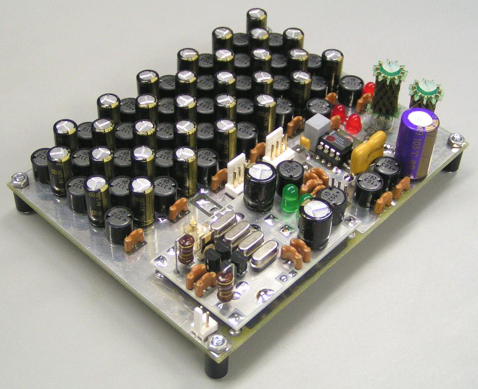

Next module (TDA1543 DAC module) has been completed and tested. This module is intended for the basic ISD player.
First picture shows the component side. There is an un-interrupted ground plane used here. The cluster of capacitors and chokes on the top form 3 separate 20th order LC filters. These are fed by the 5.4V power supply and are used to filter super clock and passive I/V resistor reference voltages for L and R channels.
The superclock module (bottom) requires some screening, I will add that later. The 2-way connector of the left outputs 11.2896 Mhz for the SD-transport. The connector close to the superclock is for the I2S interface. BCK is reclocked by the superclock and fed to the TDA1543 using a dynamic jitter attenuator circuit. The remaining I2S signals (WS / DATA) are fed to the TDA1543 using I2S attenuators. The red LEDs are part of the shunt regulators that provide L and R channel reference voltages. The passive non-inductive I/V resistors are high wattage wire wound types (constantine wire) with low self capacitance, using a mobius / honeycomb winding pattern. The TDA1543 is a selected (lowest THD) cryo-treated version. Advantages over TDA1541A are single power supply, no DEM clock and associated "issues", ability to generate suitable ac voltages directly across a passive I/V resistor without the need for active amplification, and low on-chip interference due to simple straight-forward circuit.
The coupling caps (only ones in the entire signal path) will be either hybrids, V-cap TFTF or Duelund VSF copper foil (if these are still available). I am waiting for over 2 months on the Duelund caps I payed in advance, still haven't received any yet.

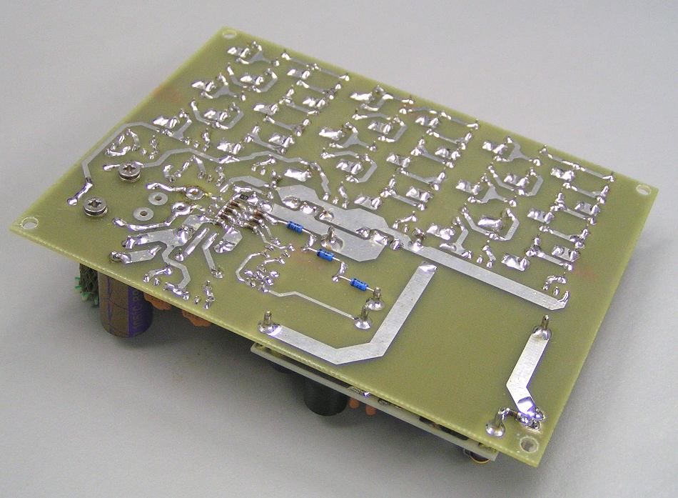

Second photo shows the solder side. Only few components, the blue Schottky diodes are part of the dynamic jitter attenuator.

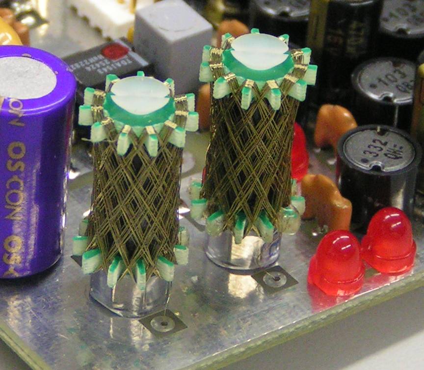

Third photograph shows the 700 Ohm passive I/V resistors in detail. These offered best performance by far, easily outperforming Rhopoint, Vishay bulk metal foil, and other audiophile resistors. Key factors are extreme low noise (high-wattage wire wound), non-inductive design, and low self capacitance.
The only downside is that it takes many hours, steel nerves, steady hand, special techniques (tension) and patience to wind these. The trick is to prevent exact alignment of the wires in order to further decrease self capacitance. This is controlled by varying the exact wire tension during winding.
The photograph shows the size of these resistors in comparison with 5mm LEDs.

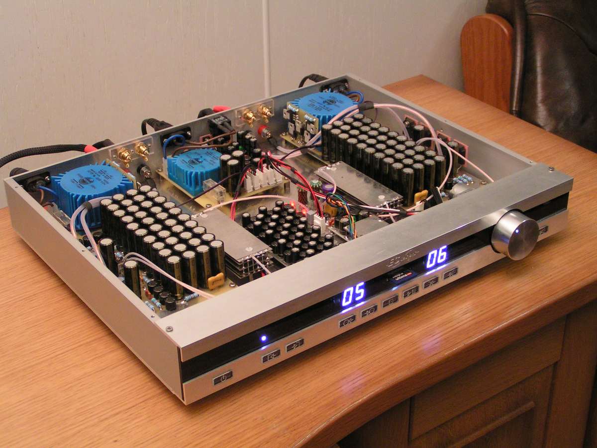

ISD prototype almost ready, only 5.4V main power supply module PCB still has to be designed. Same applies to the top and rear panels.
I attached a photograph of the ISD prototype in action.
The modules on left and right are the DC-coupled high resolution FET bridge power amps, power is limited by 25VA toroidal transformers because of very high SR60 efficiency. Each mono block has 8 FETs, two dual JFETs and 4 matched power MOSFETs in the unity gain bridge output stage. The amps do not have global feedback nor any filtering, current sources are replaced by hybrid chokes in series with a resistor. It is used in balanced mode (power amps have both balanced in and outputs). The DAC chip ground is connected using Kelvin coupling, eliminating residual GND interference by sensing on DAC AGND pin.
At normal to high volume settings the complete unit consumes average of 25 watts, power amplifiers included. Most power (20 watts) is consumed by bridge output stage bias current. There are 3 separate mains connections, one for each mono block and one for the 5.4V logic power supply. The logic circuits can also be powered by an external 12V battery.
The ISD player remains in stand by after "switching-off", so there is no warm-up / settling time when the unit is switched-on. This way the unit offers instant maximum performance after switching-on.
Wiring is home-made litz wire with PTFE insulation. Analogue interlinks are all hard-wired, directly between PCBs. Common ground plane for all analogue modules is formed by the 3mm thick solid aluminum bottom plate.
The module in the center is the TDA1543 DAC module with on-board 11.2896 MHz superclock / reclocker module. I/V resistors are wire wound mobius / honeycomb versions.
The "modules" on the left and right of the DAC module are home made 3.3uF / 250V high resolution hybrid capacitors that easily outperformed V-cap TFTF that I used as reference.
I still plan to test Duelund VSF copper foil caps when I receive them, but for now the hybrids are excellent.
bottom right module contains a motorized ALPS pot plus input selection and muting relays.
System control module and SD-transport are mounted on the front panel frame that also forms a screened compartment for both modules.
The volume knob from massive aluminum is home made, it also contains an indicator LED. Connection is made through a spring-loaded test pin and a circular PCB integrated in the knob.
The unit can be operated manually (front panel keys) or by a remote control.

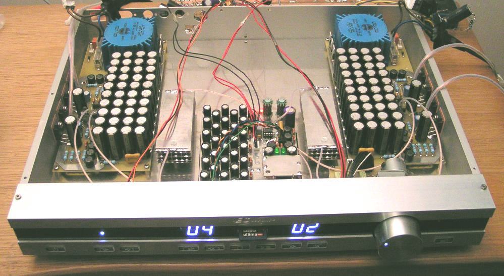

ISD player is now almost completed. The attached picture shows the ISD player being tested.
The 5.4V power supply is now ready (center rear). It powers syscon, DAC, and SD-transport modules.
I also installed 2-stage stepped rectifier modules on the bridge power amps (5 x dual fast, slow recovery diodes in TO-220 housing).
On the rear there are 3 mains connections to power each subsection, one power switch, DC socket for battery operation, 2 speaker connections, and 2 external analogue stereo inputs.

Hi mr_whocares,
The ISD player is a unique concept as it combines all audio components in one housing and uses a virtually perfect digital audio source. This greatly reduces problems that would arise with separate audio components connected through conventional interlinks using sockets and plugs. One side effect is that the volume pot is less critical now, and an ALPS pot really functions very well with this specific concept. Alternative could be a TKD 2CP-2511MC Motorized stereo volume control:
TKD Tokyo Ko-On Denpa volume controls main page
I already tried other options like the lightspeed attenuator and relay volume control using bulk metal foil resistors, but these failed to improve on plain potentiometers with this application.
I have to add that the ISD player uses large bandwidth signal processing all the way up to the speaker outputs. The matching speakers (SR60) are also optimized to handle large bandwidth signals (passive crossover filter) by using very high speed hybrid caps and multi-segmented honeycomb air chokes wound with litz wire.
This conflicts with ISD player concept, and would lead to sound quality degradation. Reasons for this, a ground loop is introduced by connecting an external active circuit, the amount of components in the signal path is at least doubled, and it's virtually impossible to get both main speakers and separate active sub act as a unity.
It would also require an active buffer between I/V resistor and active sub, further degrading sound quality. Finally external interference would be routed back to the I/V resistor, causing even more problems (even buffer amps pass interference).
Yes there is enough room, I could even mount the tube(s) inside the housing so it remains very compact. Problem however, the ISD player will reveal typical tube distortion without mercy, this can be a good thing if you like "tube sound", but it's not desired if you prefer utmost transparency and refinement.
When swapping DACs, both DAC module and power supply have to be swapped. The superclock (that must be mounted on the DAC module) can be re-used. Some DAC chips like the AD1865 need extensive glue logic that make it extremely difficult to maintain low noise I2S signals. Common belief is that only the I2S timing signal needs to have low jitter, and that jitter on all I2S signals can be easily removed by reclocking. In practice, the only way to get really clean I2S signals is to use brickwall bandpass filters with less than 10Hz bandwidth in order to suppress source jitter spectrum. The DATA signal however requires larger bandwidth, making effective brickwall bandpass filtering very difficult. Note that all I2S interference (jitter) ends up and inter modulates with audio spectrum and reflected mirror images. This is one of the reasons that no two digital audio sources sound the same.
This is why I had to develop the SD-transport, here the generated I2S stream is already very clean (before reclocking) something that's seldom the case with any other digital audio source. Since I run both source and DAC from one single master clock, I only have one clock jitter spectrum. If I would use multiple clocks (ASRC, PLL, asynchronous reclocker, tracker), I would end up with inter modulation products of both clocks, adding a lot of extra interference that cannot be removed.
Currently available modules and prices (VAT exclusive):
SD-transport with removable SD-card holder module : eur 199
TDA1543 DAC module without superclock and wire wound Mobius / honeycomb I/V resistors : eur 150
Superclock (11.2906 MHz) : eur 75
Handcrafted 700 Ohm wire wound mobius / honeycomb I/V resistors : eur 50 each
Both modules and and PCBs are fully handcrafted and tested. I also offer these modules built on HF PCB material. I compared these with epoxy PCBs, and in the ISD player I noticed higher refinement when using HF PCBs for syscon module, SD-transport, DAC module and superclock. All these modules generate / use high frequencies and are built rather compact (SMD), so here HF PCB material could offer advantages. The HF PCB material also offers better mechanical properties (less bending, better heat resistance).
When constructing a player / DAC combination only, using these modules, price will be comparable with the first SD-player project. However performance of the new SD player project is much better.
Rest of the modules and ISD player housing will become available soon.
The modules can be used for own projects or for constructing a complete ISD player.
