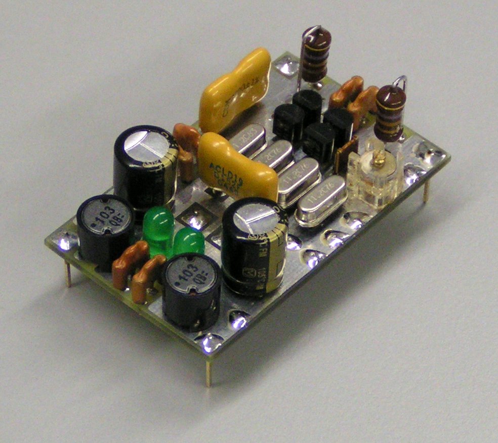

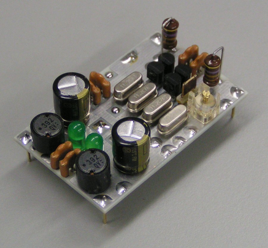

Starting with the 3-crystal master clock, the circuit was completely redesigned in order to achieve much better PSRR (improvement up to factor 50), and very high load immunity (less than 0.02 Hz / pF frequency shift) this translates to an additional improvement of up to factor 40.
Clock injection was changed too, the processor connects to the buffered output, the synchronous reclocker was coupled to the extreme low distortion 10Vpp sinewave output (filtered by 3 crystals that are also used for oscillation). The coupling is made through approx. 0.25pF home-made TFTF cap. The reclocker clock input is connected to a 2V reference voltage. The trigger window dynamically tracks the clock signal average DC level. This way highly accurate triggering is obtained.

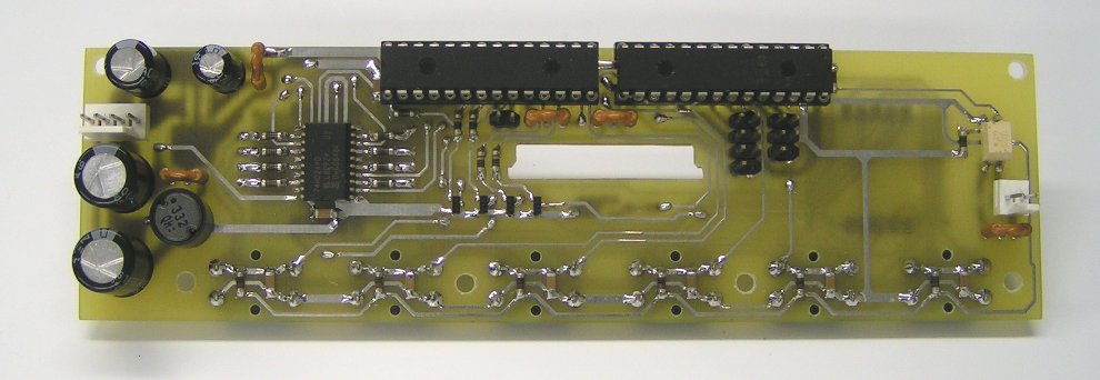

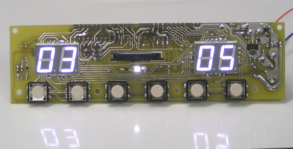

You mean something like this (attached pictures)?
I just completed the first module of the new integrated SD-playback system, the SD-transport.
The compact module measures only 45 x 160mm and includes display, keys, processors, opto-coupler for remote control, 3.3V regulator and display LC filter.
It has following connections;
J1, +5V power supply (approx. 0.6 Watts).
J2, 11.2896 clock input.
J3, SD-card holder.
J4, I2S output (not reclocked).
J5, remote control input.
After connecting it to the SD-player DAC & power supply, it worked first time without any corrections. Sound is even more transparent and detailed compared to the integrated SD-transport of the SD-player.

Meanwhile the second module of the Integrated SD-playback system has been completed and tested, its the new super clock / reclocker module. I added a photograph of this module. As you can see, a super clock doesn't need to be complicated.
The module contains 2 filtered LED shunt references (left). They provide both 4V power supply and 2V reference voltage. Decoupling was done using silvered mica caps, this was done based on both, measurements and listening tests. The complete module draws approx. 15mA @ 4V with one external clock load (SD-transport).
This super clock has 4 selected high-Q crystals (center). The crystals set oscillator frequency and perform oscillator output signal filtering. Fine-tuning is done with a Teflon trimmer.
Oscillation is maintained using a hybrid choke-loaded complementary JFET buffer. The gate resistor (100K bulk metal foil) connects to 2V reference voltage. The buffer produces both a 5Vpp square-wave and a 20Vpp sine wave output signal. These signal amplitudes are possible because of the hybrid chokes.
The 5Vpp square wave output signal is buffered by a matching hybrid choke-loaded complementary buffer and drives the SD-transport (1 clock load).
The 20Vpp low distortion filtered sine wave output drives a high-speed synchronous reclocker (located on the solder side) through a capacitive node. This capacitive node will have virtually no effect on crystal oscillator performance, it could be viewed as a wireless reclocker drive circuit. The reclocker is only a few millimeters away from the oscillator sine wave output, so it will perform way better than any external reclocker. The synchronous reclocker was preferred over a divider because a divider has more flip-flops and thus produces more jitter.
The synchronous reclocker has both, an external input and output. So one could reclock either BCK or WS.
The final design will be placed on HF PCB material (Teflon or comparable material). It also needs to be screened, I am thinking of a 2-layer screen consisting of copper and mu-metal.
In order to squeeze maximum performance out of this super clock, I used a 20th order LC power supply low-pass filter (10 x L, 10 x C) that also limits the current for the on-board shunt regs.

I modified power supply decoupling by using 805 size 1uF NPO capacitors that are soldered directly across the synchronous reclocker power supply pins and across the crystal oscillator power supply. The silvered mica capacitors were removed.
I also built both SD-transport and clock / reclocker on HF PCB material for testing.
The attached pictures show the version built on HF PCB material.
First picture shows the component side, the 100K bulk metal foil gate resistor is located above the PTFE trimmer. It is very important to use low noise gate resistors of lowest possible value. The often used 10 M Ohm resistors produce a lot of noise that reduces oscillator performance. The 4 JFETs form two complementary pairs, one for the oscillator, the other for the clock buffer. I used complementary pairs instead of a single JFET because these offer much better PSRR and less load-induced jitter.
Second picture shows the solder side, the miniature (SOT232) flip-flop is located close to the 2 center pins (BCK/WS in, BCK/WS out). Two 805-size 1uF NPO caps are soldered on top for power supply decoupling. There is one bias resistor connected between FF clock input and the 2V reference voltage, and one in series with the BCK / WS input signal that connects to the FF data input. Clock signal path is kept very short, and this results in much better results compared to external reclockers connected through comparators, buffers and inches of wire.
Since this clock / reclocker module will be mounted on the DAC PCB, very short connection between both reclocker output and DAC timing input can be made.
The clock buffered output is used to drive the SD-transport.
