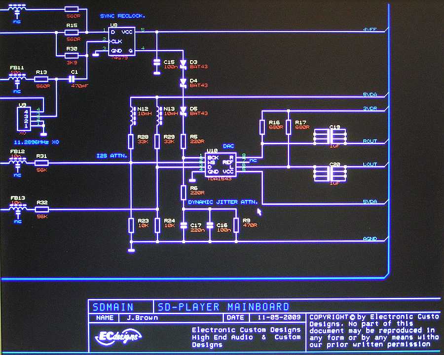

Hi jameshillj
I added a screen shot of the SD-player output stage schematics.
I2S DATA signal passes a I2S attenuator / power limiter FB13, R32, R24, R29, N13.
I2S WS signal passes a I2S attenuator / power limiter FB12, R31, R28, R23, N12.
I2S BCK is derived from ultra high-speed single D flip-flop U8, and passes dynamic jitter attenuator D3, D4, D5, R5, R6, R9, C16 and C17.
TDA1543 outputs drive I/V resistors R16 and R17. Outputs are AC coupled, C19, and C20. The strange symbol for the output caps was required to indicate to my prehistoric DOS CAD system that 4 sets of pads were used to support different types and shapes of output coupling caps.
3VDR reference voltage is derived from a cascaded LED shunt regulator.
The "high quality" cap that performed almost equally well as a Vcap tin / teflon cap in this specific design, was a cheap miniature 1uF WIMA polyester cap (pitch 2.5mm). Later attempts to replace this cap with "better" polypropylene caps failed, these WIMAs performed amazingly well, perhaps it's the small size.
Jitter feedback didn't provide the expected results (too critical). I now use an extreme low jitter 3-crystal clock with amplitude stabilization (XO on the schematic) with a modified sine wave output, and the dynamic jitter attenuator circuit.
No transistors, no OP-amps, no tubes, eliminating all problems these parts may cause.
The TDA1541A is rather picky in this regard. I was able to squeeze maximum amplitude with minimum distortion out of these DAC chips using an external bias voltage circuit that was integrated with the passive I/V resistors. This provided approx. 550mVpp, if you could drive your pre- or power amp with this signal, then yes, you could use the TDA1541A without any transistor, OP-amp or tube too, and benefit from the advantages.

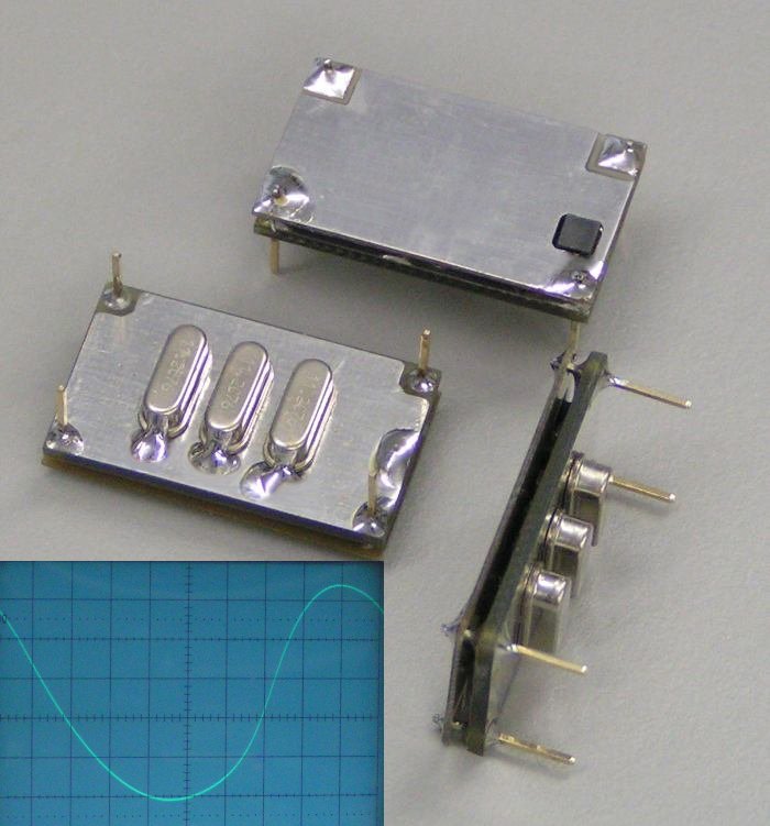

Hi EdwinR3,
Yes, the uncompressed WAV file (44.1/16) is simply copied to the SD-card with some restrictions to file name (must start with 2-digit number to indicate track number), and specified directory structure (all WAV files belonging to one CD must be placed in the same directory. The directory name must also start with a two-digit number, indicating disk number.
The extreme low jitter was achieved by the 3-crystal master clock (I added a photographs of the latest version). It runs on very low power (approx. 6mW), has amplitude stabilization (increases PSRR with up to factor 200), and has output properties that no longer require the use of clock buffers or comparators, eliminating the extra jitter these circuits would add.
Low jitter is maintained by using suitable clock signal distribution scheme.
Jitter is further reduced by the dynamic jitter attenuation circuit.
DAC chip on-chip jitter is minimized by using I2S attenuators / power limiters, and a discrete low noise power supply.

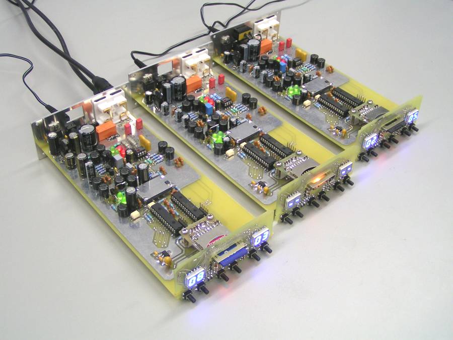

Hi Hisatugo,
I intend to sell the complete product with or without housing for starters. This way I can guarantee sound quality, and the user can directly experience the performance this concept can offer.
The SD-card player is not a simple building block that solves all problems associated with digital audio sources.
Everything must still be maticulously tuned and matched. I can change one component in the SD-player and the magic is gone, so it's still highly critical. But feel free to experiment after listening to the original SD-player version.
By using PCB-only design without wiring, and an external power supply, I barely managed to construct a product with reproducable sound quality (sound quality between the 4 SD-players I already built, matches very closely).
I attached a photograph of 3 SD-players that were used for direct comparison and duration tests. The other one is at my brother's place for software development.

Can I know why the pin 7 of TDA1543 is not connect? Is it better to connect to it to some reference ?
