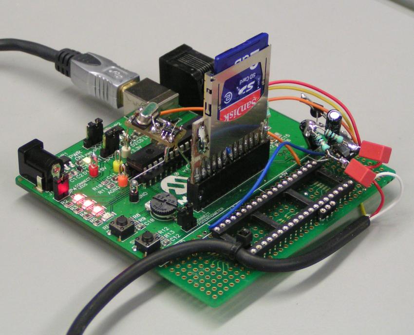

SD-card player prototype is working, there are some minor problems with SD-card latency, this will be solved by doubling RAM buffer size.
SD-card access is software-driven, I2S signals are generated by the on-chip DCI module and through DMA.
The player already supports multiple directories (99) and multiple tracks within each directory (99 track / directory). Long file names can be used as well.
Shuffle play (CD / tracks) also works.
Bit clock jitter can be kept very low as expected. First impressions of sound quality are very good.
The SD-card latency limits max. sample rate and bit depth. The latency is basically caused by the on-card controller, and may vary with SD-card brand.

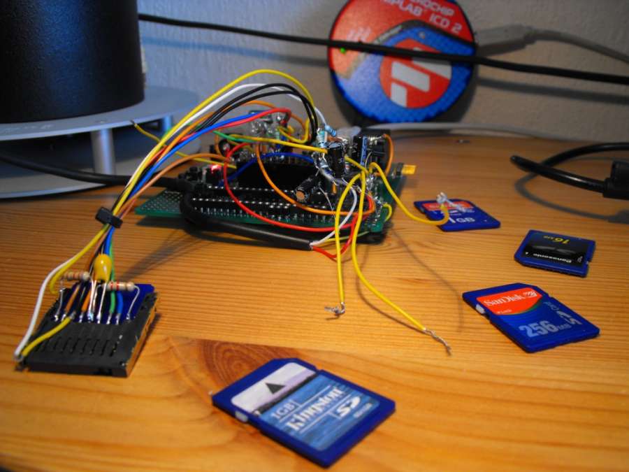

I attached a photograph of the SD-card player prototype (before improvement). Turned out that the drop-outs were caused by both the SPI clock frequency and long wires running to the SD-card. :clown:
The SD-card prototype is now modified (much shorter wires), and now it plays flawlessly for hours.
Although it was not causing the problem, I2S format is now 32 bits/frame, and the bit clock equals 1.4112 MHz.

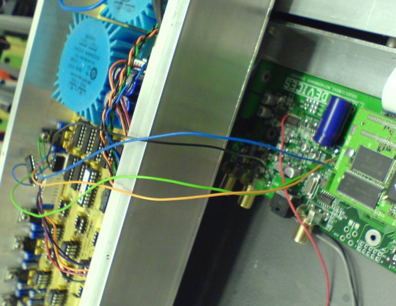

Could a Squeexebox be used to output I2S?
Yes, I already tried this using an older model squeezebox, it required some glue logic though. I attached a photograph showing the tapped I2S signals from the SB being connected to a DI16 DAC (16 x TDA1543).
One problem is the network connection that introduces an ac ground-loop, the other is the high jitter produced by the squeezebox on-board master clock, so some more mods are required. There is also the ground-loop introduced by connecting the DAC (with built-in power supply) to the squeezebox (with built-in power supply). Finally It required a computer, running the Slimserver database.
I often had problems with the squeezebox player connecting to the database as well, this was very annoying. With increasing amount of stored CD images, it also became increasingly difficult to locate the desired CD / track, using the SB user interface, so finally I stopped using it.
Next I started using the mac with iTunes, now music was much easier to access. I started with an USB audio interface, but the galvanic connection created a ground-loop, and sound quality wasn't satisfying. So I built-in opto-couplers (before reclocking) in order to interrupt the ground loop. This produced slightly better results, but still wasn't optimal.
Then I switched to Toslink, first using an analogue PLL driving a VCXO master clock. This was later replaced by a micro controller-based VCXO FLL that synchronously reclocks the source timing signals. Problem was, my CD player produced better sound quality (Toslink) than the Toslink output on my mac. The problem seemed to be solved when I started using the Airport Express mini Toslink output (fixed 44.1/16).
As DAC sound quality kept improving, due to modifications, this option also didn't seem to be perfect. The audible differences between both CD player digital output and AE digital output kept increasing with DAC performance.
That was the time I started looking for a better solution (perfect digital audio source) that should solve these "issues" once and for all. This lead to SD-card player development.
