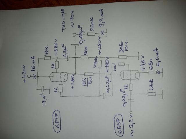

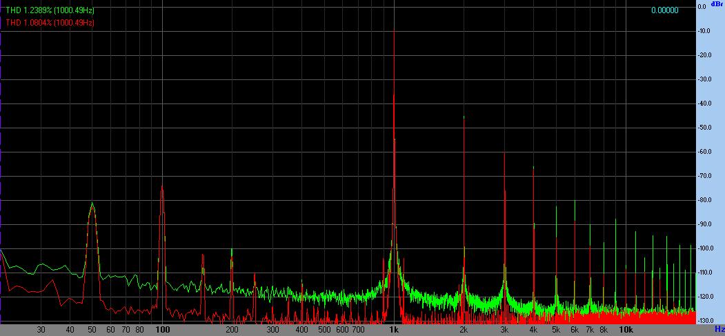

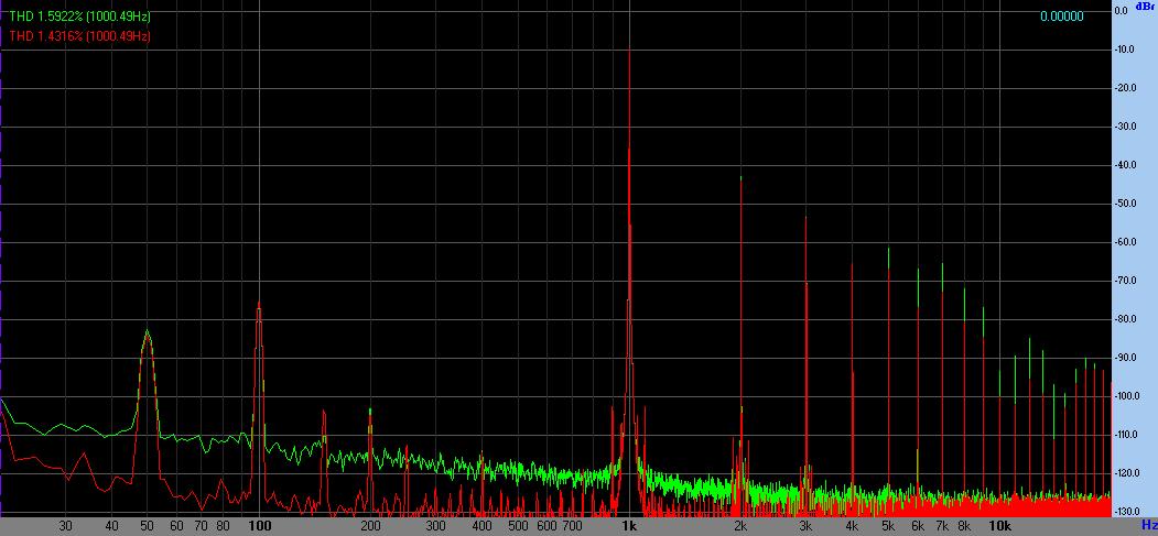

What I thought might be a good reason for looking at direct (DC) coupling between driver and output stages in the particular case of a 300B amp might be the fact that we require a rather large voltage swing into the output tage. So slew-rate requirements between driver and output tube are bigger.
Furthrmore, since the output power is a bit limited, we would be pushing the amp into the upper regions more often as compared to higher powered amp. Consequently, good overload recovery would be an important design goal.
My understanding is that direct coupling of the output tube can. help with both of these aspects.

None of all 300B type suitable for A2.
Most of them reacts with growing distortion if grid swing approaching or exceeding 0V.
Robust metal anode and grid wire types (for example old ValveArt, Electro-Harmonix or JJ) can be used.
