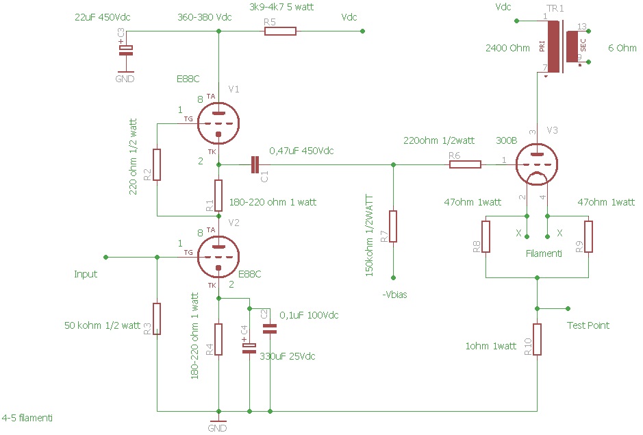

I will propose you another circuit.

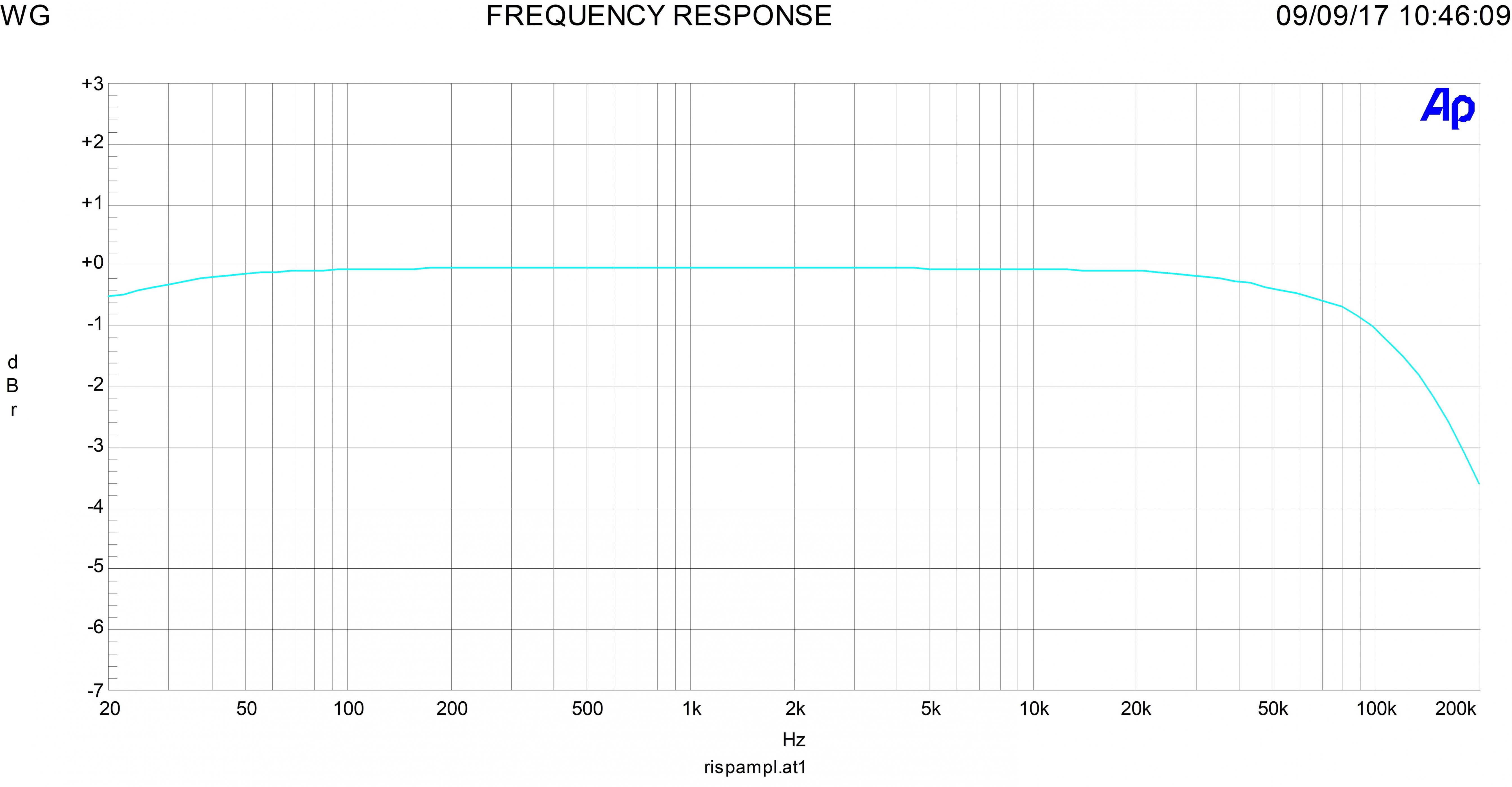

In attach the circuit. the E88C, single triode in SRPP.
Good gain and realtive low Zout
The frequency response of the input stage.
Input 450 mV, out 20 Volt with Ia of 10 mA
Gain 42 times, Zout=1k2 ohm
Walter
