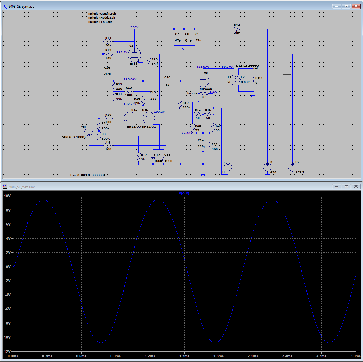

Having sucesfully completed my first KT88 based PP amp this year, I feel the urge of trying to go for a purely single ended triode design as my next project. 300B based preferrably. I'm not keen on too much iron in the signal path, so interstage transformers or mandatory input transformers are a no-go.
I am looking at a design I stumbled across a while back that I set up in LTSpice to learn about that I find quite compelling. It would be great to hear from you guys if a) anything raises red flags for you in that circuit and b) if you have other recommendations of a somewhat proven design that I should look at...

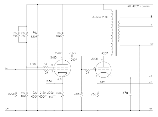

hello Lars,
The driver looks too complex, and C18 will be reverse biased (you don't need it)
If you have a pentode to hand, (EL84, 6BW7, C3m, 6П15П, SV83) you can build a 300B driver that has excellent sound -- far better than the usual 6SN7 drivers.

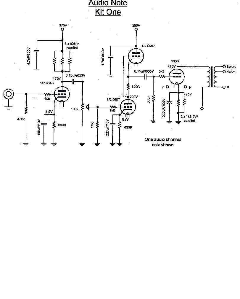

0.4VRMS of signal into a integrated 300B amp is going to be a real challenge. I know my 6SN7 cascode design wouldn't be happy with that! Is there anyway to get your phono pre up to normal line levels? As others noted, it's going to require a lot of gain to get a driver to have the swing/current a 300B needs and still also sound good.
Please note you aren't going to be able to sim what am amp will actually sound like, and I've seen a few 300B sims recently that look fine in the simulation, and end up with major distortion when constructed.

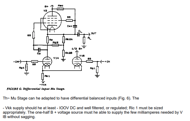

Thinking about differential input for the amp I'm trying to wrap my head around the mu-stage with differential input. I can't quite make out how it works. Why is there 1/2 B+ plate voltage applied as a stand alone voltage to V1b?
I can set it up like that in LTSpice with an additional voltage source and it seems to work, but while I begin to grasp the mu-stage in general, I don't understand the differential version at all... Does anyone have a quick explaination how that works?

V1b needs *some* anode voltage, and would ideally be the same as the idling anode voltage of V1a. That way the halves are as equal as possible. Also may be necessary to keep the voltage or dissipation within limits.
Is your second question about how a differential stage works? Or something else?
It's a differential stage, designed to give a large output voltage. So the left side, V1A has the idle anode voltage at half the supply voltage, to allow the biggest possible voltage swing. The right side, V1B needs to have the same idle voltage as the left, to make the swings of anode currents (in V1A, V1B) as symmetrical as possible; that way the differential performance is optimised.
The differential version is simply a standard differential amplifier, with a µ-output applied as the load of the V1A side.
The important part of the differential stage is the current-source in the "tail" of this long-tail pair.
The first circuit shows a regulated -100V supply and a large value resistor, which acts like a current source to the cathode pair. Today it would be easier and better to implement this as a -10V to - 20V regulated voltage, and a transistor current source.
Using a real current-source improves the common-mode rejection of the differential stage - and that's one of the main reasons to consider a differential stage. The SPICE circuit you have will not give this good CM performance. Try my suggestion in LTSPICE, and you'll see what I mean.

Thank you, that helps me quite a bit making progress figuring this out more.
I'll try to draw draw up the differential input version with a CCS and see if I can at least the simulation to work. I bet I'll be back with more questions by that time
