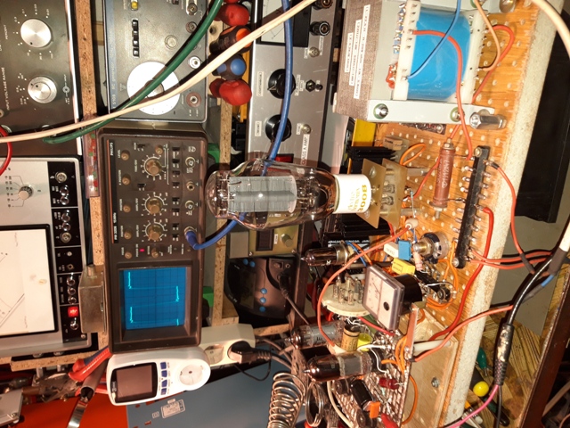

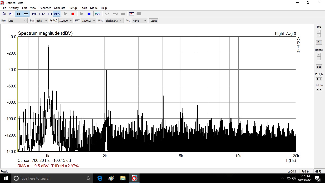

I completed the tests for the new amplifier with tube 300b for which i chose a load line following data Ua=450v Ia=90mA -Ug=90v P=8w Zp=5200 ohm THD=2,9% .The driver is a mu folower type with 6E5P and 6P1P that can deliver 108v with THD <1% but for 300b max 60v is needed. The problem is that toget the 8w, the input voltage is 2,2v compared to 0,7v as would need a preamplifier with Au=3 or an input transformer, what could be the solution ?
