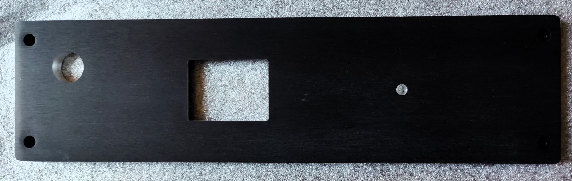

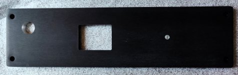

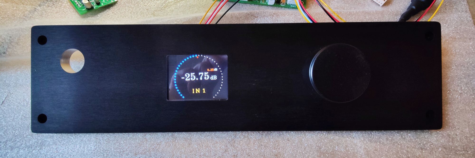

I myself have already designed front panels with a cut-out for the 2.6 inch display for the Galaxy series. These can of course be easily adapted to the Slim Line series.
Who would be interested in this modified front panel? Or are there any specifications from you that I should adhere to?
I would be interested in a modified front panel, as I am using the chassis from the thread. I would not need a hole for the power switch.

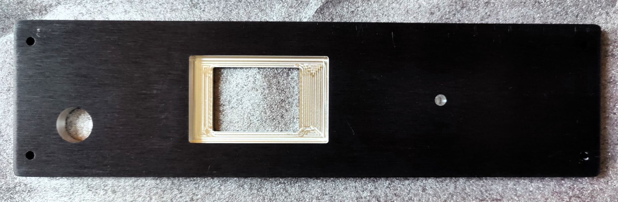

My intention was to modify the original front plate design of the Balanced Iron Pre chassis with my bench top mill similarly to what you have shown above.
My goal was to place the opening for the display in a manner that would retain the original “Zen Amounts” etching.
Since I don’t have the actual display in my hands I don’t know if it is possible to eliminate all the pot mounting holes that are pre-drilled with a proper size opening for the display.
My back up plan was to machine a frame for the display and mount it on the surface of the original face plate covering the pot holes and possibly the “Zen Amounts” etching if absolutely necessary.

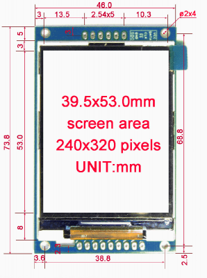

The visible area of the display is 53 x 39.5mm. My cut-out size on the front panel shown above is 51 x 38mm (2 x 1.5inch). This will probably not cover the two holes.
To summarise, I can say that a new front panel is not a problem. However, the logo will not be included.

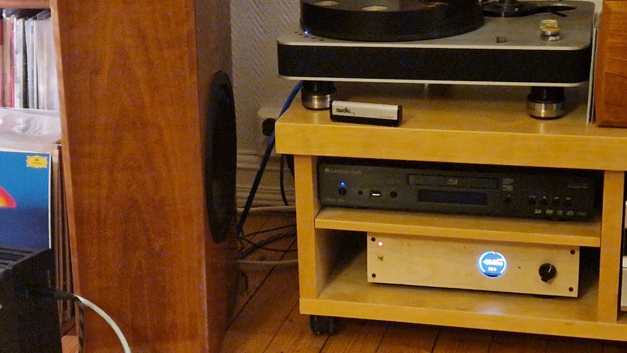

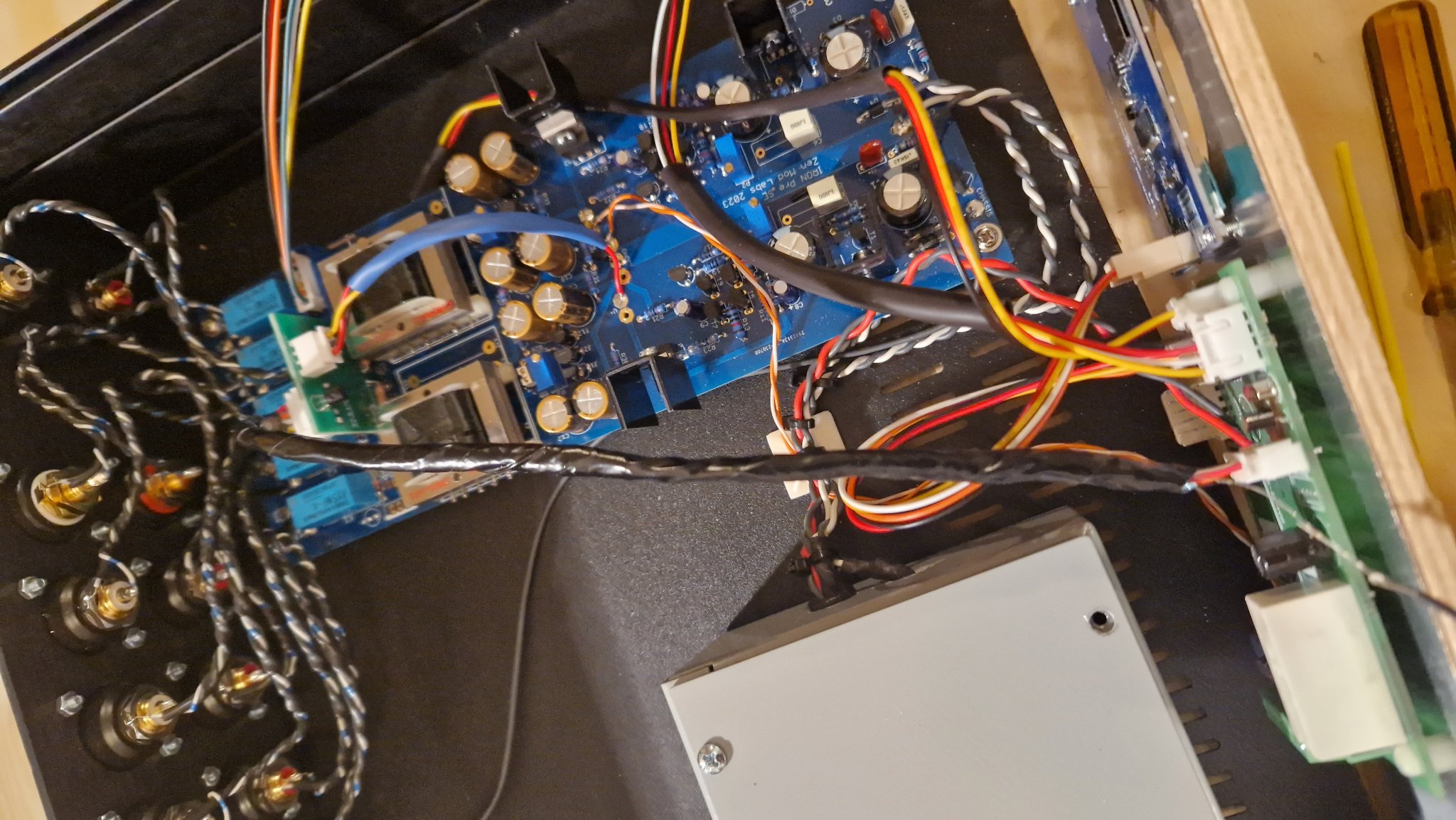

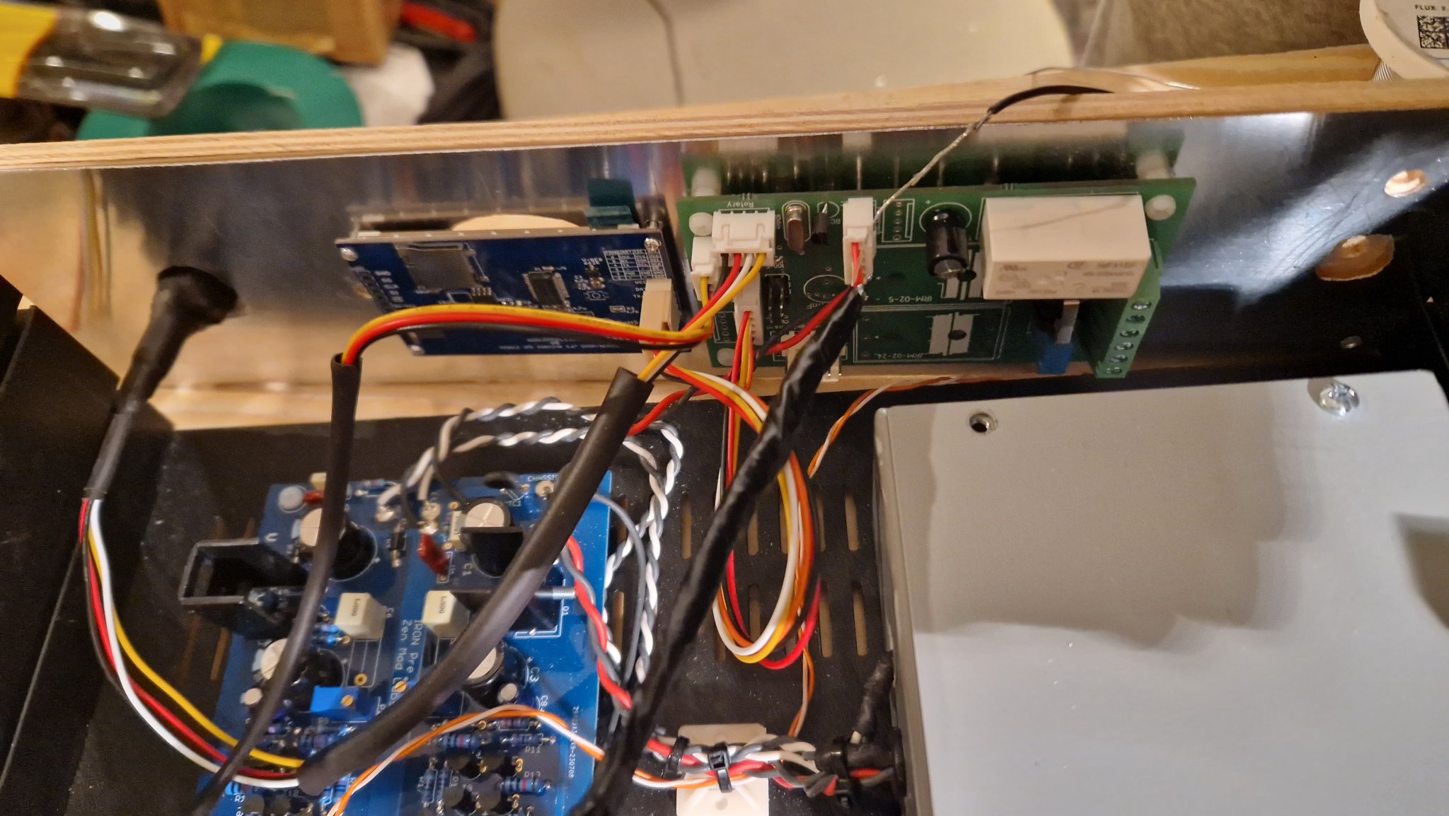

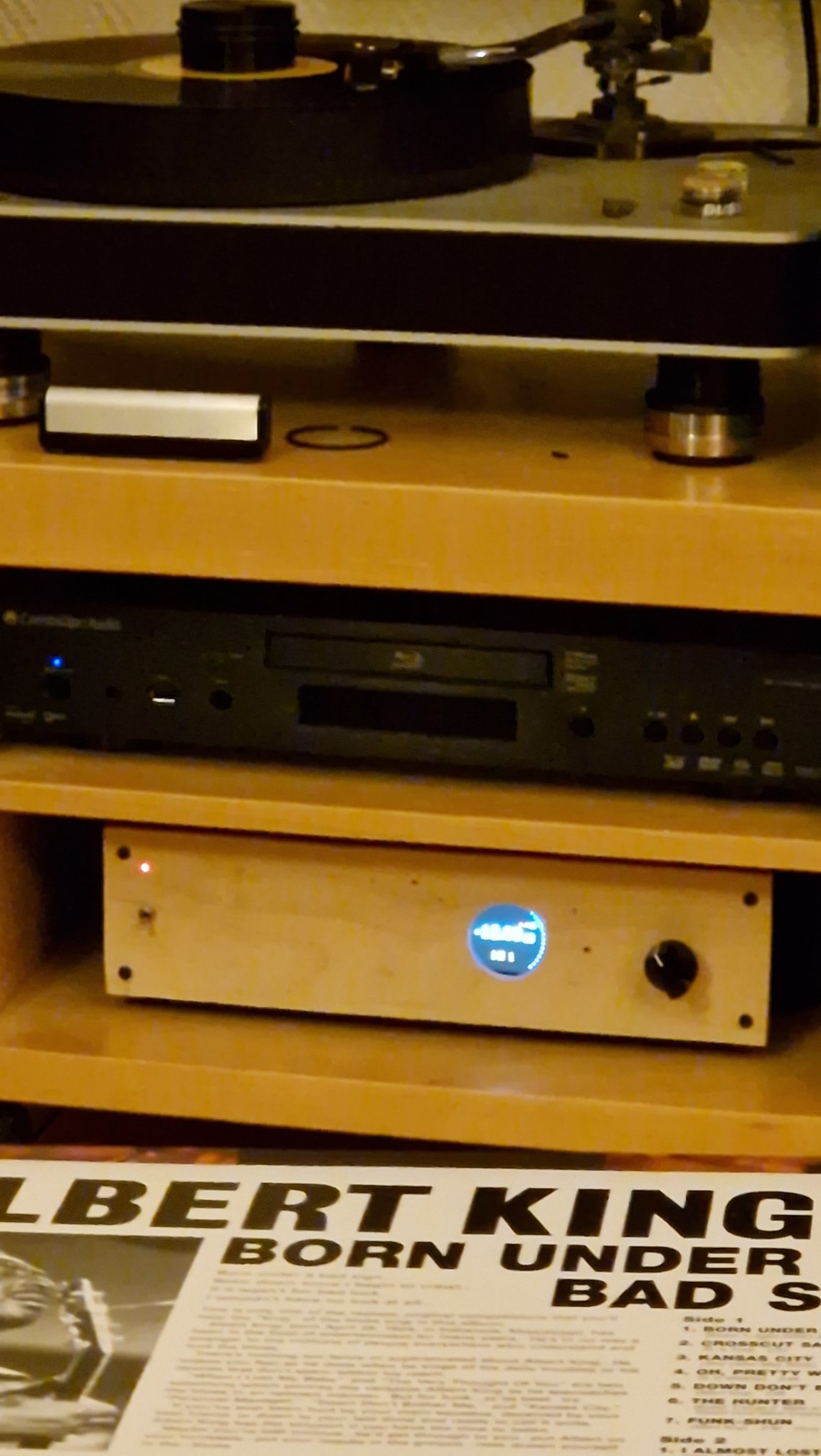

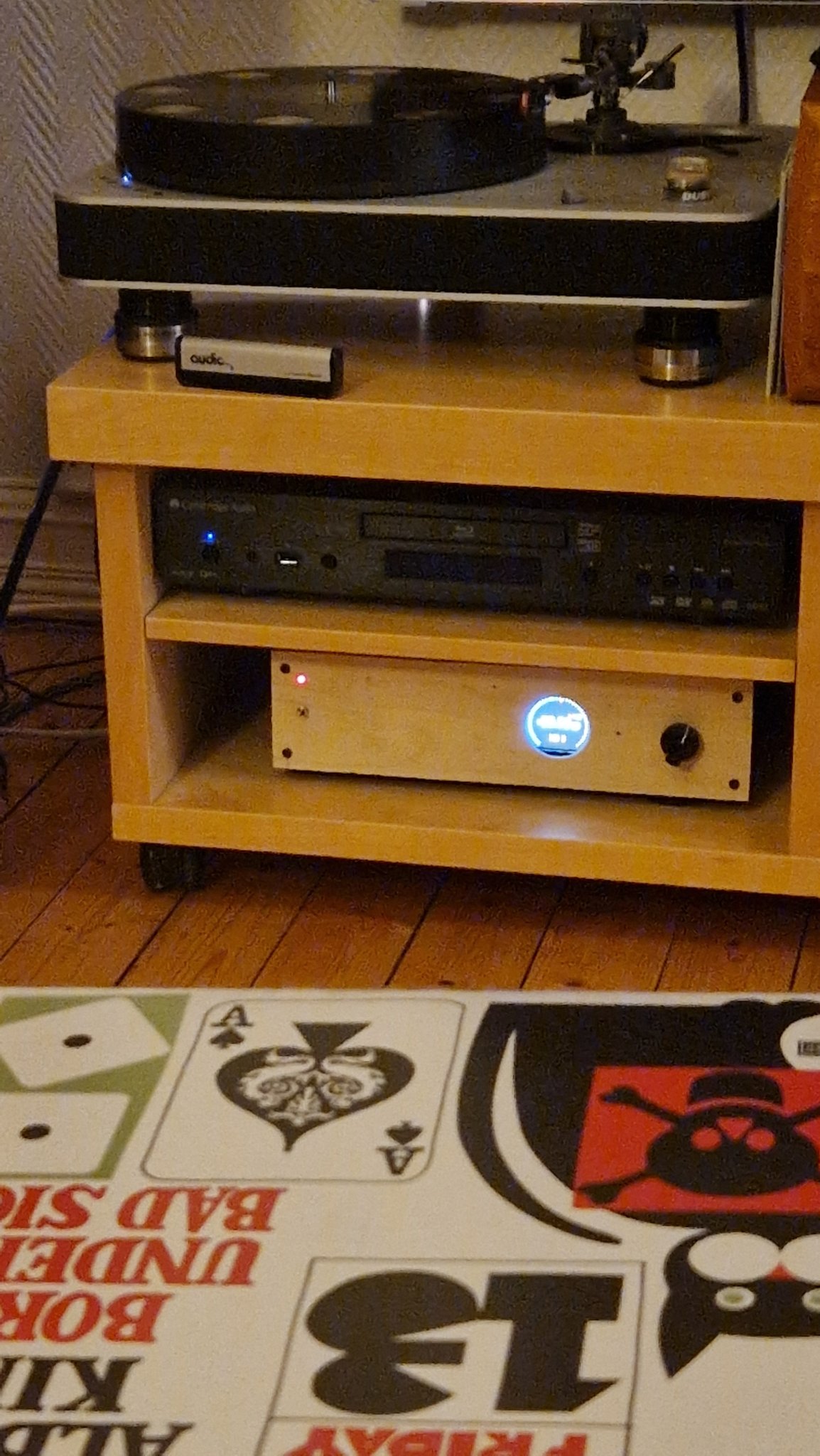

Got my Muses kit from Frank and coaxed it into my Iron Pre.
I made a new quick and dirty front panel for the Gianluca box out of plywood and backed it with a 0.7 mm alu "inner panel". I then made tapped holes in the FP to mount both the main board and the display.
I ran into a couple of minor issues, both of my own doing.
I had not realized that the graphics of the display is not centered in the center of the PCB, so the placement of the first hole in the frontpanel for the display was not quite right. Luckily I had made it a bit too small also, about 38 mm dia, so was able to rescue that by making a bit larger hole with 46 mm dia in a better position, (probably a tiny bit too large, I recon 44 but be about perfect).
The other issue was that with the front panel mounting of the main board , the cable to the muses board was not long enouh in my installation. Was easy enough to just cut this cable and splice in about 5cm of extra wire. I did not have this kind of connector in my stash, otherwise I would coock up a new wire with shielded ethernet wire I guess. I took the opportunity also to put on some shrink and full shielding of this cable as it carries a bit of digital signals realtively close to the audio circuits.
I am petty happy with the result of the mounting of the kit and the temporary front. Will likely get a Gianluca frontpanel, when it becomes available or perhaps make a more fancy wooden front with alu backing as now. Perhaps some live edge stuff with "epoxy river" as the window to the display.. We'll see...
Soundwise I am very happy with it. it's a clear improvment on the pot I used while waiting for this control and volume solution. I can surely detect greater clarity in the music, a bit like the famous blanket or curtain removed from the speakers. I also believe soundstaging , especially depth improved with the muses chips.
Control via the rotary and push functions are great, love to have a balance function as my hearing is a litte attenuated on my left ear, so great to be able to compensate a litte. I have not yet programmed my remote as I can use the excercise to get out of my coach.. But I have seen it react to some signals from my remote already so should not be a problem to get that set up. Will probably happen later today.
First attempt with off center opening for the display. Second attempt with better alignment of larger opening.
Some of the internals before getting all cables routed and tieded up.

Here are the exact dimensions of the display. You can see that the visible area of the display is shifted.
This must be taken into account when creating a front panel. I myself always use a connected display when testing the cut-out.
I will update the website in the next few days and point this out again.
