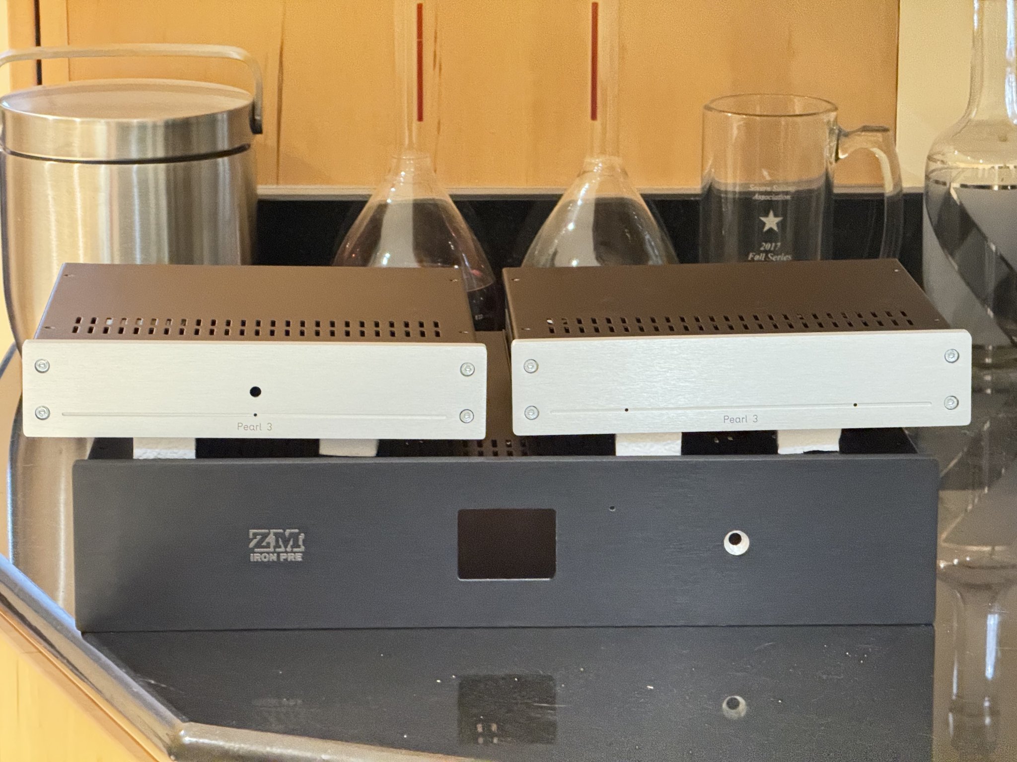

Ordered on Friday, delivered across the water on Wednesday, and partially assembled this evening. My compliments to Gianluca. One Wilker mod for balanced iron pre, and a set of Pearl3 chassis because it would have been a shame not to combine the shipping. Now to layout all the internal bits and bobs and see what I am short. (I already know I'm out of nice rubber feet for the two Pearl chassis and a few xlr sockets)

Ok.. Great! Thanks fellas.. Follow-up question.. In the picture above I'm assuming the hole on the right side of the face plate is for manual volume adjustment, and smaller hole up and to the right of the display is for IR? So no manual ON/OFF, is that right?
If that's the chassis for Frank's solution, the knob on the right is more of a "universal" knob. Volume / input switching / programming etc.Ok.. Great! Thanks fellas.. Follow-up question.. In the picture above I'm assuming the hole on the right side of the face plate is for manual volume adjustment, and smaller hole up and to the right of the display is for IR? So no manual ON/OFF, is that right?
The small hole to the right, yes, that is for the remote IR sensor.
Manual on / off is on the back, and you also have remote "standby", which is wonderful.
Thanks, AliJordan! Was looking at @6L6 's build guide and the "Non Frank/Muses" solution from Modushop has power switch on the front..Not a big fan of having to reach behind to switch things on!If you buy the entire chassis, the on/off switch is attached to the intended IEC inlet on the back.
Ok.. awesome.. Thanks! Remote standby sounds great.. Have you completed this version of the Iron Pre? Appreciate the guidance.If that's the chassis for Frank's solution, the knob on the right is more of a "universal" knob. Volume / input switching / programming etc.

^ I did Frank's in both balanced and SE for testing. IMHO... I could have lived with either of those pre-amps for a lifetime. I'm a lazy SOB, and I need remote mute and volume. I don't need input switching, but it's awfully nice.

You can try contacting Gianluca at Modushop and ask for one like that (with front panel switch hole)…he is very accommodating and if it’s possible I’m sure he will help.
IAIMH and I both ordered custom chassis for our Iron Pumpkin builds.
P.S. I ordered my Balanced Iron Pre chassis before they had worked out the kinks for Frank’s solution. So I have no choice but to modify it myself. Not a big deal as I have a mini mill and lathe.
P.S. I use Frank's solution and I love it. However, I am thinking of widening the front panel hole for the IR receiver because it won't pick up anything at an angle unless you are close to it. My equipment rack is on the left wall about 12 feet away from and at a 90 angle to the listening position, and the very narrow hole doesn't work at that position.
