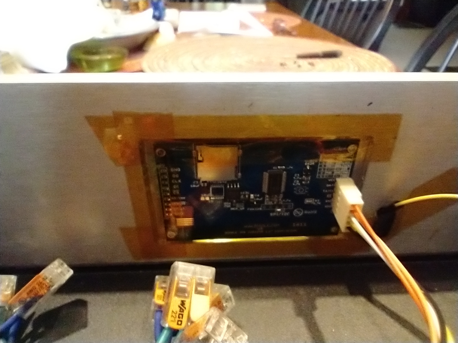

Question for those who have completed the Wilker/Modushop version.. How did you go about assembling the display screen in the front panel? Have the hole cut for it, and plexi from Gianluca, but the display seems to be much larger than the hole that is cut? Not visualizing how it is supposed to go together very well.. If anyone has suggestions/photos that would be great!

Here are a couple of pictures. I recall using a thin bead of clear silicon glue, on the edges, and also using (kapton?) tape as well. I can't remember if I used the Lexan that came with the chassis or if that is just the screen itself. It was a couple years ago. Let me know if you need anything else.

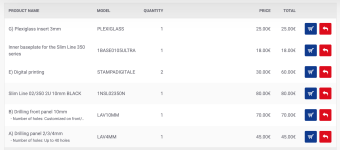

Hoped someone much more knowledgeable would respond to your questions.. I have received the chassis from Modushop, as well as Frank's boards and display. I haven't attatched the display yet.. That said, to answer your questions "Yes" Gianluca did supply the perspex window for my chassis. You'll have to order the chassis "bit by bit" for Franks solution as there isn't a "one stop shop" order for that config. Part of that order was the perspex window. I'll attach a screen shot of all that was required. I ordered the balanced chassis. As far as screwing the display to the chassis, or the perspex.. I don't think it's a great idea. The perspex is approx 3mm and likely thick enough, however the holes in the corners of the display boards are very small. I"d be more concerned about goofing that procedure up vs using silicone and kapton tape. Frank's recommended procedure was to use a dot of hot glue in the corner of the display board somewhere to hold it in the right spot.. Then use silicone to fix it permanently.

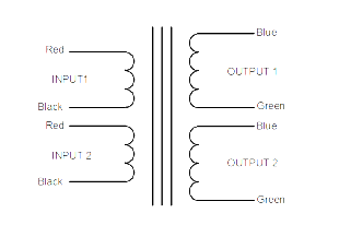

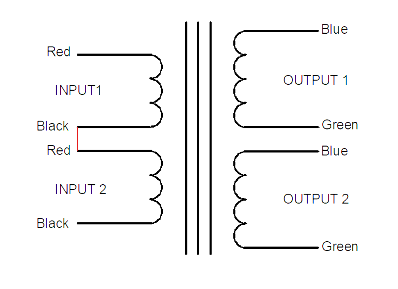

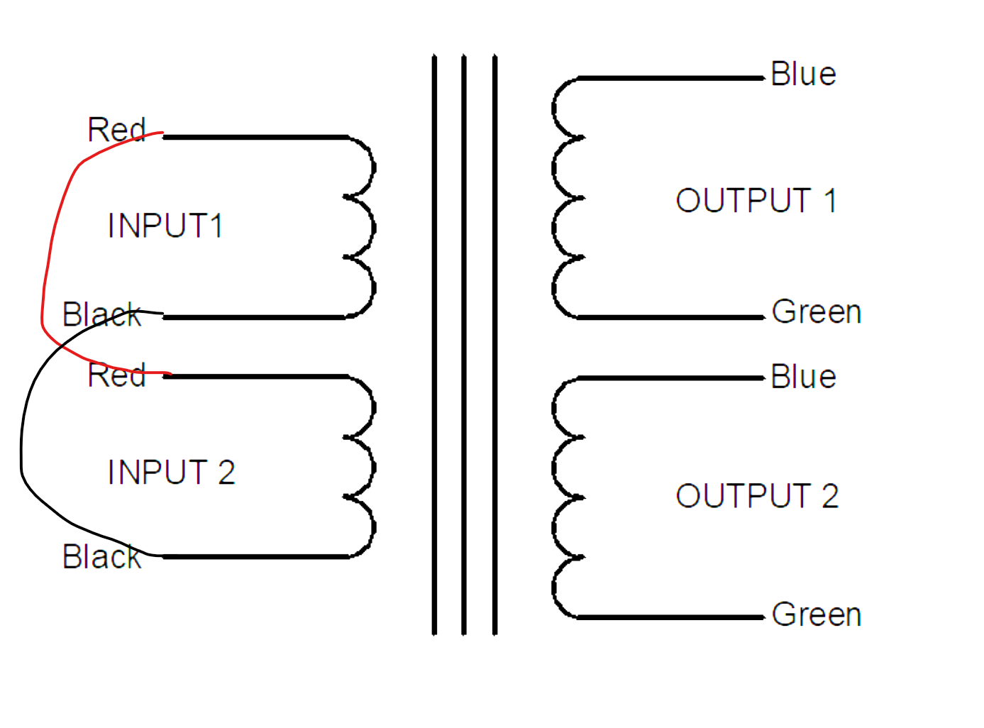

Making some good progress on my IP.. Boards built and tested.. Voltages are great.. I"m working on layout now and sorting out my cable strategy. Question about the AC out on Franks logic board.. There are 4 spots, but not labeled.. Is there any specific order for the primary wires? Red/Black/Red/Black? In IAIMH's pic above, it looks like he went B/R/R/B from left to right in the pic? Thanks all!
