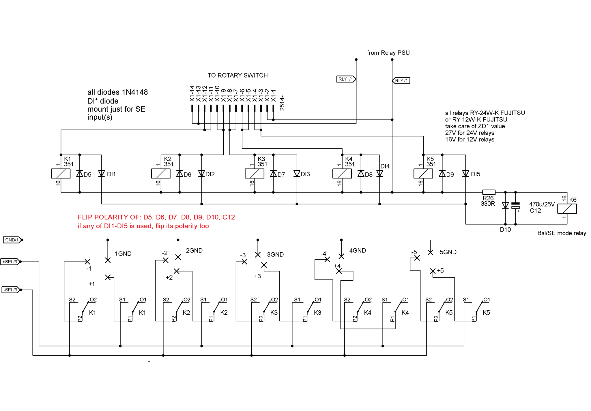

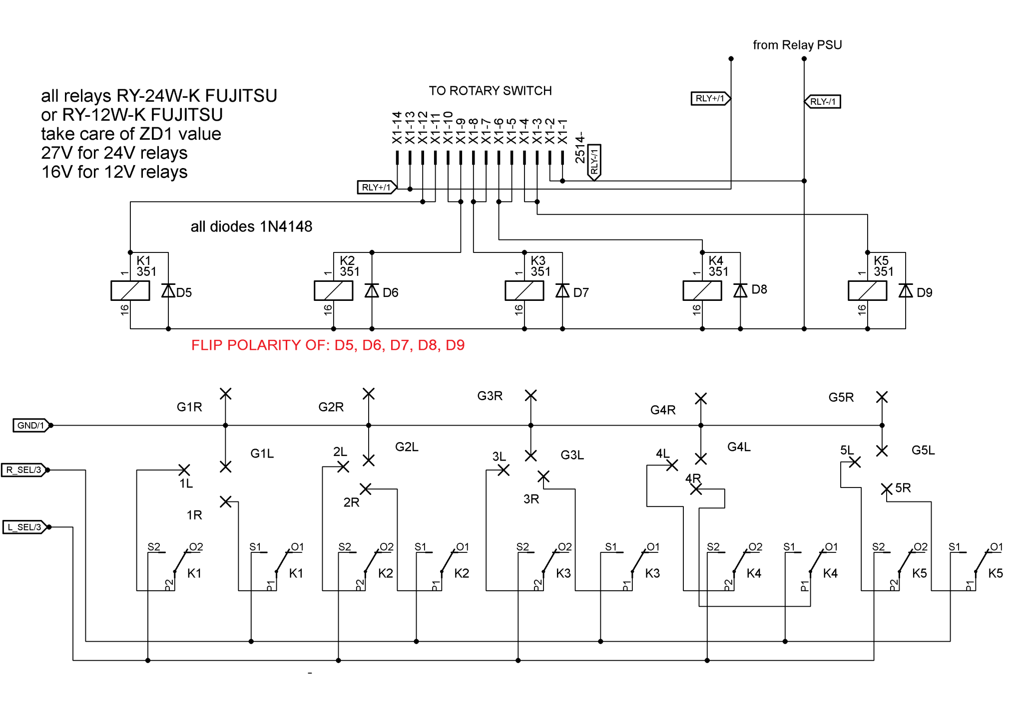

I presume all of you will implement Logic solutions with "low side" switches, where positive rail is common for relays, and each relay is having a switch (bjt, mosfet, darlington) pointed to gnd
when you're ready, ask and I'll give specifics how to accommodate present gen of pcbs for that; these being with GND as common rail, but necessary changes are simple
(next batch of pcbs in Store will have relays having positive rail common and easy implementation of logic instead of rotary switches)
my advice - use separate PSU bot for logic and for relays actuated by logic, do not count on Iron Pre PSU being mated ( in any way) neither with logic nor relays - considering that relays and logic are having same GND

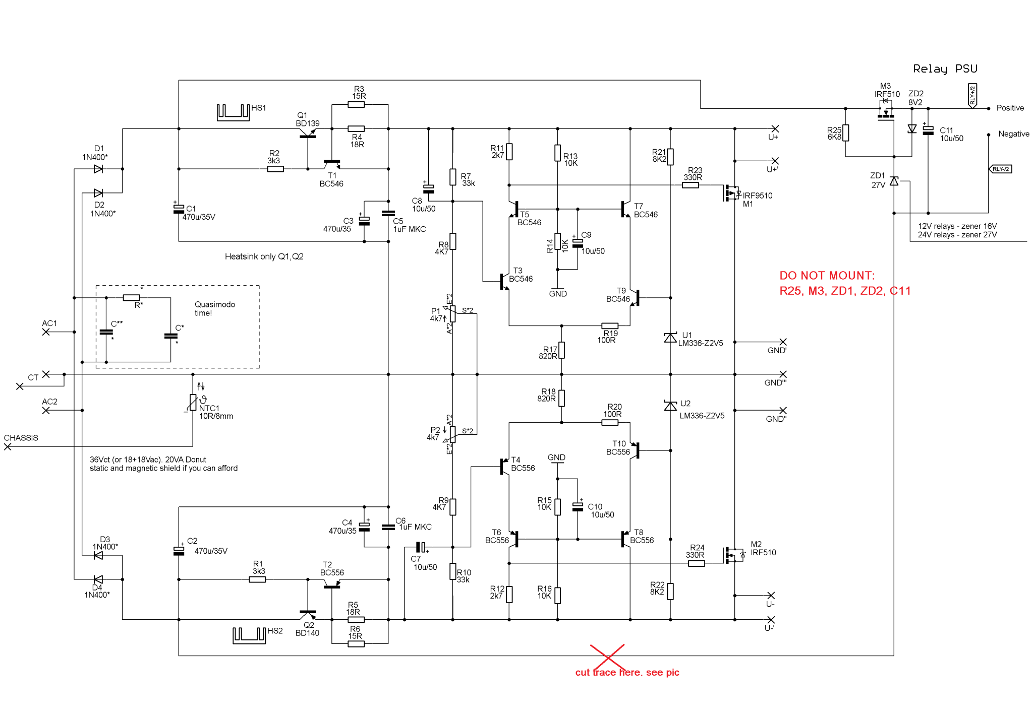

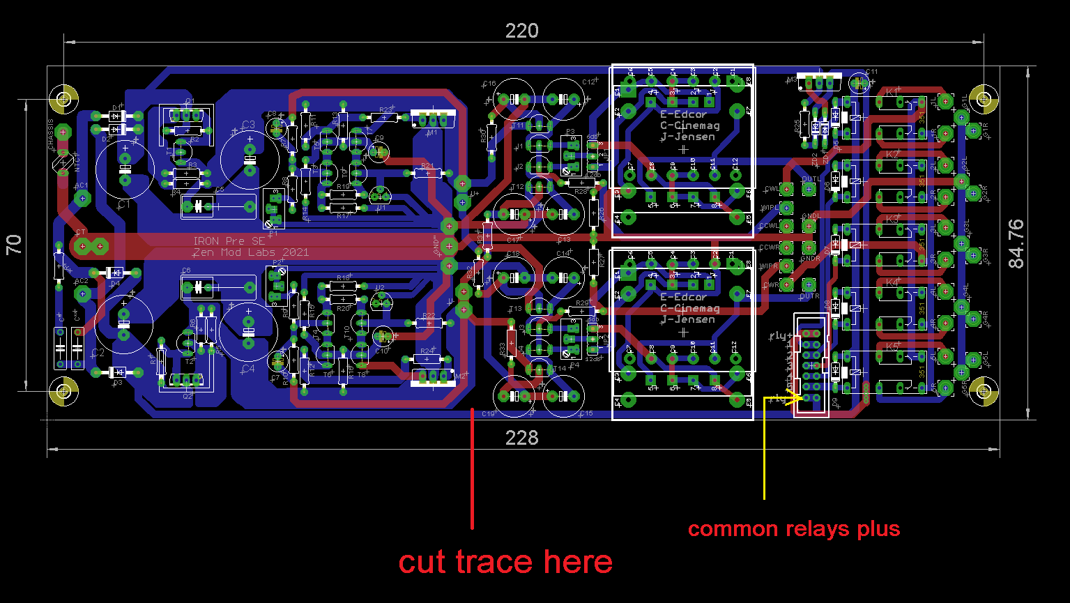

here it is:
(ZM shouting): HOW TO MAKE PRESENT GEN OF IRON PRE SE PCBS ADEQUATE FOR LOGIC BASED COMMANDS WITH RELAYS POSITIVE COMMON
everything is written on pics
you need to do everything written in red
resulting pins for common positive marked on IDC/flat cable connector
numbers 1-5 stay as they are, those being contacts which each of low side switches need to connect to relays PSU GND

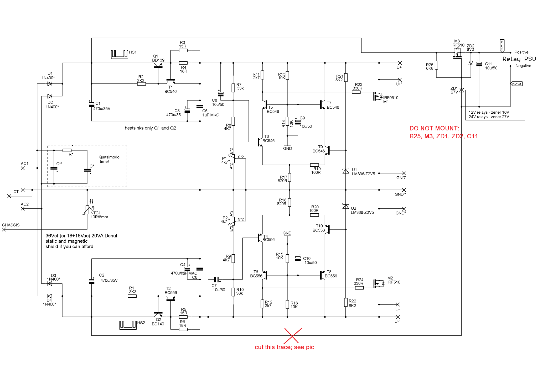

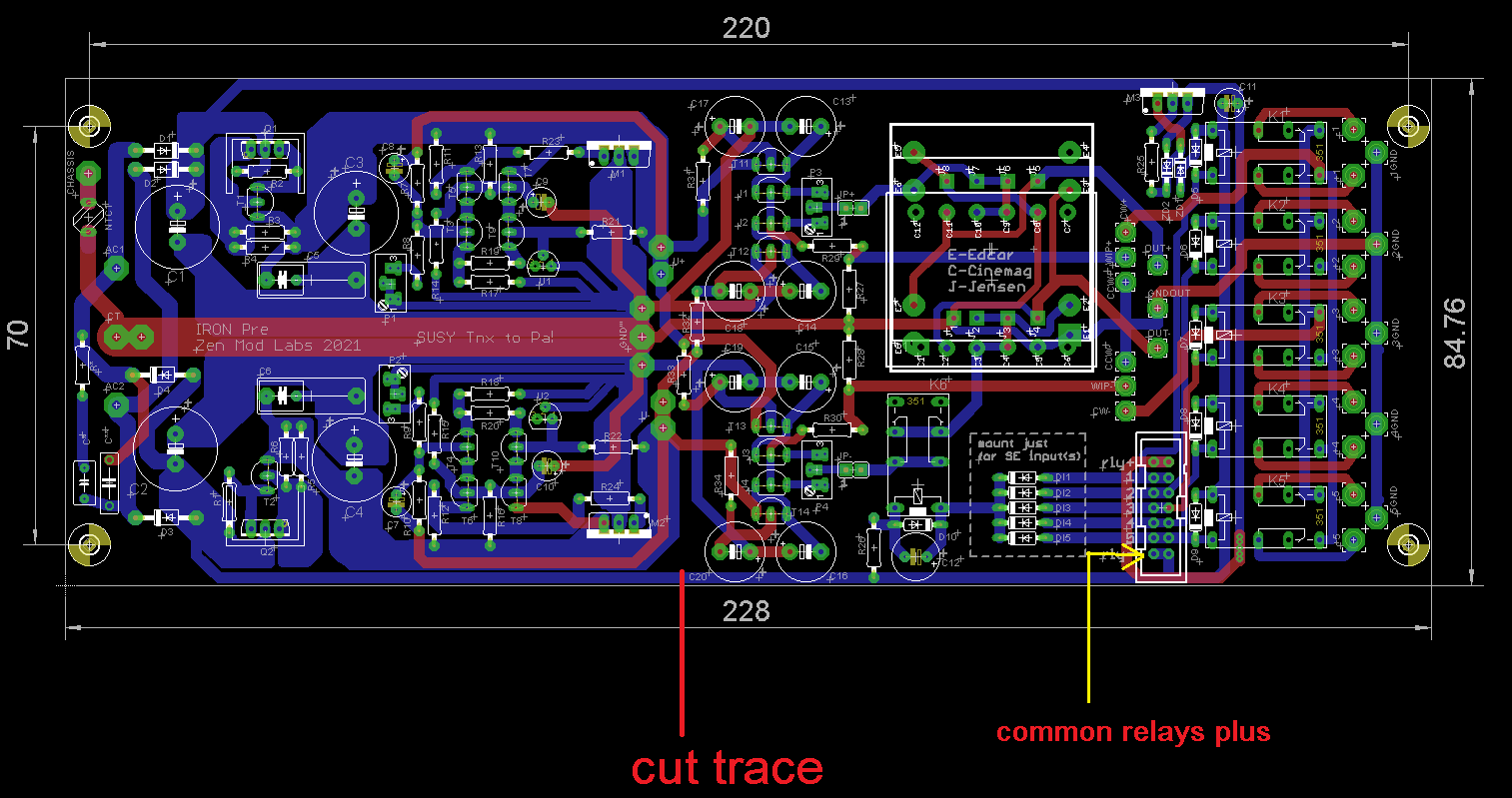

here it is:
(ZM shouting): HOW TO MAKE PRESENT GEN OF IRON PRE PCBS ADEQUATE FOR LOGIC BASED COMMANDS WITH RELAYS POSITIVE COMMON

That is kind of what I had figured. Further reduces what I need to collect to complete the build. Just resistors, caps, diodes, and relays. I already have a variety of resistors and diodes. Now to purchase.
