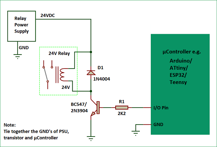

I've drawn a diagram of how I think the relays should be driven from a microcontroller's I/O pins. I'm also fairly comfortable now with using 24V relays as opposed to 5V relays.
Note that the relays should be powered by it's own PSU, and not the PSU of the Iron Pre.

It is more comfortable to use a Darlington array like ULN2003A in DIP16 package to controlling up to seven relais.
You don't need neither transistors nor suppression diodes. Any logic you like. It's easy, look here:

Thank you for that, @ACnotDC. It's exactly why we have this separate thread, so that members can contribute and we can all learn from it. I'm not familiar with ULN2003A, but I will certainly have a look at it.
By the way, the diode in my diagram above is not a suppression diode, it's a flyback or flywheel diode. It's standard practice to use it with relays and it's also in the schematic of the Iron Pre.

Don't belive all that chatGPT rambling, it hallucinates often, although in this case, the principle explained correctlyClamping diode = suppression diode = flyback diode = flywheel diode and so on... that's my understanding
Look at application schm posted at #336 in "Iron Pre Essentials Kits For The DIYA Store- Register Your Interest"
I'm using ULN2803, PDIP-18 case, TTL, 5 V CMOS
bought drekload of them for cheap.....
when using those, by datasheet, no need for diodes parallel to relay coil, each of 8 Darlingtons is having clamp diode to common
of course, which demands that common (positive) is also taken to ULN

At 2. it should be:
2. Relay Connection: a. Connect one end of the relay coil to the positive terminal of the 24V power supply. b. Connect the other end of the relay coil to one of the relay output pins (e.g., OUT1) of the ULN2003A.

I’m trying to compile a list of viable options for activating relays via typically 3.3V I/O pins of a microprocessor (Arduino, etc.)
So far in this thread, we’ve seen:
Transistors, eg. BC547, 2N3904
Darlington transistor arrays, eg. ULN2003A
What about logic level converters (shifter)? Anyone with experience of this? Keep in mind that we'd like to use 24V relays. Is it possible to shift that much?

A logic level converter would have been for shifting 5V to 3.3V for a micro that can't handle 5V on the I/O pins. But it was a misunderstanding on my part. It is not necessary in this application.
Yes, a separate relay power supply is needed. Power for the relays shouldn't come from the Iron Pre PSU.
