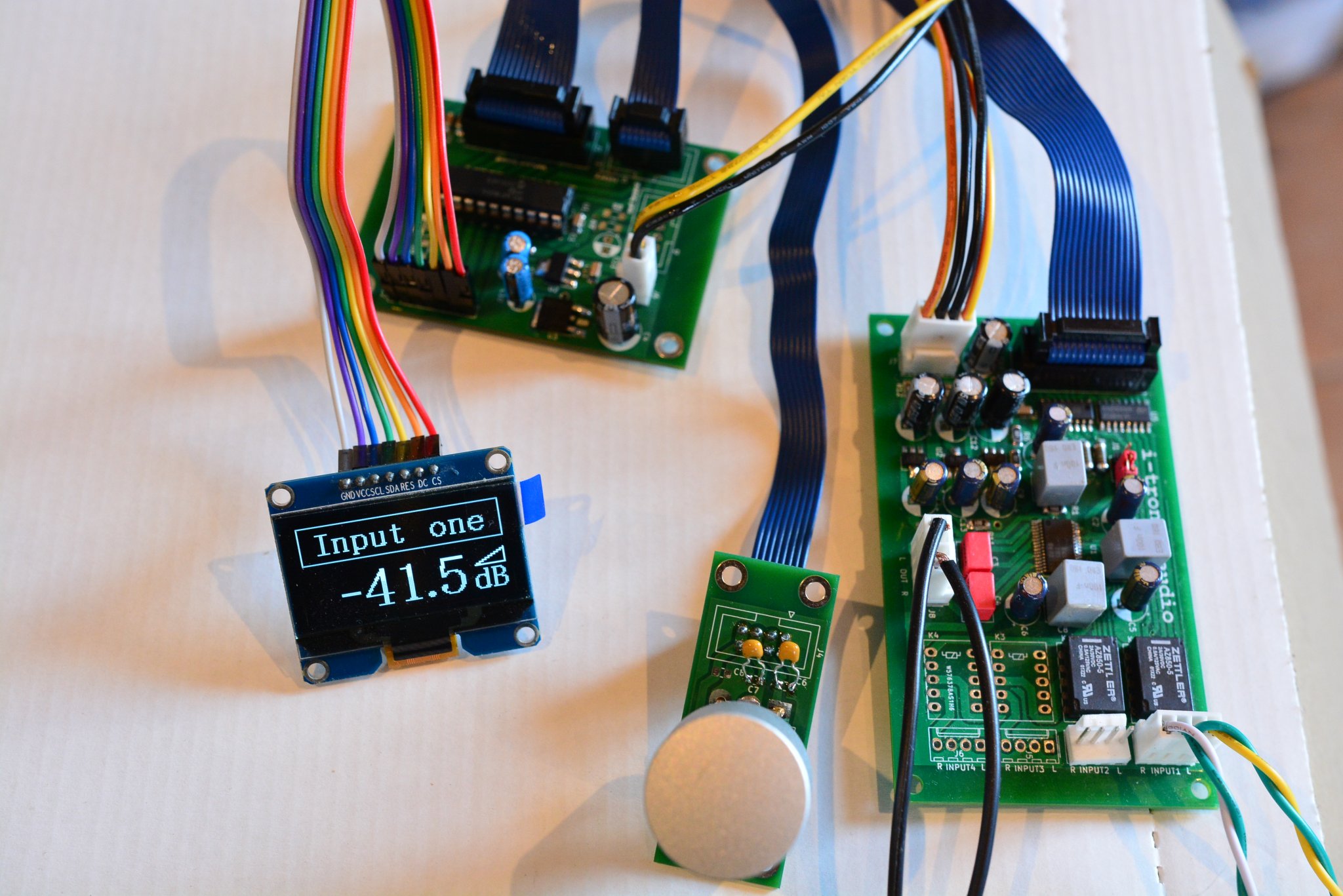

This is the kit that I built for my little ACP+ from PASS
Thank you for showing your Muses attenuator, lalaina. That is a very nice implementation. Well done! Using a Pic MCU. Interesting!
See my previous post about the Op Amp not being inside the Muses chip.
What do you mean by "isolated digital and analog section"? How did you achieve that?

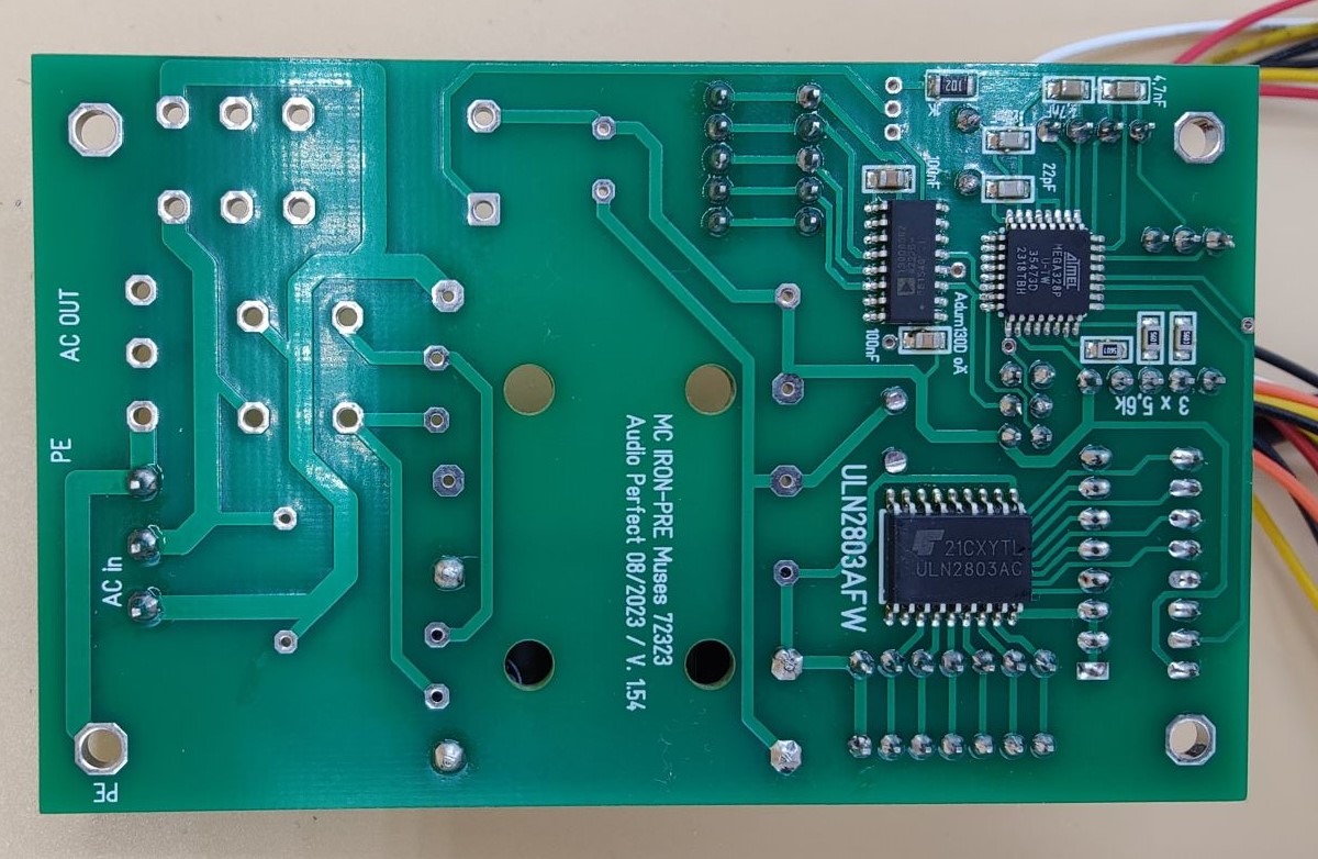

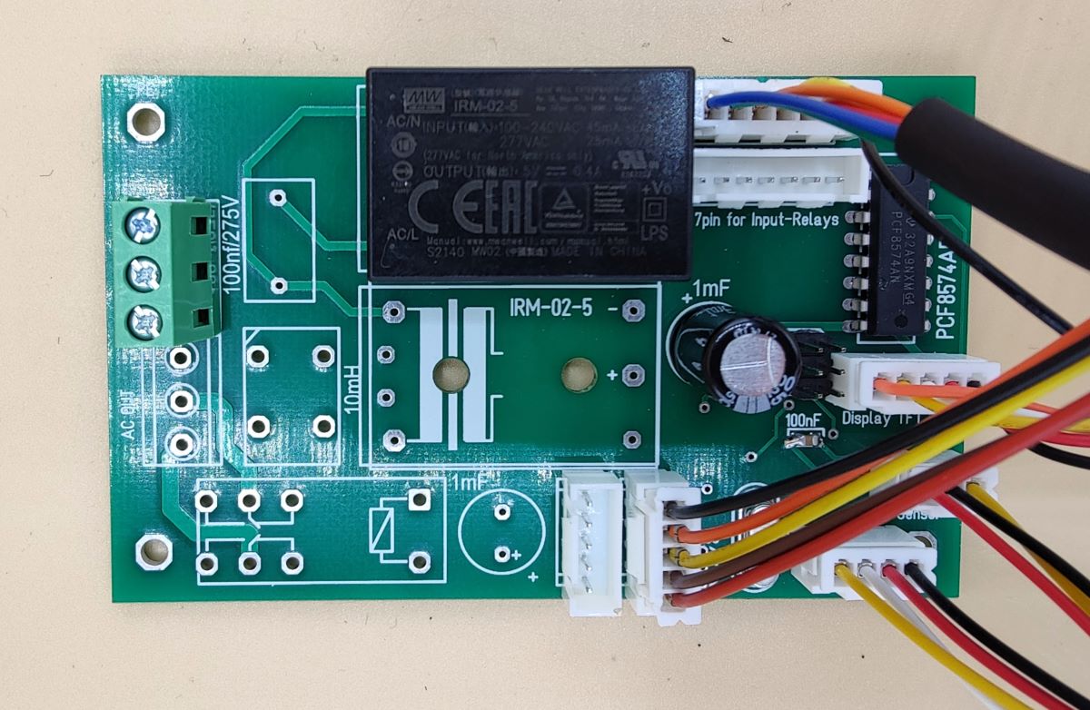

I am sorry that the development is dragging on like this. I actually thought I would be able to announce the completion of the project at the end of last week. Unfortunately, there were problems in the interaction with the port extension and the relay control. I often use this combination, but never had the problem that the ULN2803 could not be driven.
The problem is now solved. A few more resistors ensure the correct switching through.
Unfortunately, I had also forgotten the pull-up resistors for the I2C bus.
Additionally, I noticed that there might be a problem with gnd if the balanced solution were to be operated in double-mono setup. This would result in a merging of gnd of both power supplies at the digital isolator. Since this is not desirable, the only solution is a 2nd digital isolator.
I have now modified two circuit boards with which both solutions (balanced and unbalanced) can at least be tested.
However, I don't want to modify each board by hand before I put it into your hands.
I have already designed a new MC board. With it, all variants can be covered. I ordered the boards yesterday.
