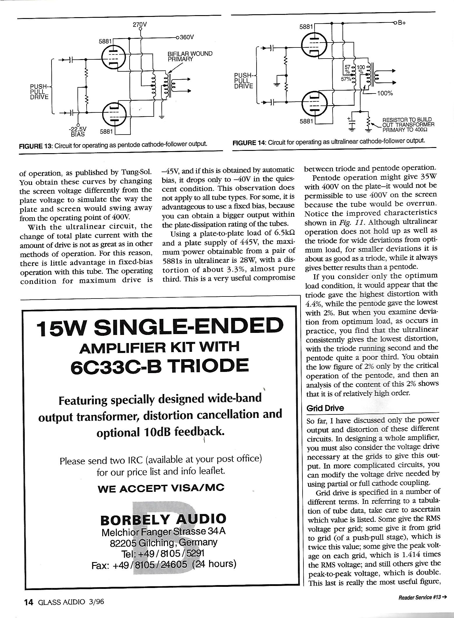

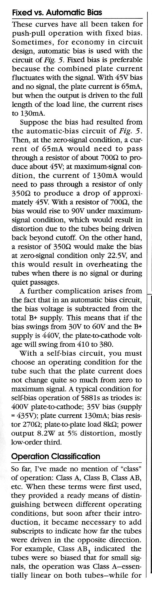

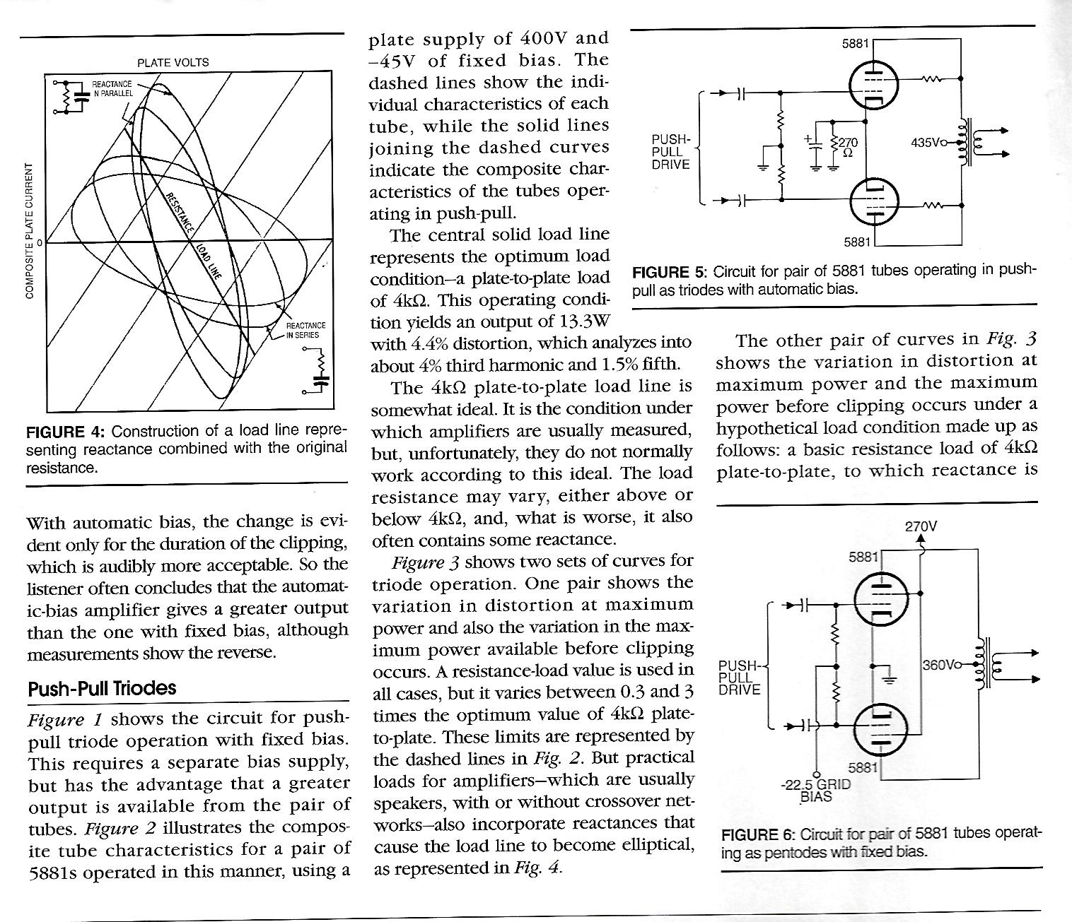

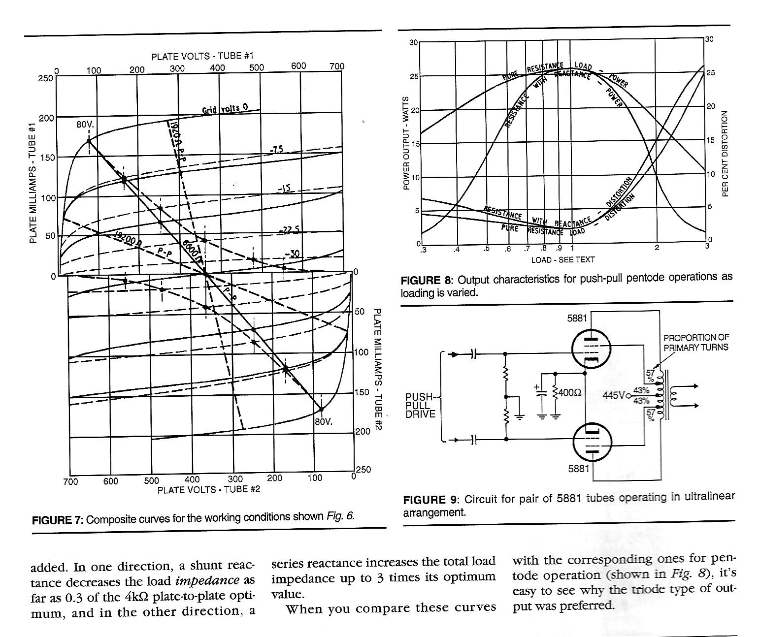

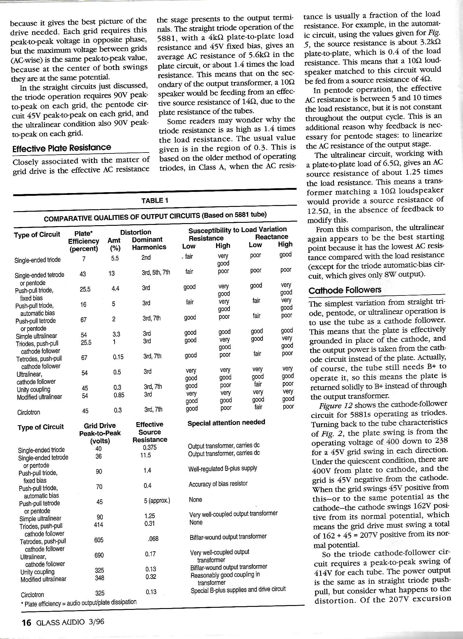

Norman Crowhurst covers all the popular NFB schemes used in the Power stage.🙂 This is a very good read.
The comparative qualities of the various ccts is given on p8.🙂

I don't see anything in Crowhurst's article that shows that Ultralinear is superior to pentode with voltage feedback to the control grid. What did you see in there that contradicts this?
...and I saw no other than UL feedbacks there. Just an attempt to prove that pentode mode for Cyrclortron is the best.
Well, the tetrode cathode follower, Unity-Coupled, and Circlotron are all pentodes with voltage feedback to the grid. They perform much better than UL but it really isn't a fair comparison to UL since there is so much feedback (50% - 100%). A fair comparison would be to construct a circuit with just enough plate-grid feedback to give the same amount of gain as the UL circuit.
I have no doubt that this would give less distortion than UL because you are applying the error correction to the electrode that gave rise to the error in the first place, not some other electrode with other characteristics.
Exactly. The name "Ultra Linear" is misleading and is responsible for it's undeserved popularity.

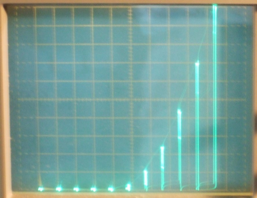

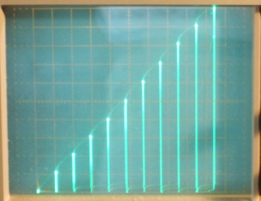

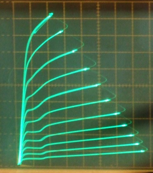

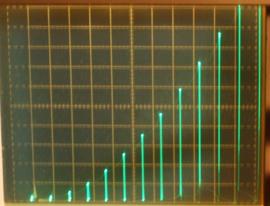

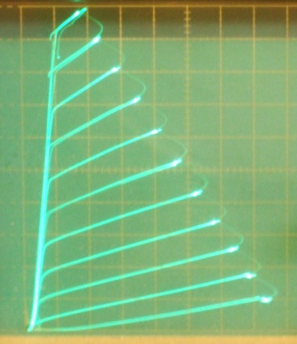

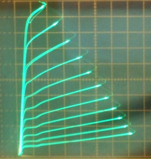

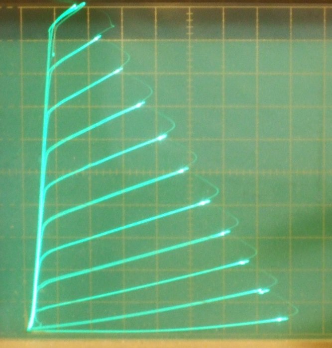

Here are some Vg1 to Ip curve traces for 26LX6 (50 mA per div Vert.)
a) grid 1 drive
b) Crazy drive (grid1 and grid2 special combo) (5.4 V steps)
c) 26LX6 low current end in Crazy Drive (10 mA per div Vert.) (showing low end for class aB overlap)
d) 36LW6 normal plate curves in Crazy drive (50 mA/div) (5 V steps)
e) 36LW6 plate curves for grid 1 drive
f) 26LX6 plate curves for grid 1 drive
g) 26LX6 plate curves for Crazy drive
Ultra linear, hmmm
a) grid 1 drive
Ultra linear, hmmm

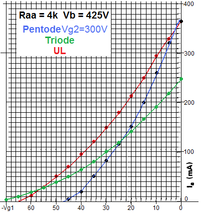

I just want to point out that in QUAD output stage in the Williamson and Walker paper, the cathode feedback stage also has negative feedback to the screen. So that paper is really comparing UL with UL+CFB. Neither of the output stages examined are Pentode/Tetrode+CFB. If you want to combine Pentode and CFB you have to keep the voltage between screen and cathode constant which requires extra effort in floating supplies or extra OT windings or special cases (like Unity-Coupled config).
To me UL is way superior to UL+CFB,
A great amount of UL is enough and GNF works a lot better to reduce any amplifier parts coloration, reducing GNF and using then CFB corrects only the output stage.
GNF reduces the output Z enough, with UL, so that the CFB is useless and there is no benefits from reducing the output Z more.
To me, with thd levels inaudible, UL was the clear winner over UL + CFB.
However I am curious about pentode + CFB, which will enable same gain levels with a decent amount of GNF.
In other words, the pentode higher gain, plus the CFB plus around same level of GNF is the highest gain, highest feedback solution.
Logically the higher gain, higher feedback levels should sound better, we will see.
Table 1 in the article refers to stability. this is where pentode is weak.
I am thinking about running the KT120 with a G2 at higher voltage than the anode... regulated.

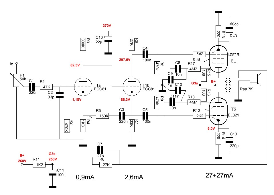

I have a question about shunt P-G feedback. Being my first try I found the LF tightened up. On the other hand midrange lost its charming character (like voices standing out from an orchestra). Is partial feedback possible by dropping simply some HF to ground with C9 and C10?
For a start the driver stage is not a balanced cct.😱 The impedance at the driver plate is ~27K while at the cathode much less. Without doing the math about One K.
The results of this modification will be minimal, to the plate NFB by eyeball is only ~1/174. And significantly less to the driver cathode. Surprising you managed to hear any difference at all using that hookup.
Morgan Jones in his book Valve amplifiers suggests using a 'build out' resister on the driver cathode side to equalize the drive. I had a look at that a few years ago & found it just another nuisance that got in the way.
To do this kind of NFB properly it needs to go to a balanced driver. And preferably pentodes. NFB to triode plates increases the drivers distortion.
All covered well in the old EE text books from the 40s & 50s.🙂
C3 & R5 form a +FB path, sometimes used to increase gain.Where did this cct originally come from??
