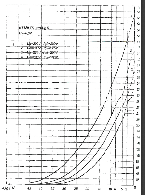

The screen voltage on a UL configured tube gets pulled down from B+ as the tube plate pulls down the plate winding. (auto transformer action at the 40% tap) It could end up almost 40% reduced when the plate is pulling down maximum strength (near clipping).
If you look at the alternate plate curves (versus grid 2 voltage) on many tube datasheets, you will see the maximum current the tube can draw reduces as grid 2 voltage reduces. When the tube needs the most current slam, UL cuts off the air supply. While pentode mode holds the screen V up at max current conditions.
This is OK as long as the design takes this into account. Somewhat reduced max power out for the same tube.
TV Sweep tubes take this to the opposite extreme, with a big cathode that can supply more current than the tube can rightly supply, without warming up the plate to a toasty red Tubelab glow if maintained.
UL is close to making the tube into an adjustable triode. (versus % tapping)
But triodes are well known for their difficulty in pulling the plate down to low voltages. (the electrons just aren't attracted to low voltage) On the other hand, many beam pentodes can pull down to 50 or 60 Volts (the "knee" voltage), and some can even get down to 30 V or so. (the steady grid2 V allows this)
Transistors/Mosfets can pull down to 0.1 V often. Inability to pull down the plate to low voltage means loss of power output (reduced voltage swing), and increased heating of the device. Schade gives you full pull-down to the tube knee voltage (due to screen V staying constant). But the penalty is more abrupt clipping.
UL by emulating a triode does indeed lower distortion over a bare pentode. Approaching that of a triode. It is just that most later tubes were designed with grid 1 optimized for best gm, rather than low distortion. Ie, grid1 is kept close to the cathode, causing some grid wire proximity effects. (leading to roughly square law V to I transfer) Grid 2 (or plate for triodes) is far enough away from the cathode to avoid grid wire proximity effects, leading to classical 3/2 power transfer. This mis-tracking of power laws between the grids causes the triode mode curves to have an obvious rollover appearance at higher plate voltages. Now the older DHT triodes typically had more spacing between grid 1 and cathode, giving a better tracking of grid 1 and grid 2 (or plate), so less rollover of the triode curves (which cause 2nd H dist mainly). UL would work wonders on an old DHP.

is it normal if a kt120 tube which was at 70ma, with CFB I changed the bias resistor to 1.5 ohm and now the readings are not right, indicating 0.380V which is 250 ma, makes no logic, maybe I went too low...
Changed from which value to 1.5 Ohm?
If it is a cathode bias resistor, it looks like 100 times lower than needed, depending on G2 voltage.
I did a mistake, wavebourn, now I fixed it.
The transformer is connected both UL and CFB, but it has a lot of 2n harmonics, I have no idea what is going on.
it is fixed bias, the 1.5R is only to take the current reading... looks like there is some problems the way I wired that transformer.
second harmonics are super high, like it is not working in PP... weird
If it is fixed bias, then the transformer winding in series with the cathode resistor can not increase idle current. It can decrease it, but absolutely insignificantly, due to DCR of the winding.
On 70 mA KT120 supposed to have pretty high second order harmonic. It is a push-pull tube for class AB amps. If you want it to run in more linear region, consider lowering G2 voltage.
