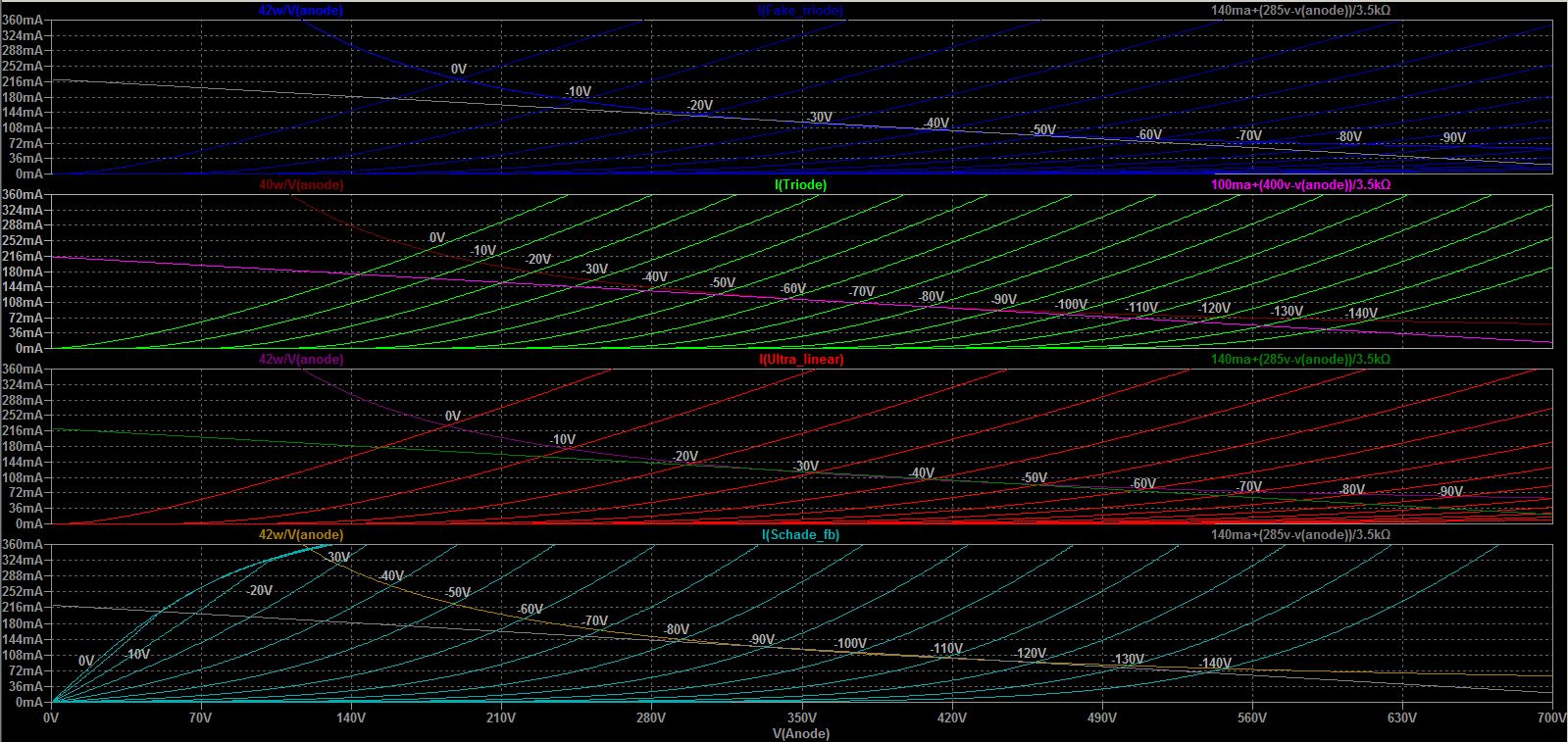

Did this yesterday out of pure boredom and was shocked at how easy you can make a KT88 to resemble a 300B.

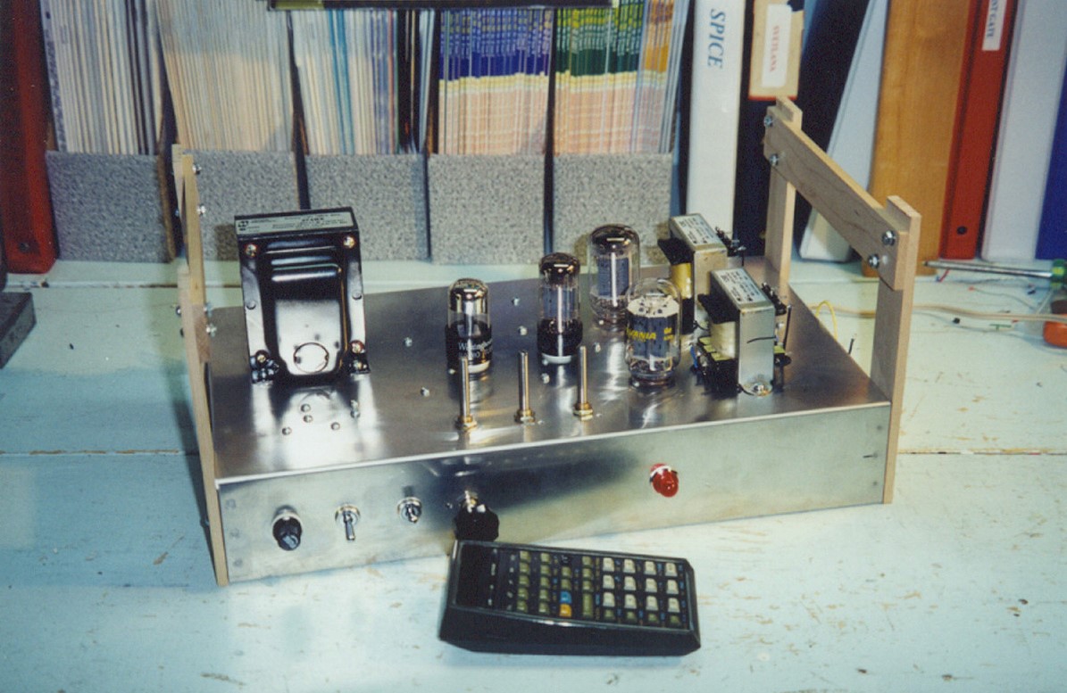

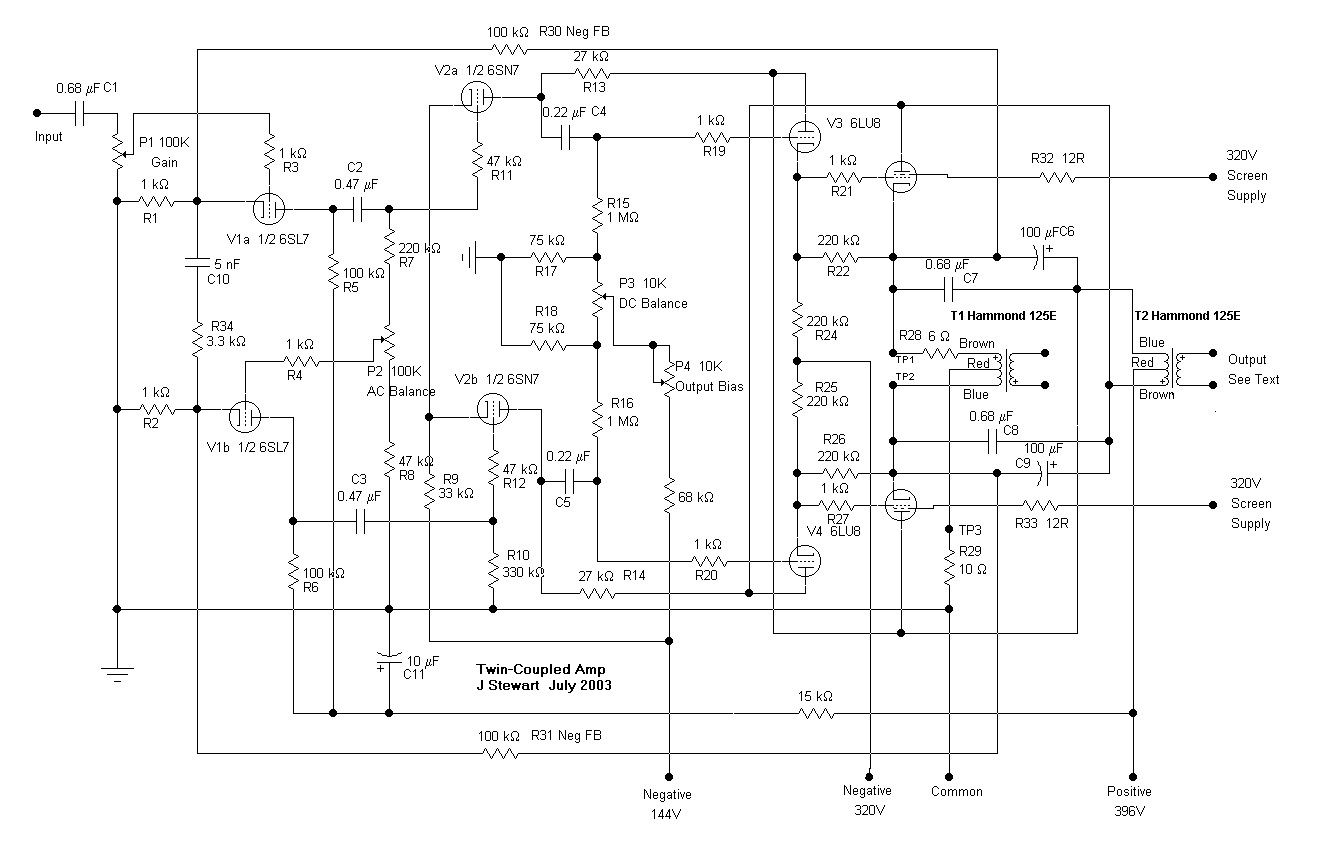

UL & CFB in One Amp
This project was published in AudioXpress magazine in 2005. It is based on Norman Crowhursts Twin Coupled Amplifiers which were published in the late 50's. In a way it is a poor man's McIntosh. But instead of the plate to cathode coupling taking place in the one very expensive OPT, Crowhurst used two OPTs, the coupling was done by paralleling their secondarys. He also used caps to be sure the higher frequencies were adequately connected.
For this project I went a couple of steps farther, both CFB & UL are used. The power tubes are 6LU8s, the included hi mu triode used as CFs to drive the 6LU8s power section to the limit at low distortion. All of the parts are 'off the shelf', no boutique at all.

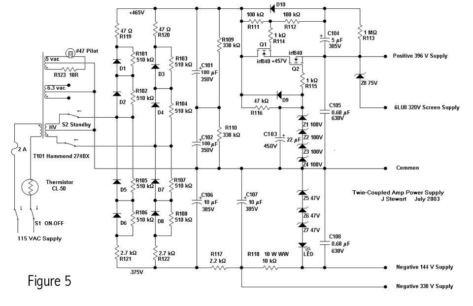

The B+ is supplied by a Zener controlled FET follower system with slow startup. The -ve supply is full wave right off the PT, set to the voltages required by Zeners. And a Current Limiting resister is on the line side of the supply.
The experimental chassis can be switched from Crowhursts input scheme to a full 2-stage differential. The full loop NFB can be switched on or off.
At clipping the power is 37 Watts. But could be easily scaled up.:cool:
Very cool. I built a Unity-Coupled amp with the Plitron transformers which are very expensive. I've always been fascinated by the Twin-Coupled design and was just thinking about it recently.
I was looking at Lundahl transformers which have four equal primary sections, the ends of which are all brought out to individual terminals. It seems like you could do something in between the Twin-Coupled and a true bifilar Unity-Coupled transformer with one of those. You could have the external capacitors to increase the capacitive coupling between the windings but have everything on one core and the transformer would be easy to source.
