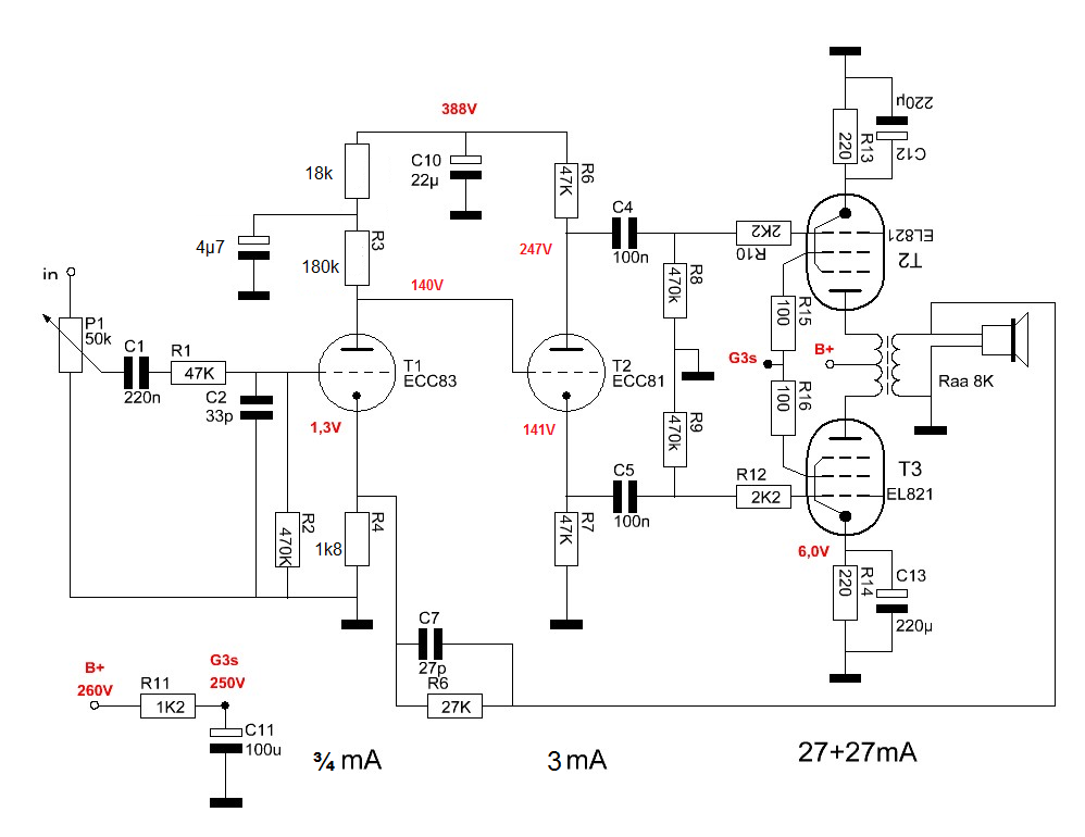

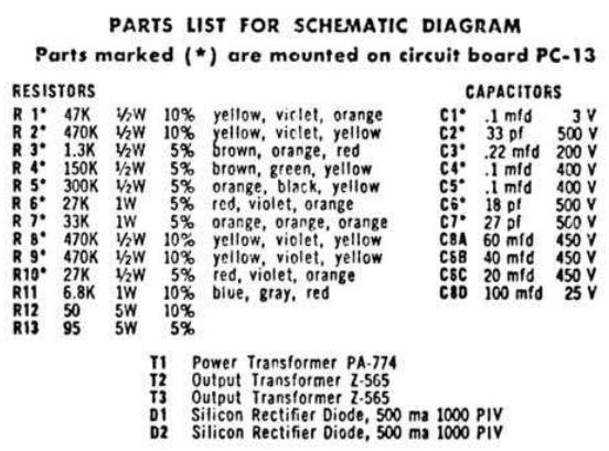

The 4M7 is driving into 470K in parallel with the preceding plate resister of 27K. As well as the plate of the triode. So actually less than 1/174.
At the other end the other 4M7 is driving into 470K in parallel with 33K & the very low R at the driver cathode. So almost no NFB at all.😱
The 150K driving back to the cathode of the other triode really is PFB. I & others often use it to get some gain.
Put your cct on the test bench try it for yourself. Do you have an AG & VM? Easty to do. No guessing required.🙂

The cct as shewn is not suitable for the kind of NFB you are proposing to use. The driver needs to be PP.🙂

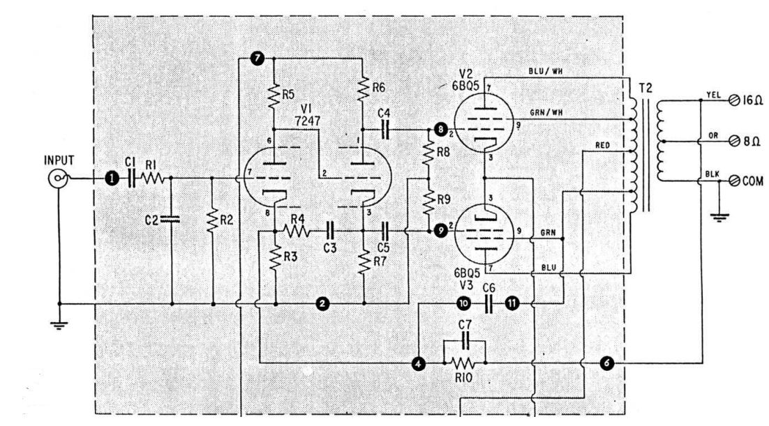

Both ccts are very ordinary aside from one of them using the dissimilar 7247 twin triode. Half each of AX7 & AU7, they never really caught on. I used one in an amp more than 50 yrs ago. It performed OK but nothing exceptional at all.🙂Today rather rare & expect to pay a premium.

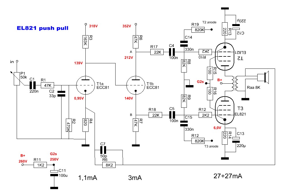

8 ohms. Works great btw, PG feedback. Authorotive, deep bass (on that hard to drive 2-way reflex, remember?). Highs could be better though, it tops off round 13KHz (by ears 😀) Serial resistance might be chosen a little high...
Had to experiment a little (Ketje was close, now it's spot on) with the T1 anode res as it sets the T2 stage. With tube life the operating point shifts so a current source might be called for.
The concertina is unity gain with equal output resistances (RL x ra) / (RL(u+2) + ra) = circa 273R per leg.

Circuit Modifications to EL821 Circuit, Comments
With the small local NFB modification you have made you have succeeded in converting an otherwise more than passable amplifier into a generator of some even order distortion (2nd, 4th, 6th,...). The OPT in your photo looks like quality, it will remove some of the problem you have inflicted upon the circuit.
The full loop NFB will reduce the problem even further, as it intended to do.
Experienced designers can see the problem without doing the math at all. Altho the output stage is balanced the driver is not. If the driver were replaced by a PP stage the problem as noted would disappear. But another problem shews up, triode D% increases as their load increases. Direct NFB to the previous plate increases loading, it is negative. Better to go to the previous stage cathode.
Designing an audio amplifier from the ground up is not a trivial exercise. And even more difficult without the proper tools, scope, Audio generator & so on. Your observation of the sound quality is subjective, others may not agree.
It seems to me that Kirchhoff might disagree. You seem hung up on the difference of calculated Zout at plate and cathode. I agree that if the load at the anode of the concertina were in some way unequal to the load at the cathode, there would be issues. But if you keep them exactly equal, the circuit constraints result in some cool behavior; mirrored outputs, which is what we want here.
Please set me straight here if I am wrong. I love to learn, but any type of imbalance here seems like it would break Kirchhoff's laws, which would shock me to say the least.
Edit: This is a debate that pops up here every few years and I've yet to see anyone prove with measurement or even sim that a concertina with balanced loads is somehow imbalanced due to the difference of Zout at plate and cathode.

The driver is balanced for output volts to the following stage so long as the impedance into which it drives is the same (grid resisters). Under ordinary conditions that holds true, altho at higher frequencies it falls apart. But at a frequency that does not cause a problem for audio.
In this case we see similar local short path NFB, but that is driving back into dissimilar impedances. The cathode output impednce is much lower than the plate output impedance for a split load phase invertor.
The result is the top output tube in the schema will get more NFB than the bottom tube.
So the top generator driving into the OPT has lower Z than the bottom tube.
And the OPT reacts to the unbalance & tries to fix it.
All fixed with a symmetrical driver. And the sun shines.

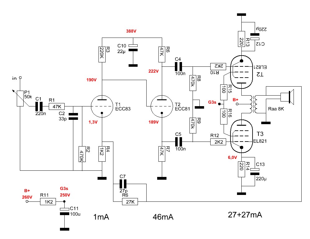

Out of curiousity, let's see what happens with shunt plate Fdbks to a Concertina triode splitter.
Let's say the input to the Concertina moves positive. This pulls the cathode driven output tube grid positive, which makes it's plate move negative. The negative delta back thru the Fdbk resistor to the Concertina cathode has little effect on the Concertina cathode V, but increases the current thru the Concertina to its plate. That pulls the Concertina plate negative, turning off the top output tube. Thus helping the bottom tube turn on. So net result there is positive Fdbk.
Now the top output tube would be turned off by the positive going input to the Concertina, and its plate would move positive. That positive delta back thru the top Fdbk resistor to the Concertina plate would pull the Concertina plate positive, producing Neg. Fdbk to the top output tube, as hoped. Not much passes back thru the Concertina in reverse if it is high mu.
So it would seem that these shunt Fdbks don't do anything for the bottom output tube,
and cancel out for the top output tube.
Result, NO Fdbk anywhere. A -Do Nothing- circuit, except it causes the Concertina gm to work harder, making a bit more distortion in the Concertina.
