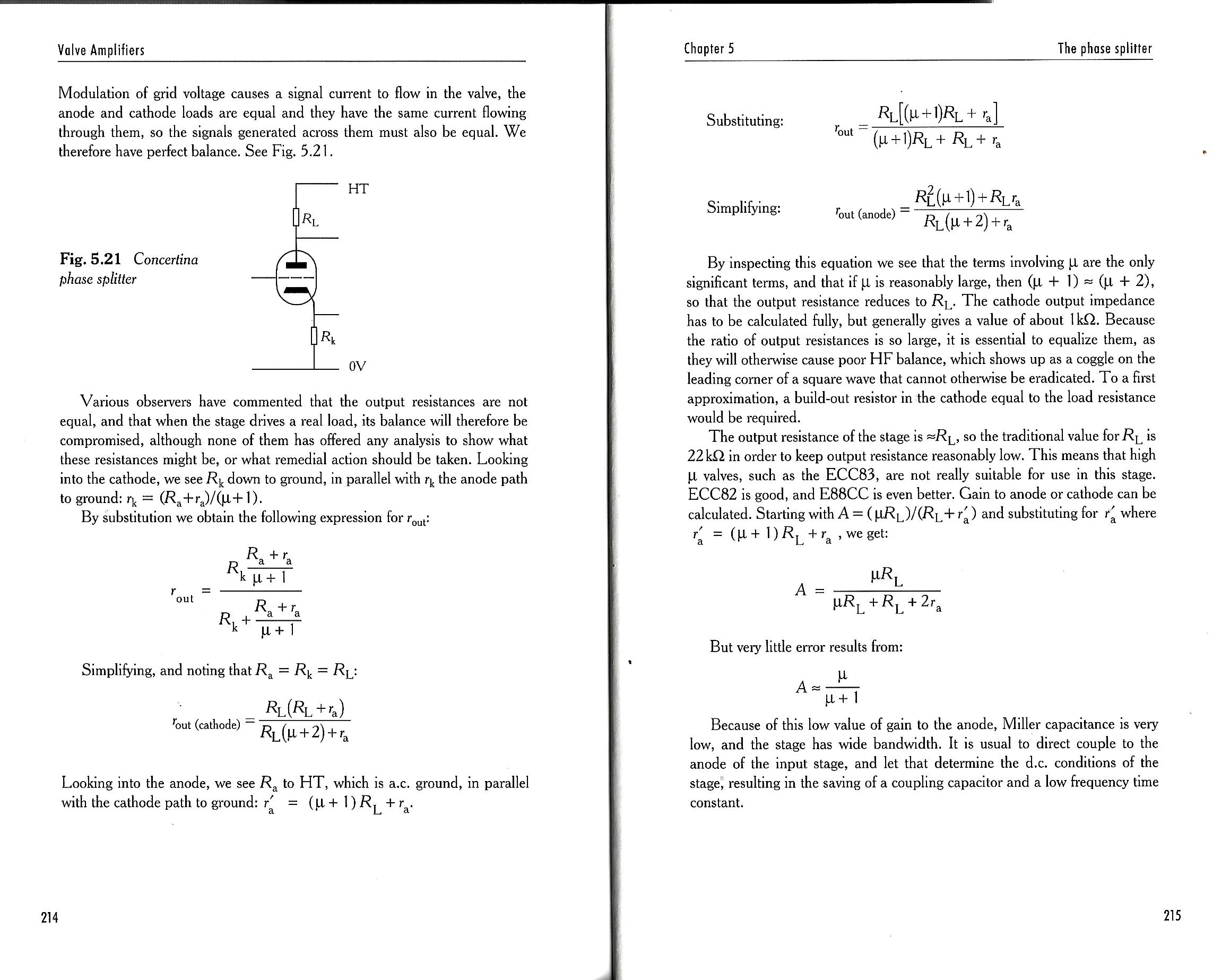

Morgan Jones Analyzes the Concertina
Here is the condition I noted when applying the kind of local NFB used in the amplifier in the thread. All well explained by Morgan Jones.
An excellent reference book for Newbies & the Not So New.:)

Right, my 4th edition concludes the analysis of the equally-loaded concertina stating, "Because Zk = Za, the frequency response at each output is forced to be the same, so the output resistances must also be equal, and rout(k) = rout(a)."
Of course, the caveat there is equal loading. Looking at the circuit in post #113, the output tube anodes have to mirror each other due to the coupling of windings in the transformer, so the voltages on the plate ends of the feedback resistors will always mirror one another, so will always present a load that is balanced at any instant in time to the cathodyne (through the caps and R17 and R18). The series resistors between cathodyne anode and cathode and output tube grids (R17 and R18) are likewise equal. Grid-to-ground resistors also equal. Cathodyne load resistors also equal.
The only thing I see that would make cathodyne cathode and anode AC loads unequal is imbalances in the output transformer, which are a problem in any circuit. What am I missing here?

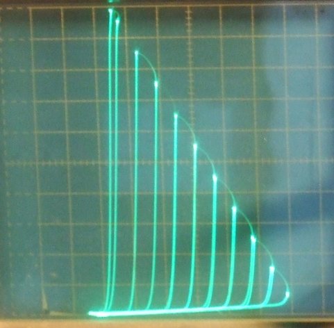

Look at the 6HB6 curves below. 1st pic is g2/g1 triode (like a real triode or UL mode), and the 2nd pic is shunt Schade. Same tube.
Those curves are stunning: equally spaced and almost vertical! What is the internal resistance of the tube in that configuration? Is there any reliable source for matched 6HB6s?
I believe the scaling on that Schaded 6HB6 curve set was 10 mA/div Vert. and 50V/div Horiz. giving approx 200 Ohm Ri.

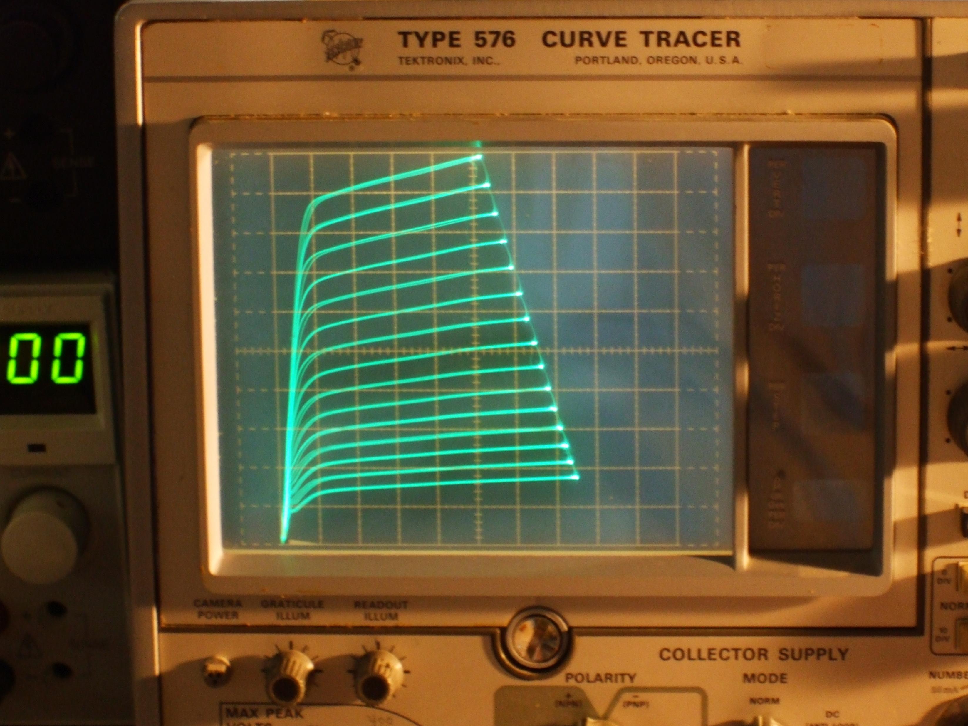

Another similar tube is the 12HL7, also a video tube with 21000 gm, and a frame grid. It was briefly on the old $1 TV list too, but disappeared quickly.
Another tube is the 9KC6 frame grid dual control tube. You have to put +10 to +13V on grid 3 to square up the pentode knees, but it forms a very nice 32,000 gm, 9 Watt pentode with that fix in place. Should give 125 Ohm Ri Schade curves. I'm not aware of anyone buying those up (odd heater V), yet. It was on the old $1 list, and sometimes available in quantity for $0.50. You won't find any matched ones. And 9KC6 are likely poorly uniform also. Frame grids being very touchy about precision alignment.

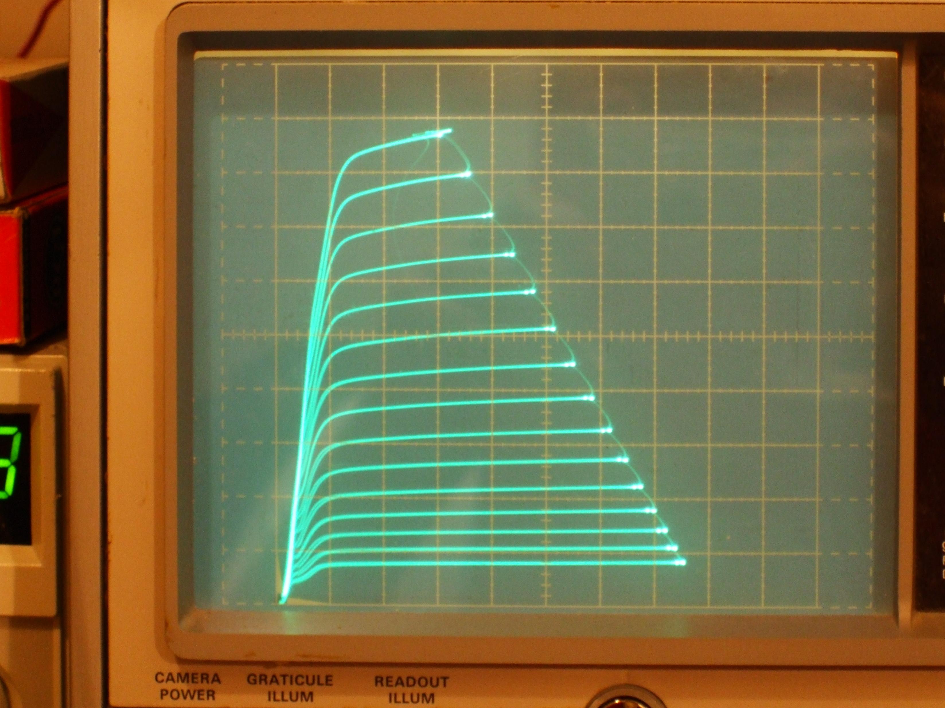

Finally, I would mention the 6197 (6CL6) video tube, at 11,000 gm, non frame grid. These are available on Ebay in quantity for less than a $1, and are quite uniform in characteristics in the boxed GE ones.

2) 9KC6 pentode +12V on grid 3, 10 mA/div
3) 6197 pentode 5 mA/div
