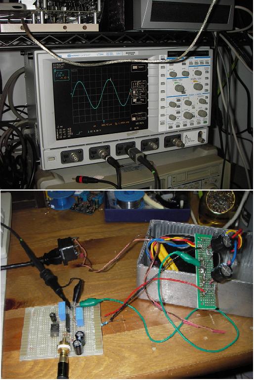

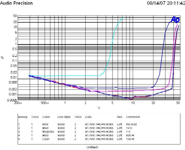

The Cc in the prototype is 22 pF. I then measured some curves using AP S1. The output residual noise is about 45 uVrms (BW = 22 kHz). Several THD vs output level curves are shown in the pdf file (note the input impedance of S1 is 100 kHz). My next step is to load the circuit similar to that of headphone amp.

Sorry Andrew. I should not do typing while measuring.

Why use 470 Ohm?
I think the test I recently did is similar to what you described. I tried different resistor at the output of Fig 3 with 1 kHz sine wave and +/- 60 V rails. With 600 Ohm load, the chip clips at about Vpeak = 28V. The current at this point is 47 mA. However, the chip clips at a much lower output for 100 Ohm.
Hi Panson,
starting from the left, I think you are showing us loadings of
100r, 600r, 1k0, 10k & open superimposed.
There is a big jump from 100r to 600r and again another big jump from 600r to 1k0.
It appears that the chip is much happier with the 1k0 load.
This would indicate a current gain of 300 is required to drive 8ohm speakers and about 600 to drive 4ohm speakers.
Neither of these gains are available from single BJT devices so it looks like a driver and output EF stage must follow the chip.
Alternatively a FET output stage could be implimented.

Hi Andrew,
Thanks for you comment on output drive capability!
For current-limited regulator, you proposed a shunt regulator? The chip's Iq is 11/13 mA. If the CCS is set at 50 mA, a shunt transistor will consume about 39 mA x 60 V = 2.34 W in idle mode. Will it be too much? How about a series regulator with current limit?
