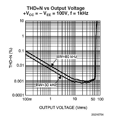

Also notice this graph from the LME49810 DS,
The standard (there is only one part) LM49810 easily surpasses the 4902C and equals (or betters under a real load) the 4902B.
When reading these data sheets always keep in mind, we are talking no load here. Add a load and the story will change dictated by the capability of the driver to adequately meet the demands of the load.

here's a comparison of the two driver chips -- they probably used 30kHz bw on their distortion analyzer.

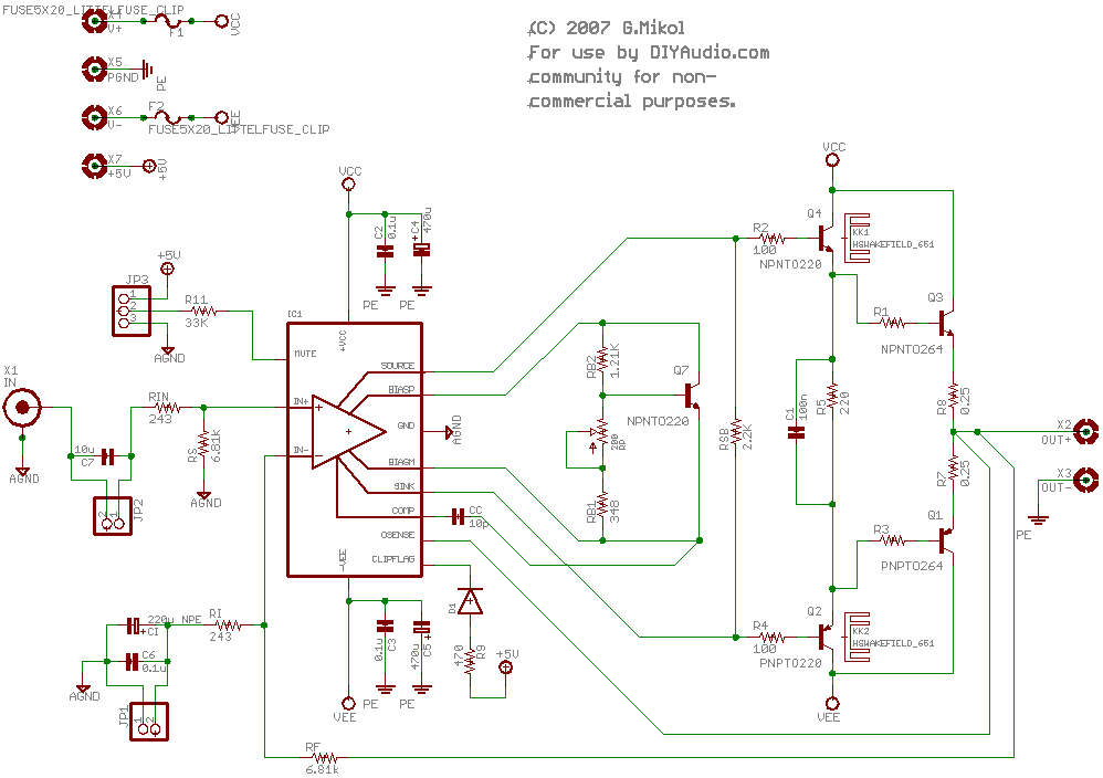

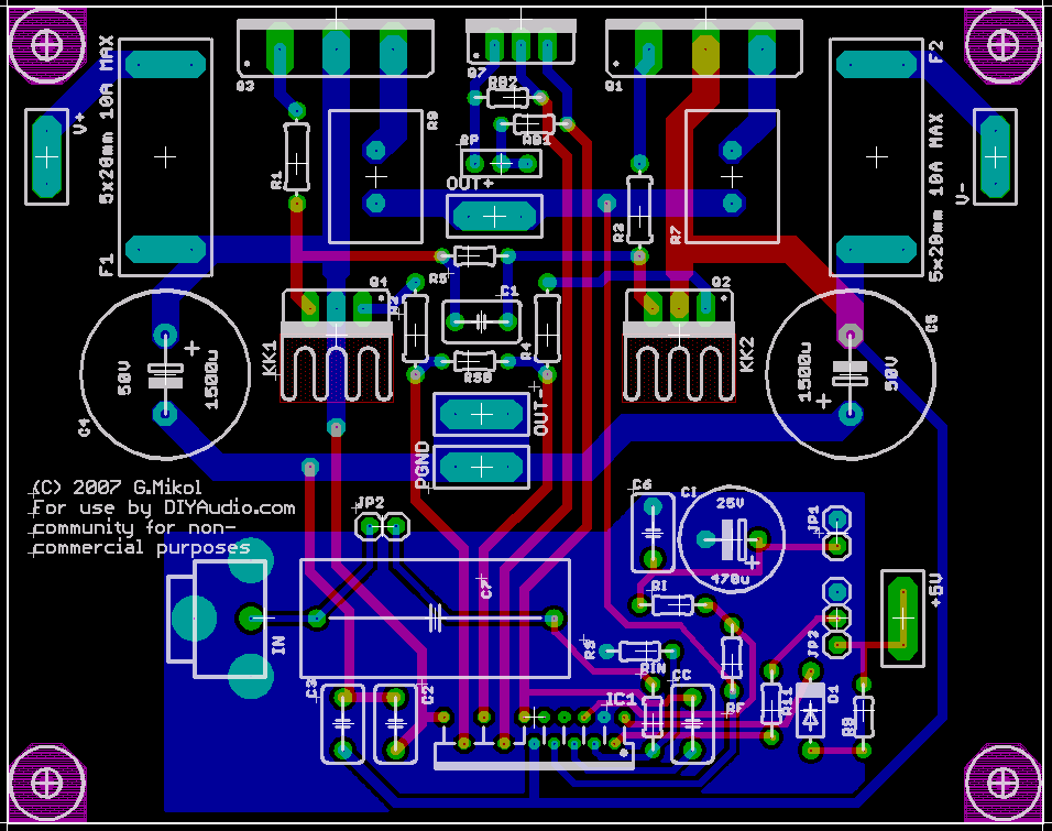

I hate to steal gcollier's thunder, but I was killing time and I came up with this board design (used my own symbol). It fits in the standard free Eagle 80x100mm footprint. What do y'all think? Be gentle on me, I'm pretty new at laying out boards. But I want to get better, so fire away.
I know there's one issue already, and that's the output sense line (the thin red line closest to KK2) runs parallel to the bias lines for quite some time, but I can't figure out how to fix that.
--Greg
Nice Work! I was laying out a board last night...but your design looks pretty darn good at first glance. Would you mind sharing the files so we can all have a go at it?
You hardly need the driver for this configuration. Since 50mA * 75 hFE(Min) = 3.75A, for MJL3281, good for 30V rails into 8 Ohms. This is about as hard as you'd want to push a single device anyway. But I laid it out as a demonstrator for doing larger output stages. If and when I get around to building any of this, I may try a driver-less single device output stage just for the heck of it.
I haven't shared any Eagle files before. Here's a .zip with the BRD and SCH files. Let me know if you need anything else.
--Greg

Thanks for the files they work perfectly fine for me 🙂

Hi Greg. According to your schematic you don't have AGND connected to PGND. You need to have them connected, preferably at one point.
Also, your 10uF input coupling caps with the 243ohm input resistors set the -3dB high pass frequency at 65Hz... That's pretty high and will be very audible. I would raise the values of the input and feedback resistors to get the -3dB frequency down around 10Hz or below so you don't have to increase the value of the coupling cap.
BWRX said:Hi Greg. According to your schematic you don't have AGND connected to PGND. You need to have them connected, preferably at one point.
The 10uf cap sees a resistance of around 7K to GND. A 10uf cap should be sufficient for that. But the Power GND and Signal GND does seem to be disconnected.
